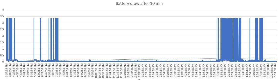

I'm fighting a parasitic battery drain on my car (again)
I went through all the usual troubleshooting steps, but my problem is slightly different: one module randomly turns on and off over time.
Below you see a chart of battery draw over ~18 hours.
As you can see the draw is not constant
I did several of these samples and one thing is always the same:
  • When it's dark outside I have an average draw of less than 20 mA (which it should be)
  • During the day it randomly jumps to 3.3 - 3.4 A for 20 - 30 seconds (it's always the same draw, so I think it must be the same module)
What module could be triggered to turn on only by daylight?
One more hint: sometimes I see the red LEDs on the two temperature adjusters blinking when the car is parked.

I am looking for some ideas how to find this parasitic drain
What I know that many times in a 24h period *something* in the car gets activated and then draws 3.3 - 3.4 Amp for 20-40 seconds.
Naturally this is very hard to troubleshoot
I tried some reverse engineering: I tested the current across each fuse using an "AmpHound" to see if there is anything that draws this kind of current.
And it turns out that the fuel pump draws exactly this current.
So I pulled the fuse for the fuel pump and did a long time test again, unfortunately I still have the same occasional parasitic draw.
And by now I'm pretty much out of ideas...

and i should probably add that me measuring the battery draw over 24h (see first post) was apparently a red herring.
I still have the same pattern but now the car still starts after 5 days (before the tele-aid module was pulled) the battery was dead on day #3
I also bought and installed an Antigravity Batteries AG-BTR-1 Battery Tracker, which allows me to check the battery voltage from remote, very convenient. (My car is parked on the street, it doesn't fit in the garage)
