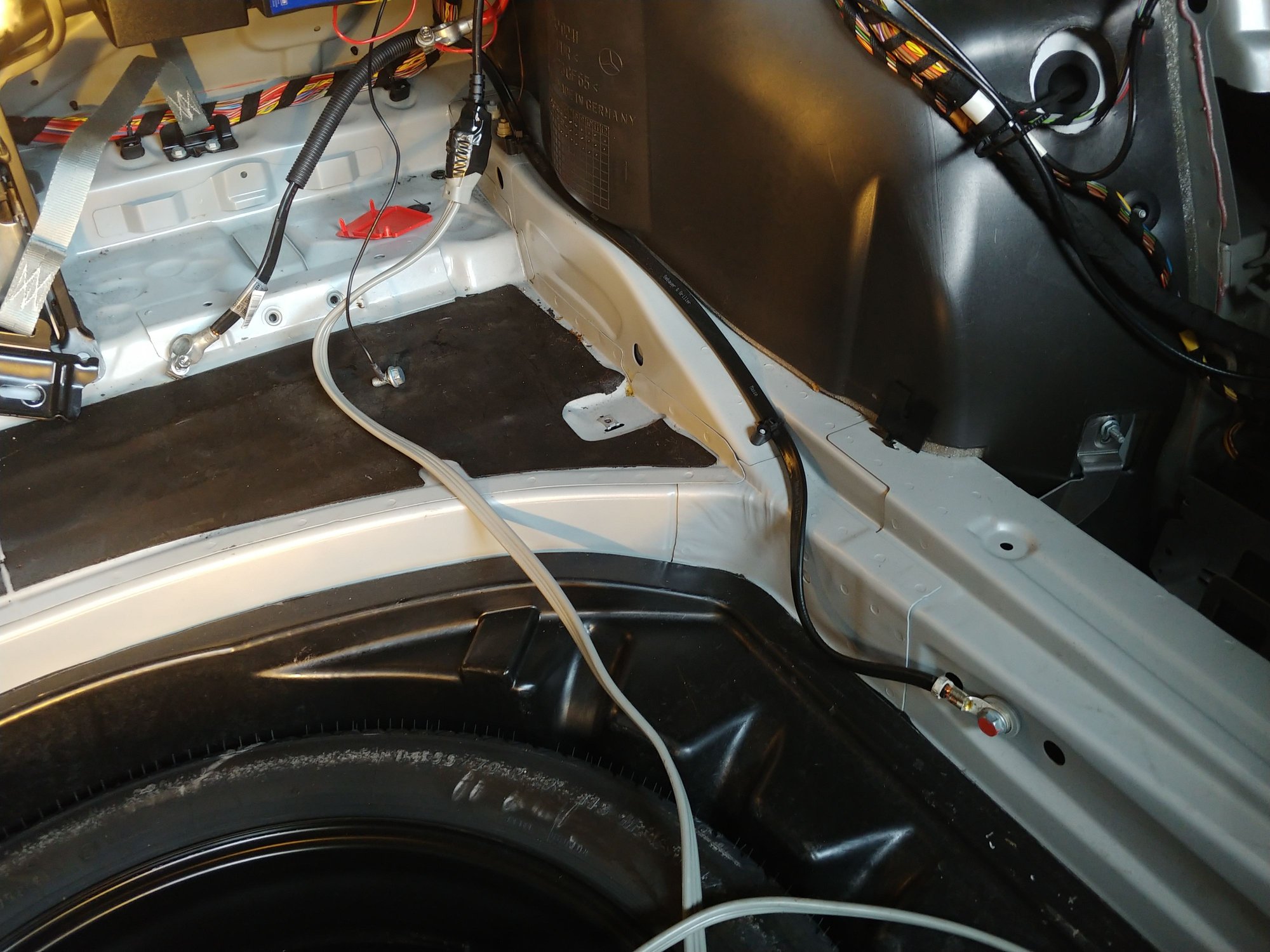

it will take 6 months to come back to almost as new.... you shouldn't rush the refill, tomorrow it will take as much as it did today (I did mention that) it will take 48 hours at 4 amps a few times over the next few month and still eat more once its capacity starts to come back
and just nip those bungs - little fekkers don't like to come out, I put a bit of silicone lube on the two O rings

electronic boffins say the earth on the charger shouldn't be back to the battery... a different earth better allows the charger to identify the usual car drain and do a better job managing its charging up
Re boot trim if the retaining bit that wasn't on mine at the bottom, nearest the battery has been snagged off the trim.... then aside from the floor trim this rear most section can be pulled and put back with ALL other trim in place … JUST watch up for the nasty metal brackets that hold up the top boot trim (by the sub) often get snagged on refit and bend out of shape by bad garages
That would be correct if there was anything on the ground side. But apparently there isn't on the rear battery.
Goes straight to body ground.
