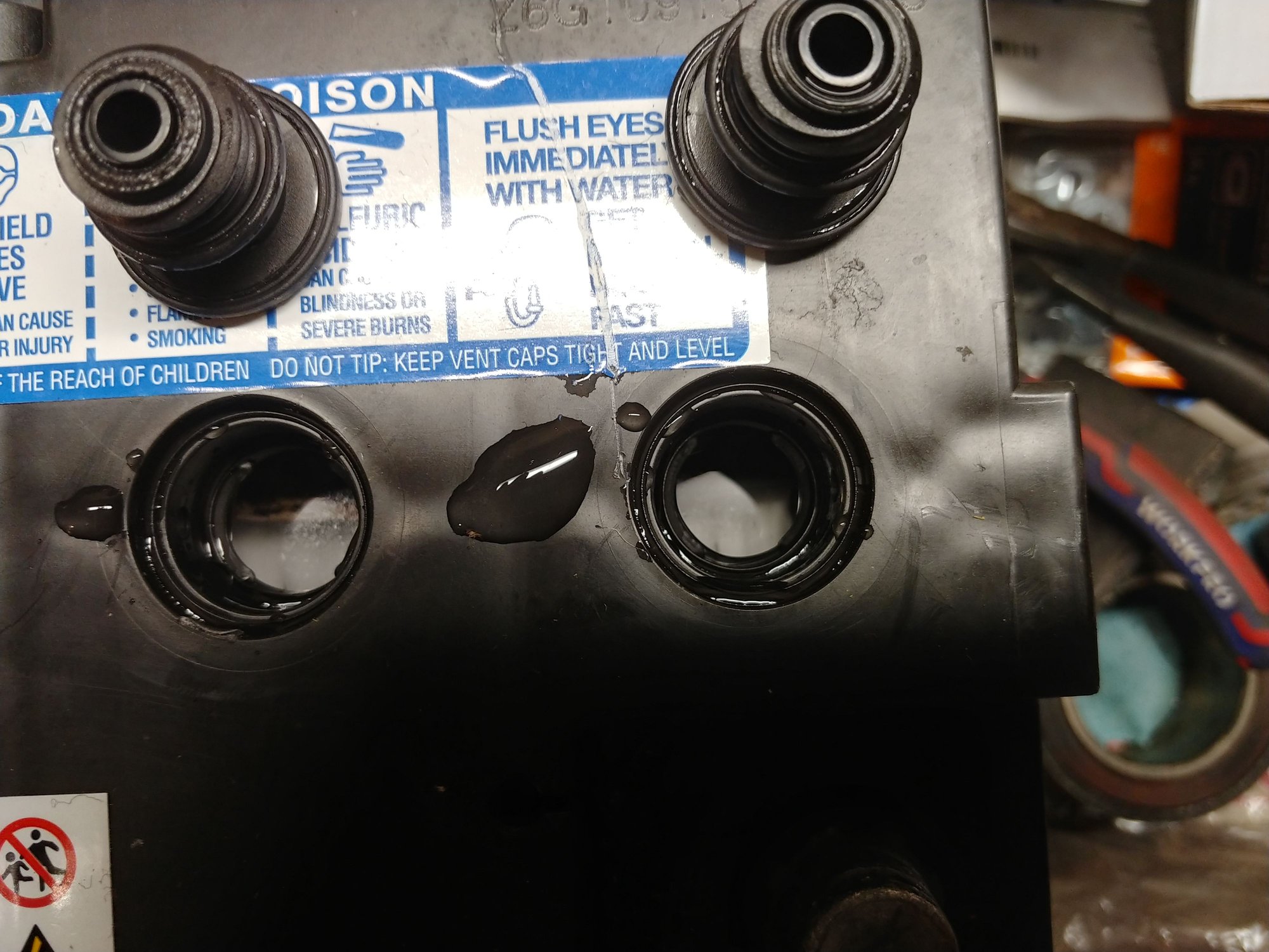

Thanks BOTUS for that top tip. Removed battery. This is in fact a Mercedes battery dated the 38th week of 2011 so my records were accurate from PO.

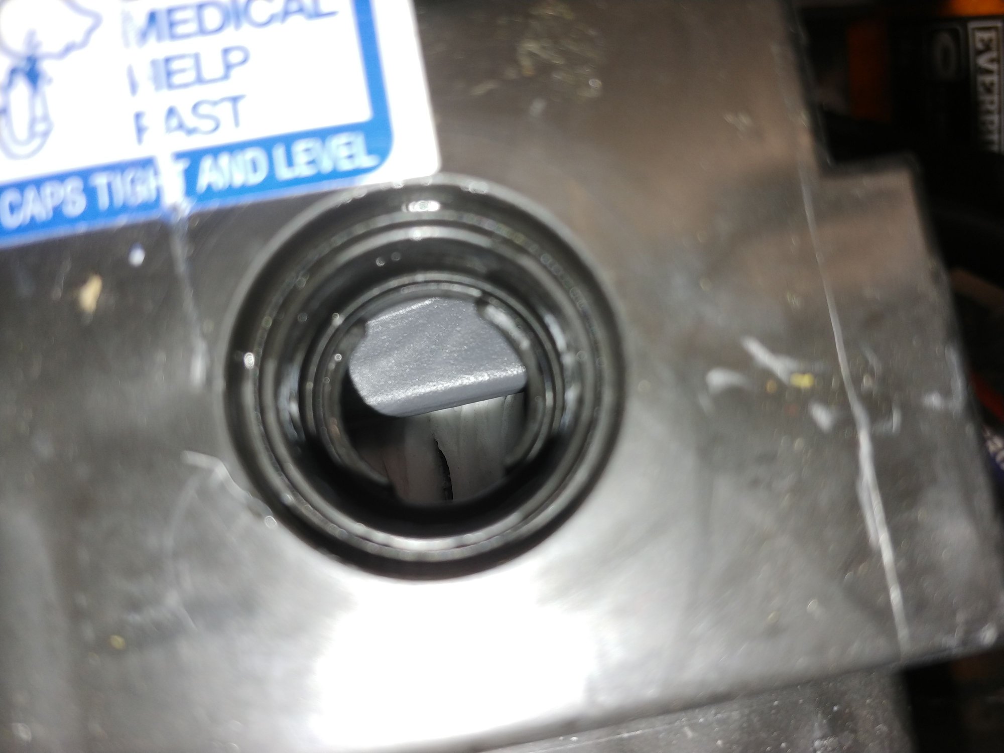

Fortunately the cell caps are exposed on these so I didn't have to mine for them. The most effective instrument to remove (they CLEARLY don't want anyone opening these after manufacture based on the one way cap ridges) was a snap ring plier, the 90 degree ones so you can mash it into the plastic with one hand and unscrew with the other. Worked pretty well actually.
Managed to remove back panel by bending it....will need to remove right side panel for reinstallation but I already did that. It was easy.

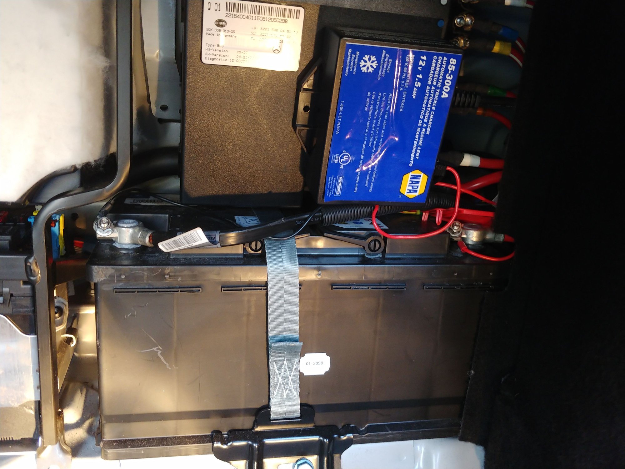

Oh, a Napa charger. Hope this is a multi-mode one and not just junk. Maybe this baked all the water out of the battery....
Says automatic but maybe I will remove, especially if I can find the plug for my Battery Tender.

Put down with one hand, loosen with the other. You will struggle with needle nose or something blunt like that.
Seems dry to me....

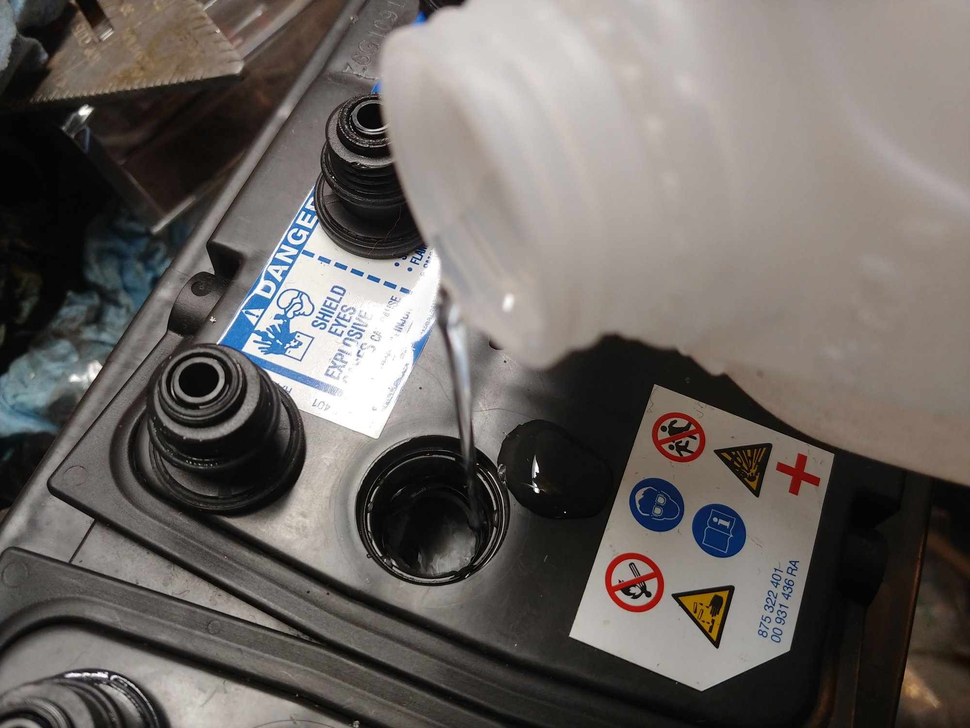

Adding the finest Bavarian spring water.
I may have added too much but I'm not sure that will hurt anything

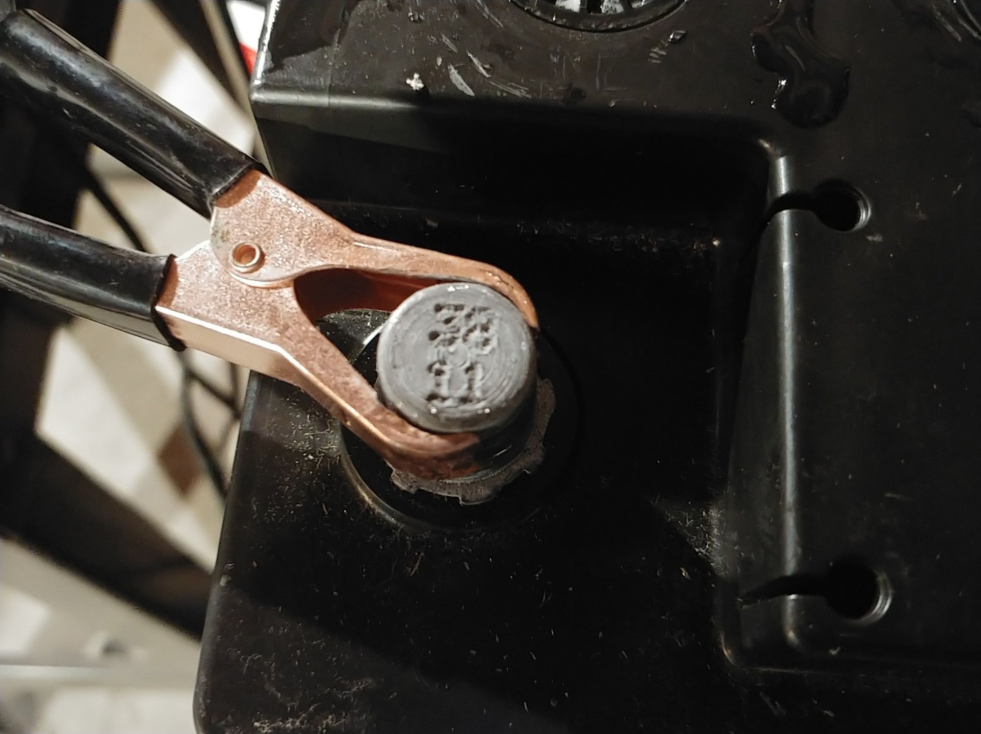

Date stamp on the terminal. That's cool.
On the charger. Curious how long it will take.
I'll report back with the results. I don't have a battery tester so my results will be how long I think it took to charge (if I pay attention), and then if the dome lights stop turning off prematurely. Best way to save $200 ever if it works!
