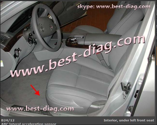

Anyone have an idea where sensor B24/12 (ABC suspension) is on a W221? Not sure if it is the same as the YAW sensor. It comes up as ABC Lateral Acceleration Sensor on a diagnostic.

Future reference: http://benz.ehost.tj/221/webetm/webe...rt_finder.html

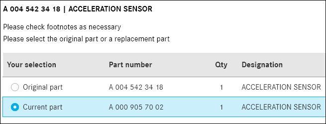

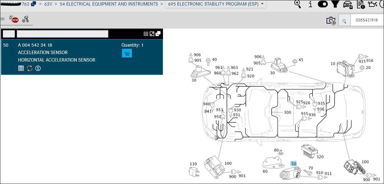

Do you know where I could find the part number for it without taking it out first?

Provide VIN.

Sent in DM.
File Type: pdf
