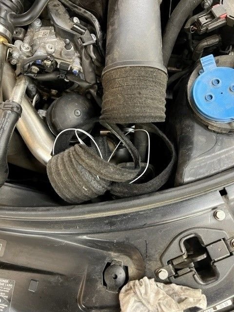

Those hoses are just terrible. Second set i get, and i find them sucked inside blocking air. I've searched and searched and can't seem to find anything aftermarket. Is there anything better, or has anyone custom fabbed something?

I just cut them off for now. They kept getting sucked in blocking the intake.

Just the hose with the plastic ends. I mean it wasn't quick, as you can tell they're not new. But once they start breaking apart just a bit, it's over, they get sucked in and they completely come apart.

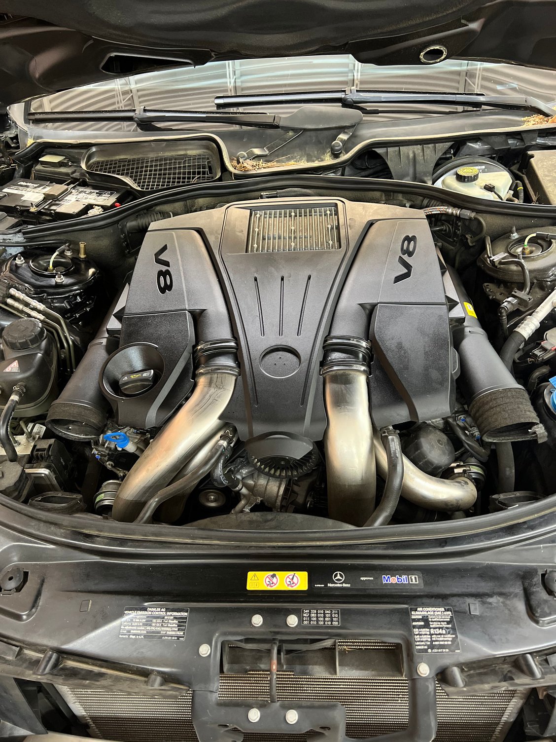

Here it is. Not the prettiest, but it works. Couldn't keep it together like in the video, had to expand the tubing due to the angle down.

Looks alright to me. Unless you go to car shows where people keep looking under your hood its fine. It does the job its designed for....to get cool air to the filter.
Good Job..
