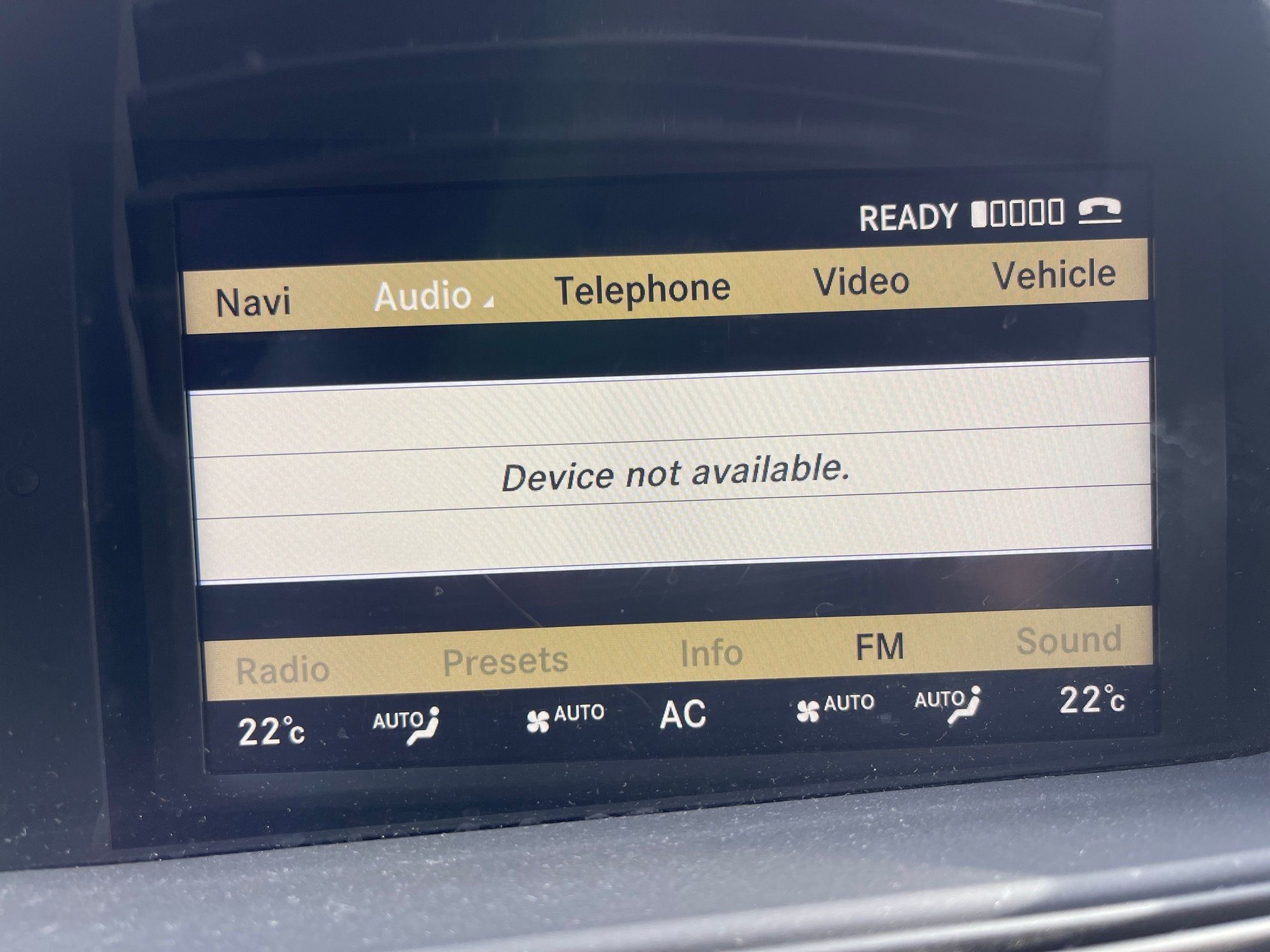

I have a 2013 S 550 with the rear entertainment package and swivel front screen. I don't drive it much, but a couple months ago I started getting this crackling sound from the radio. At first it was just a bit of loud static but the day I took the photo above it was extreme, started with some crackling here and there but intensified rapidly, it was so loud it sounded like it was going to blow my speakers out. Even turning off the ON/OFF button for the radio didn't stop it instantly. It seems to have killed the radio unit completely, as none of the radio channels work, including AM/FM/XM. Without A2DP I couldn't check if my phone worked, and I haven't bothered trying a CD or DVD to see if those channels are working.

It's the amplifier in the trunk that's dead.
You need that amp even if you go the carplay route.
There are some companies that fix these amps - google it.

all perfectly normal... the only interesting point - like many you show this photo of "not available"
the early cars using Comand NTG3.0 the Amp in the boot fails and you get no sound anywhere - but I've never had that message
the later cars running Comand NTG3.5 - either get a more useful message when the Amp dies - OR - another fault creates the message you get
the Amp needs to work regardless of your desire to fix a cheap wrong aspect ratio setup

Definitely the amp and you can get a new one on Ebay. There is an Infinity version and it is the same plug and play amp as Mercedes and is cheaper although it has one more input that you won't need to use. You can find research on the amp here in the forum.

Alvis, on the w221 the amp is a serious weakness they all die - regardless if its the small panasonic one that's std fit in europe or the harmon kardon bigger amp that was an option "upgrade" in europe or std fit in USA mkts -
the amp failure leaves everything on early cars operating normally but ALL sound from any source disappears - when in doubt switch to FM radio and if the screen works but all station names and numbers are missing its the amp thats dead - as not only does the boot mounted Amp make the sound, its the AM FM radio tuner integrated in there and the words / numbers go off screen - as per the picture in the first post it looks like when the amp dies on NTG3.5 cars, it displays a message that early cars didn't get
on the later NTG3.5 the comand hard drives die far more readily - and if you have the removable caddy version (NTG3.5), clone the drive and put the new one in - before merc tries to take 1200 out your wallet
on either comand versionl - other MOST fibre fun can be the USA sirius sat radio module that dies for fun, in europe people say the option DAB module also dies for fun - and the other one option, is the joke voice control module, these can also die - when ANY addon on module using the MOST system dies, it breaks the firbre circuit and everything stops....
Re Amp failure - the small panasonic amps don't have to die 100%, just get random and flaky (giving all symptoms list above) - mine first crackled and popped and lost sound on a long drive - but worked in the car mostly OK for 6 more months, then became progressively worse till I fitted a facelift amp that's still there working 10 years on - but the old one still operates if I want to play about for testing
