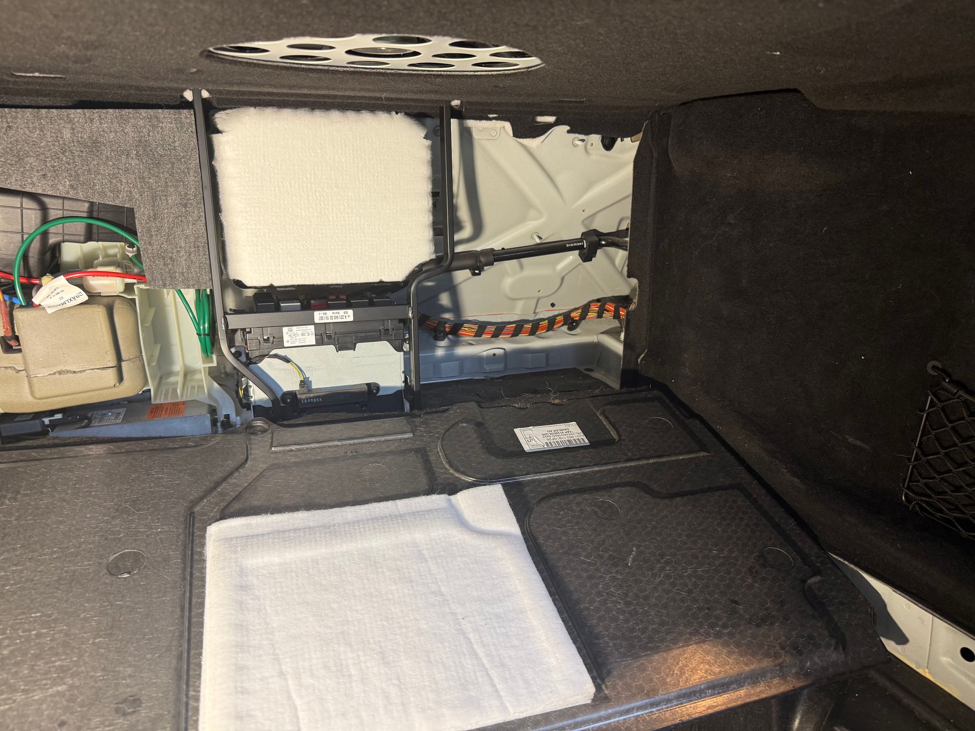

Hit a bump - esp now off.
codes out as a b24/15 yaw rate sensor failure (likely loose). I’m not at WIS right now and no specific location for this module in the w221 exists on the internet.
anyone know where it is?
cleared all errors and will see if it reappears.

in the boot on the floor near the rear SAM - they are always about this point on cars
more likely an ABS wheel speed sensor wire doing what they do - although that ought to get a speed sensor error - but they often start to die or fail in one hit after large bumps

My thoughts exactly - wheel speed sensors burning out and subsequent abs and esp malfunction has happened quite a few times in my x164 but that is a line item under ESP…the only fault under ESP was yaw rate sensor B15/25. No wheel speed implausible stored or current codes found. Thanks for the location .

The history points to the b24/15 connection being directly under the unsealed region of your trunk and got a good shower or two.

where I said
https://mbworld.org/forums/attachmen...990d1589826021

So opposite side. Coincidentally where the boot battery happens to live. So some bumbling shop monkey replaced the battery and knocked the sensor.

The 2010 doesn’t have a boot battery but I was just in there. Thanks for the WIS write up!

It seems as though we've circled back to my theory (:
That's what mine looks like too
