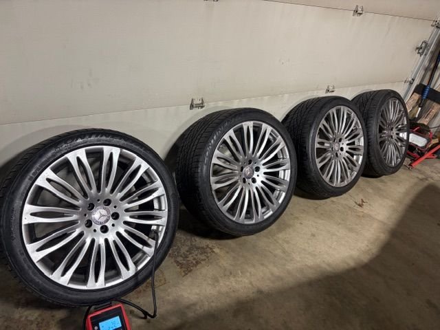

Hi. I found a set of w222 20" wheels local from a 560. I was going to grab them for spares as I was going to have my AMG wheels restored. Will the tire pressure sensors work with my '13 in these W222 wheels?

These wheels appear to be from a 15-18 S class. They are 8.5x20" and 9.5x20"
The tires are 245/40R20 and 275/35R20
Is this the correct staggered set up to not harm my 4-matic?

Front tires diameter: 245 x 0.40 x 2 + 20 x 25.4 = 704.0 mm
Rear tires diameter: 275 x 0.35 x 2 + 20 x 25.4 = 700.5mm
704.0 / 700.5 = 1.005
You are perfectly fine with this setup, other than in my opinion it is UGLY. There needs to be more rubber on the rim in my opinion... But that's just me...

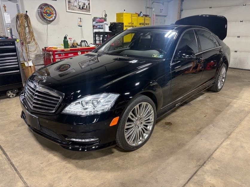

I put them on to get my AMG wheels repaired this month. Smooth ride, no issues...perfect for $500 marketplace find!
They look a lot better installed than by themselves. Looks like there is enough rubber on the rims.
The only thing is that it makes people think the driver wears a Top Hat😂
