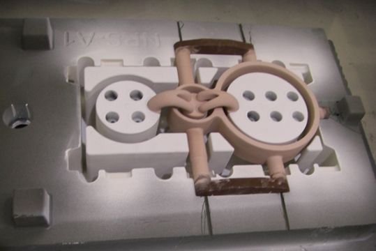

the BOLD bit above is a huge bug bear of mine - it makes me cringe every time I hear that hideous mistake
ENGINES DON'T HAVE FREEZE PLUGS - that is some other side of the pond madness you guys believe
what most cast engine blocks have, is Core Plugs - these have nothing whatsoever to do with frost protection - it is merely an element of the casting process - this is the access hole that held the "core" in place that allowed the creation of the oil and water passages - once the block is cast - they machine a neat hole and smash in a cheap steel bung to stop the coolant pouring out
yes if the coolant freezes it can pop the core plugs out - but that is called severe damage not a protection process - how can a small bung held in mostly by luck compensate for the forces of frozen water destroying the delicate engine block - it can't and never did
the pink sand bit is what creates the need for "CORE PLUGS"

BOTUS you are right on the money.
If one has popped a core plug out; expect a disaster.

Call them what you wish. I removed one from my tractor's engine block and installed a block heater in its place. Merely because these orifices are artifacts of the engine block casting process doesn't mean they can't or don't serve a subsequent purpose. If they were never intended to be removed they'd be brazed permanently into place.
