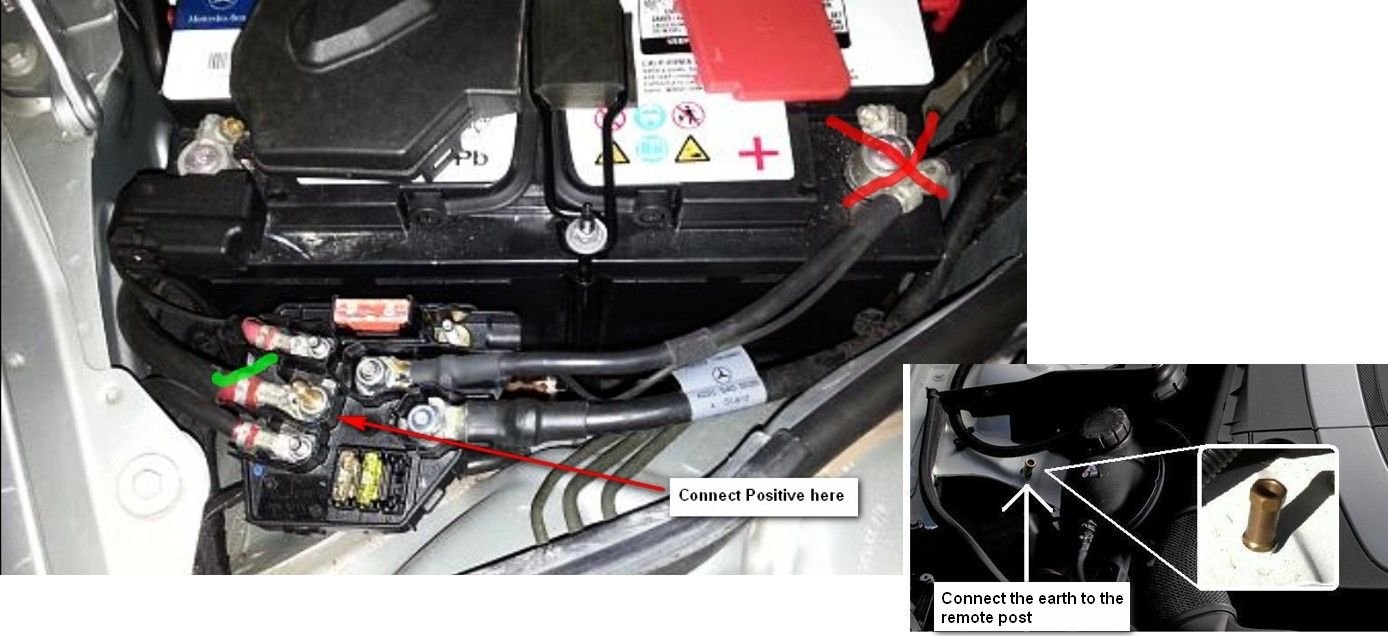

Are you jumping the small battery under the hood or the big one in the trunk?
To start it, you should only jump the small one under the hood.

check pictures to determine what set up your car has
twin battery cars have a monster 23kg battery hidden at the back of the boot
later single battery cars...
