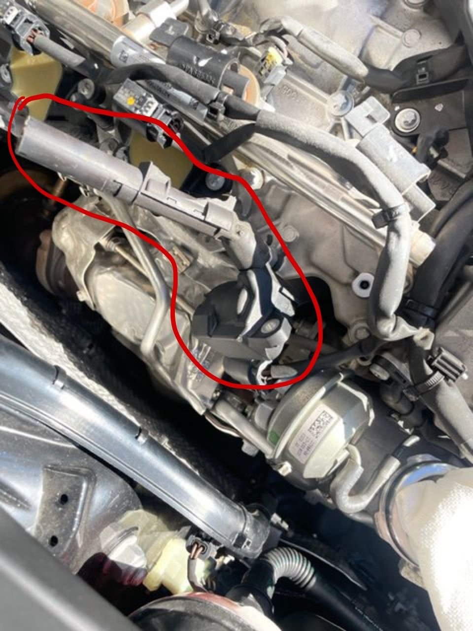

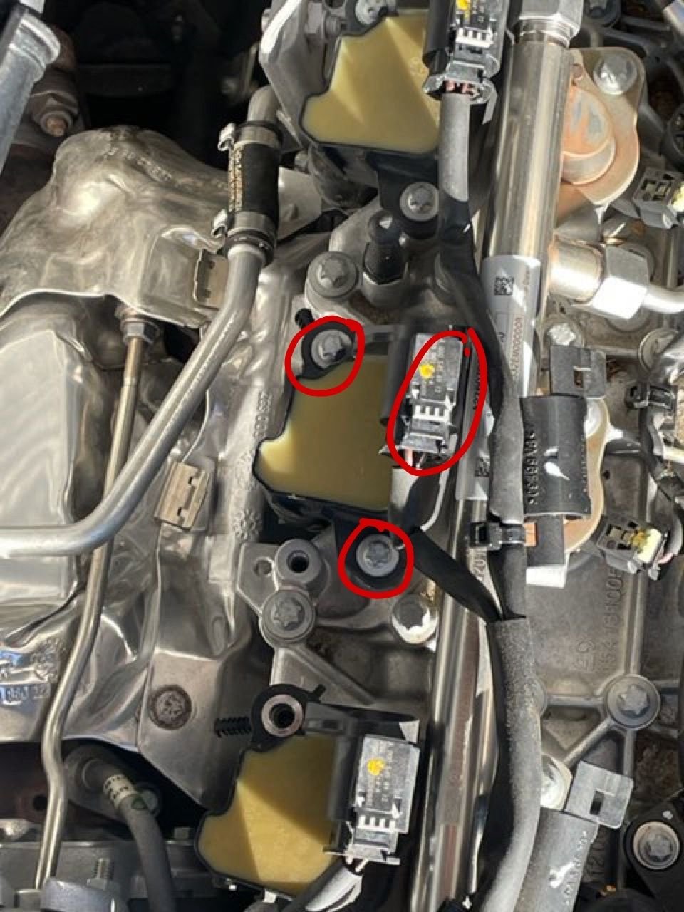

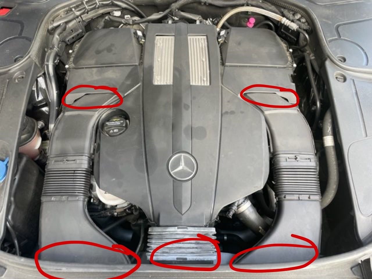

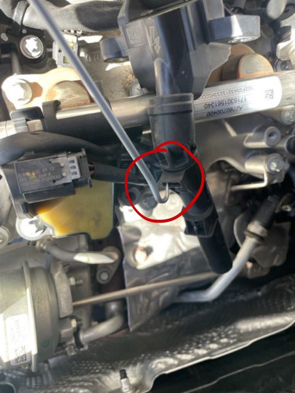

Finally figured out how to change the plugs in my S450. Used this video and uploaded some tips that I learnt. https://m.youtube.com/watch?v=tr809WBGb88. The S450 engine appears to be like the E400.
Detach air flow pipes at the marked spots. Unscrew the screws on the air filter housing both sides. Pull the two tops off and lay them in the center with the cables attached - easier than trying to detach the cable. There is one additional bolt on each side where the plastic attaches to the aluminum air inlets to the engine. Yank the plastic up and off and you’ll see the engine underneath.
Undo the 2 bolts but don’t disconnect the cable as it’s a pain. When you pull the boot off the plug just set it aside gently.
I blocked the engine air inlet with a rag so nothing falls into it.
Use a pick to pull the boot off the plug otherwise you may break the boot. The pick fits in the hook shown. When reinstalling push down on the hook.
Here’s the boot lying there whilst I change the plugs.
Put dielectric grease inside the boot before pushing it onto the plug. Use a lot. This all took me about 2 hours as I was extra careful not to be too rough.
