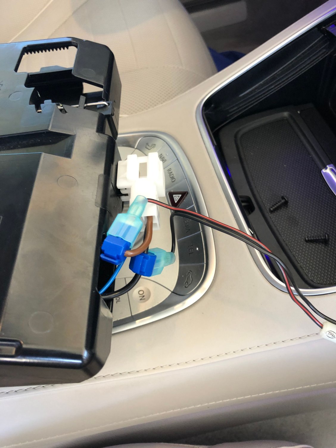

I just hardwired my passport to the 12v outlet in the dash. Pretty simple and about time I contribute.
You need to remove the ashtray, no need to reinvent the wheel here is a great video:
T-Tap the brown wire (negative)
T-Tap the black wire (positive)
Easy.
This was INCORRECT. Took some troubleshooting to realize that the brown was negative and black positive forgot to take a new pic.

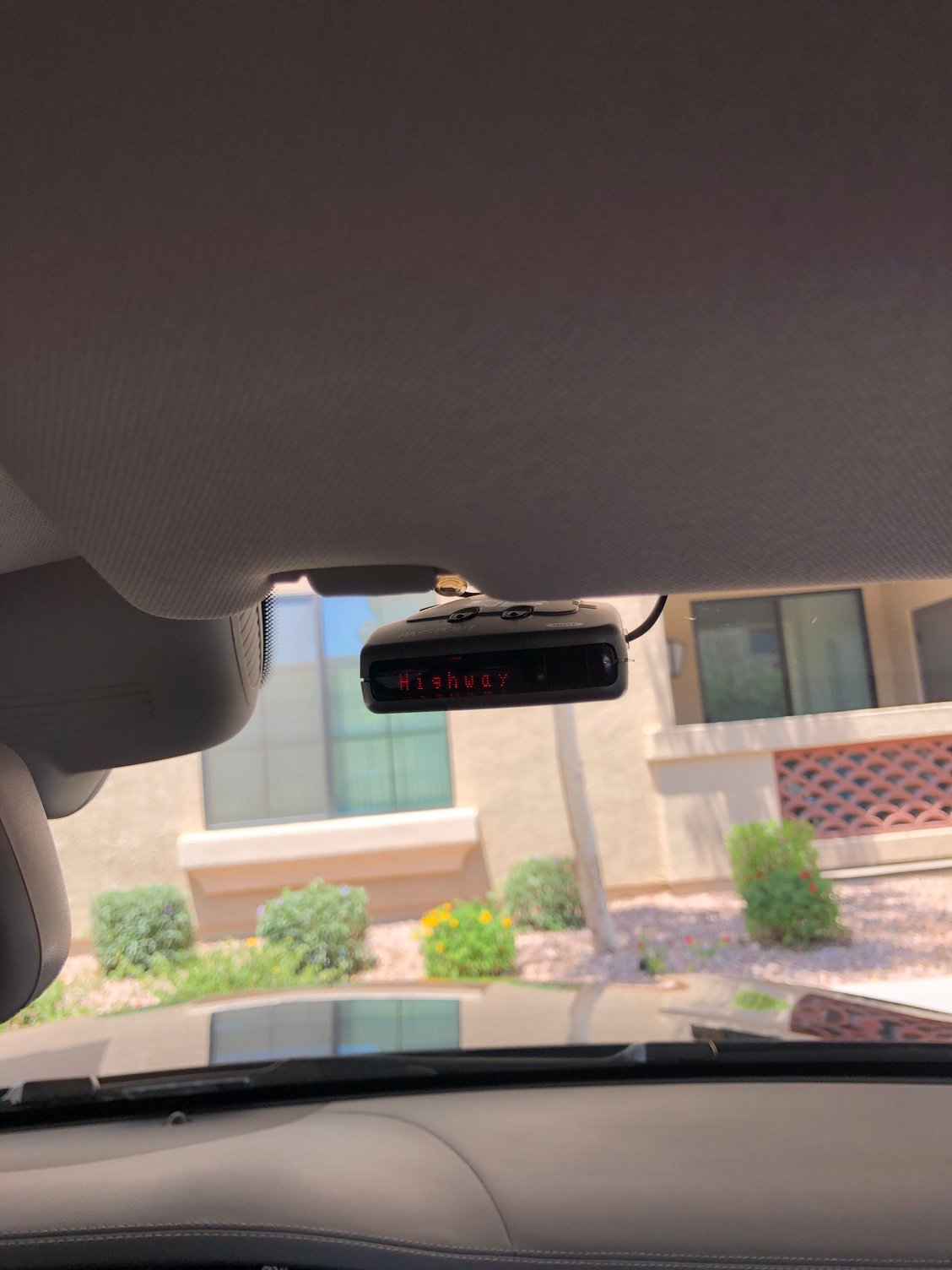

This is one of the two spots it will be able to bypass the solar protection for signal

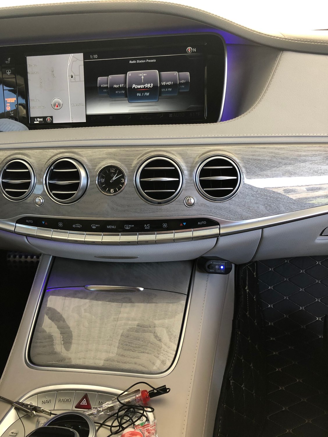

Did not need velcro just tucked the wire in.
Hope this helps someone! -Ajay
