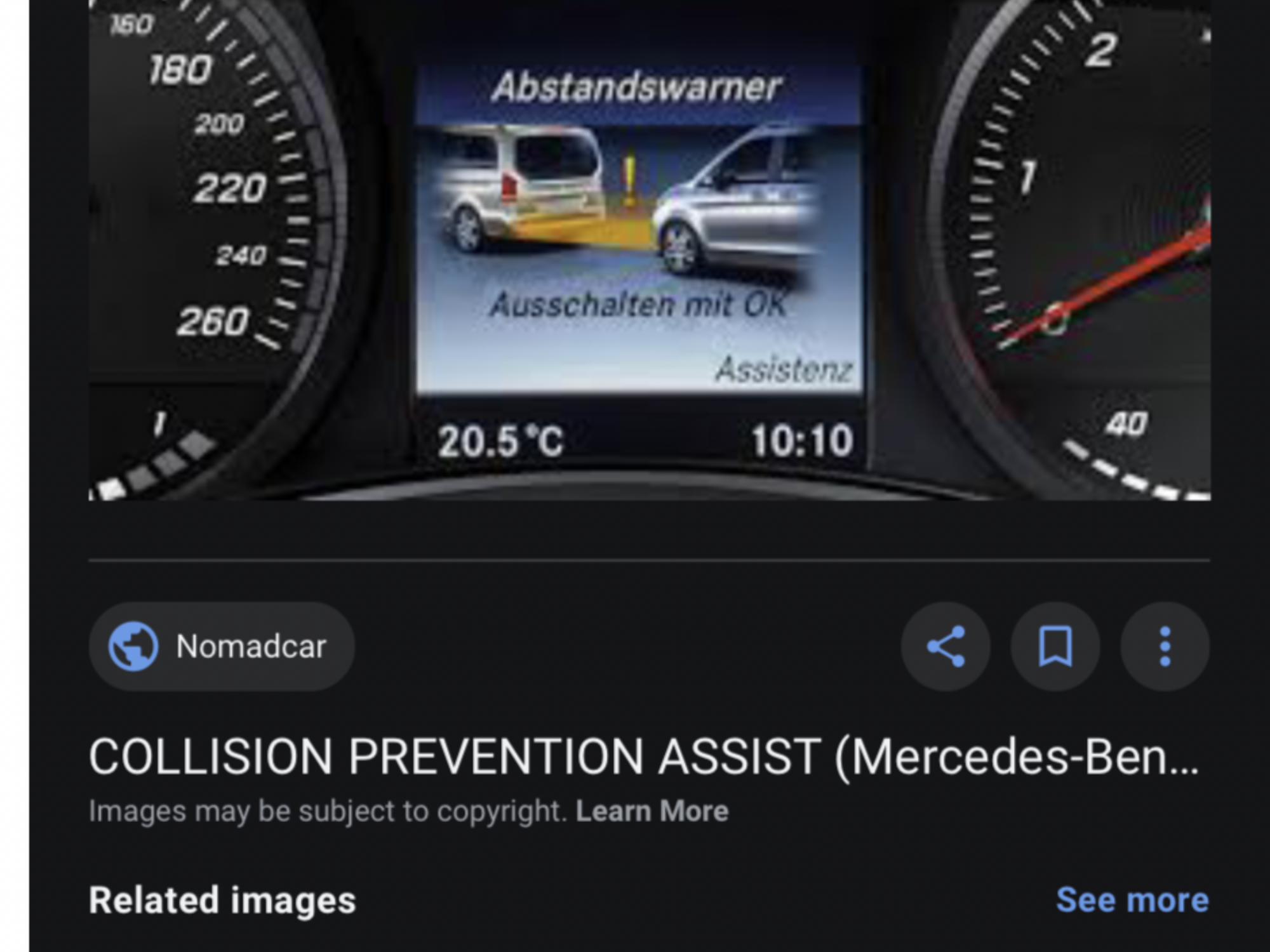

I can't thank you enough. I have found the accessory socket and I will get some WD40 silicon spray and use it carefully to hopefully sort the sticking issues. You may not know the answer to this last issue I have. When I start the car, I get an icon on the screen in front of the steering wheel that warns me that a system is not active or disabled. It is an image of two cars, one behind the other and I think it is indicating a collision. Perhaps some sort of collision warning system? Any idea what this is? Thanks again for your time, I appreciate it!

At a guess I think that could be the adaptive cruise control, the image you mentioned sounds like the image that shows when you want to increase or decrease the following distance when the adaptive cruise is engaged.
You can check if your car has adaptive cruise by seeing if there is a rectangular piece of plastic about 6" wide and 4" deep in the upper centre area of your grill on the front of the car.
If you can get a photo of the image on the dashboard nest time it pops up then it will help us to find what it is for.

Just found this image on google , this one is for a collision avoidance system, maybe if a car does not have distronic adaptive cruise then it may have this instead ?

Yes that's pretty much it, except on mine they arent vans in the image, they are cars.

https://xenons4u.co.uk/blog/collisio...ative-message/
ok. Take a look at this link, it might help you out, there appears a way to actually turn it on and off by pushing a couple of things at the same time, might be worth a read through.
