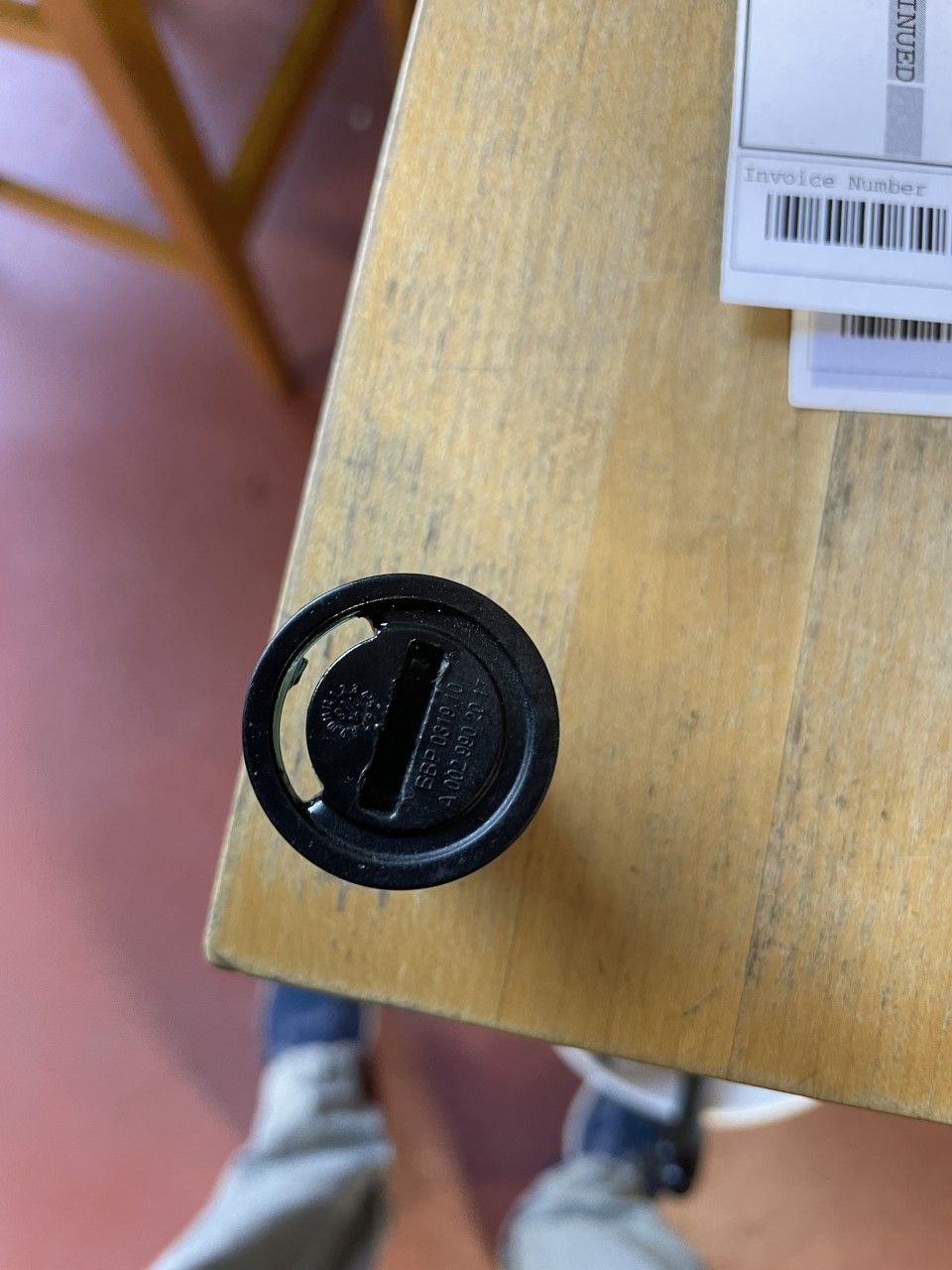

??? Whats the problem? Its a plastic plug, with an O ring. I use a short small flat blade screwdriver loosen and it will come out in about a half turn. Its a screw type plug, not threaded, grooved. Takes less than a full turn and pop it out. Mercedes says to replace during each oil change. I have not found this to be needed. Clean it, lube the O ring and re-install. I do replace it but after 3 oil changes. You cant over tighten as it one turn and it stops in the groove. Dont force it either way. I bought the correct mercedes oil cap wrench. Easy peasy.

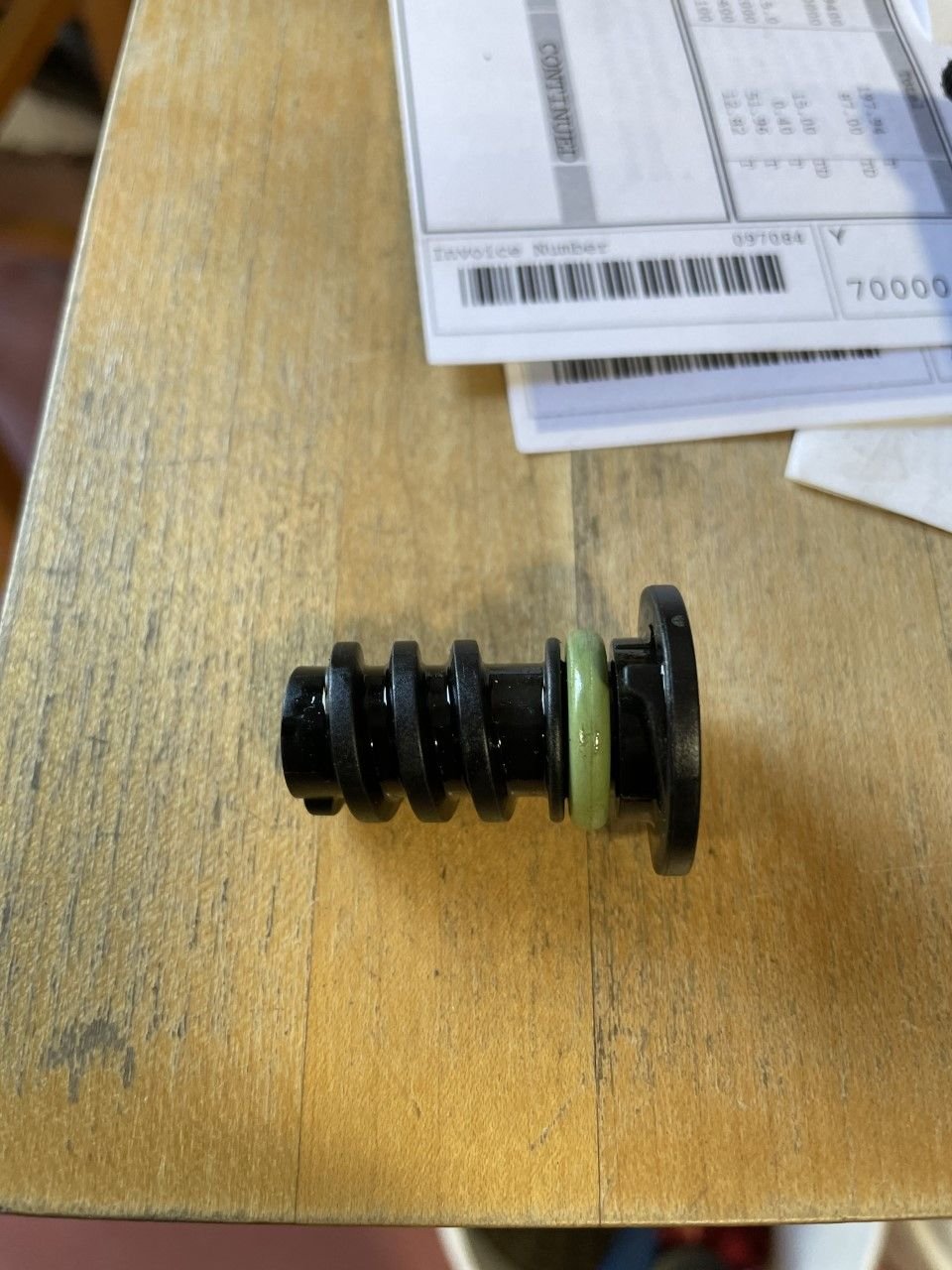

I changed my oil today, took a pic for you. There are two stops on the screw, so as you tighten it stops and thats it, dont try to keep tightening.

By any chance can you type out that part number. Also what socket size is needed for the filter ?

Hi mate
i am about to do my first oils change tomorrow, I have the filter and the sump plug as above, the question is: Was there a copper washer as well to go with the plastic sump plug because I don’t have one and haven’t seen it for this sump plug?? Thanks so much
The copper washer is for the older cars with steel oil pans and it crushes and seals. This car is completely different even the oil pan is composite. No copper washer needed, just this plug, as you tighten, it pulls in the O ring to seal, as it stops thats it, no torque rating just turn to stop and seat. As you tighten you will see and feel two stops the second one is sealed and done. I have used a new plug three times with no leaks or issue, even though they recommend change each time. Good luck, its a simple oil change.
