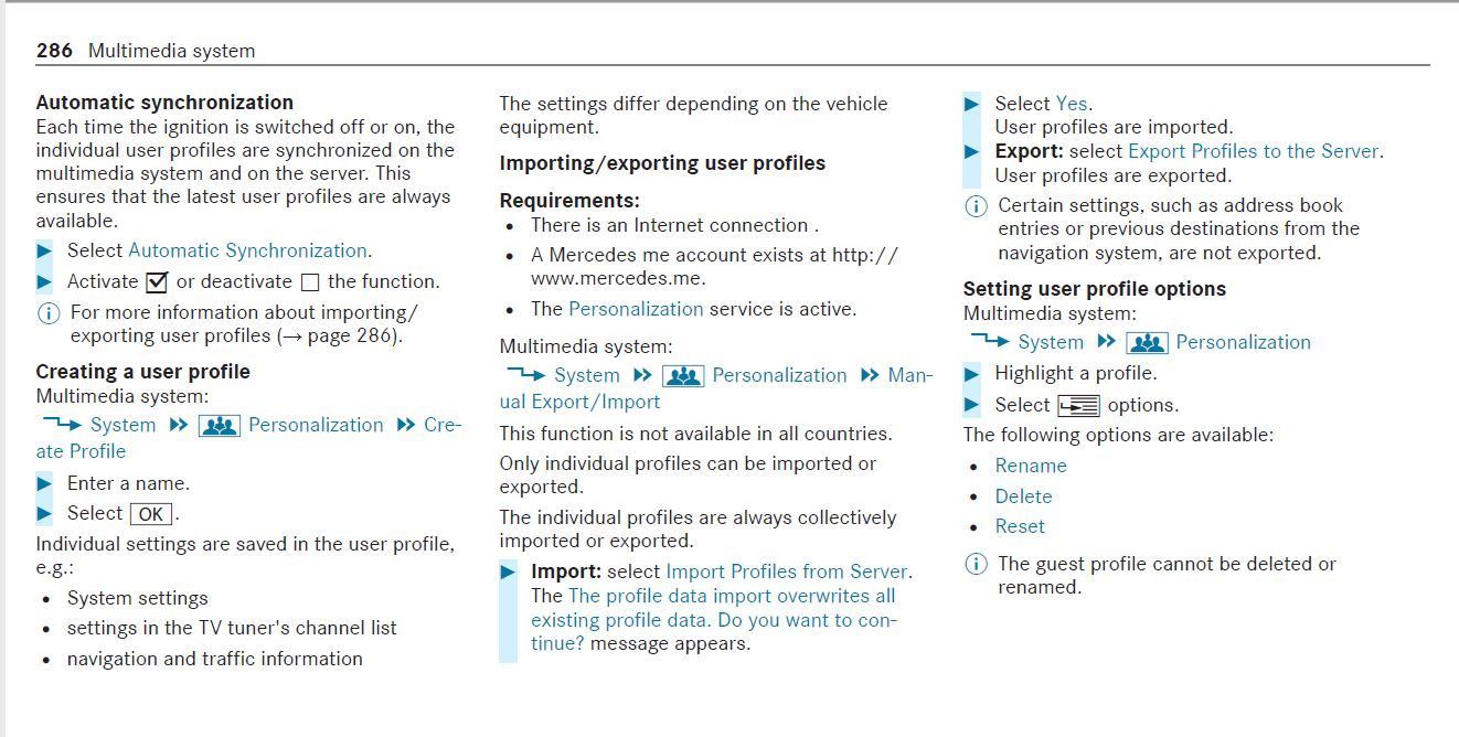

I have a 2018 S560 and keep having to turn certain options back on regularly. For instance, I set my dynamic seats to level 2, turn air ionization on, fragrance boost on low, and ambient lighting to 100%. A week or two goes by and all those things change back to factory default. Brought it to the dealer, they did a software update, and sent me on my way. Unfortunately, no change... Has anyone else experienced this? Any fix?

Any chance you are using a different key. Settings stored on Key 1 and sometimes you use Key 2?

Are you using the User Profiles and have them synching to the server? Typically when this happens it's an outdated user profile that syncs to the car and overrides the current settings. Adjust your settings to your liking and then manually export the profiles to the server. I don't know about mBrace in the 2018, but they messed around with the personalization service in Mercedes me connect for MY2019+ and rolled out a new version. When they did that my profile on the server was completely out of sync and I had to do the export to avoid old settings from coming back.
THANK YOU! I'm going to check this out this week and report back.
