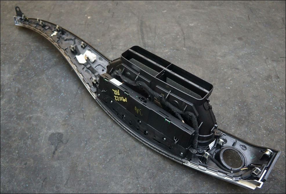

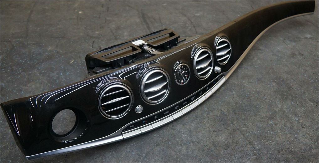

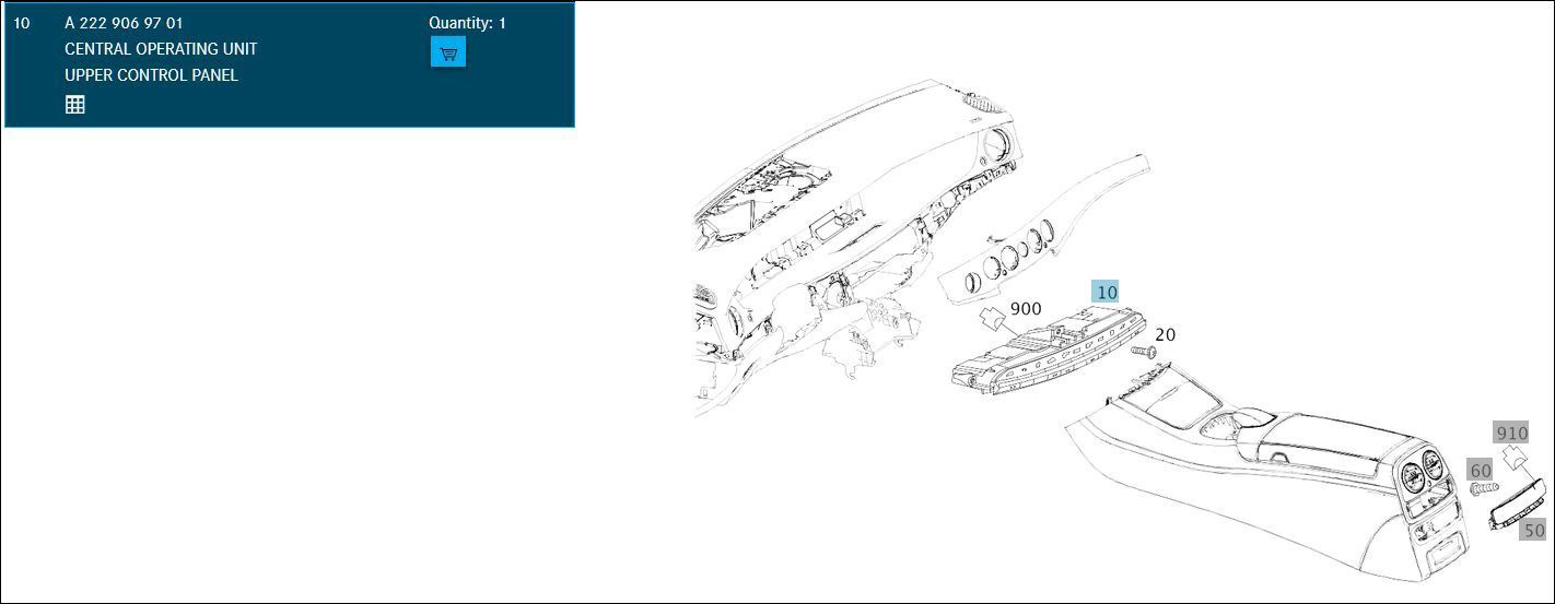

Multiple actuators are located in A/C housing, control head = operating unit in dash.
Rats so they would have to remove the dash to fix the control head???
Old Mar 22, 2022 | 11:30 AM
konigstiger's Avatar
Posts: 15,901
Likes: 4,632
From: North Scottsdale, AZ
'71 Pinto
And a bit more to replace actuators.

Your question is best directed here: http://www.ask8ball.net/ if it's any consolation UCP (control head) controls actuators it may the only part replaced, simply requires removal of trim panel.

well! You are right. They called me and said entire job is about 761 dollars plus tax and diagnostic fee. They do not need to take the entire dashboard out. And the climate control head just needs a software update! Not too bad!
they said the actuators were literally stuck on both sides. So happy that is isn’t a more bigger job. However, have to wait for parts to come in. Should be done end of the this week hopefully or at the latest beginning on next week.
