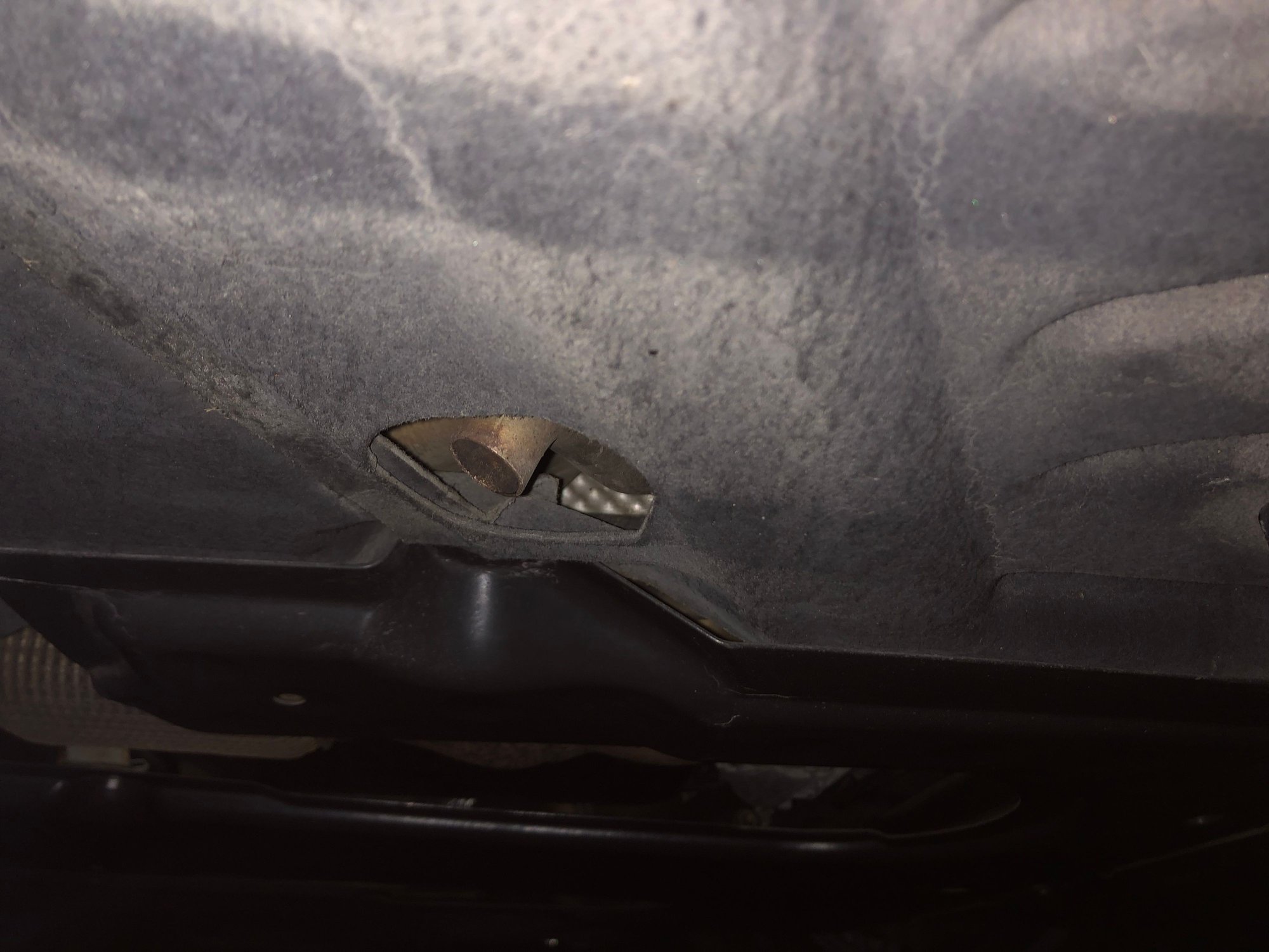

Hi Team 222.
Am I missing a drain tube?
This is under the right front side of the car, just behind the right front tire.
Recently I changed the fender liner and replaced one large drain tube, (the one everyone says makes a dragging sound after a large puddle, when it falls out, I super glued it in)
I did notice what looked like another connection for a drain tube behind the large one I reinstalled.
you can see the outlet for the large drain tube that I reattached, but what is supposed to come out of this hole?
See this hole? Am I missing a drain tube?
Am I missing a drain tube on the right front?
Notice the large drain tube lip in the right side of the pic

what I am trying to be sure of is, are there only 2 drains that come out of the front? Or does that have a missing one for that hole?
Old Dec 23, 2022 | 08:01 PM
vinflouen's Avatar
Joined: Jan 2009
Posts: 566
Likes: 261
From: In The Woods
2019 W222 S560 4Matic/2025 Yukon Denali
thank you for that Intel.
That solves it, there are only 2 drains out.

That's the hole for the exhaust pipe for the petrol/diesel heater, in case you had that option.

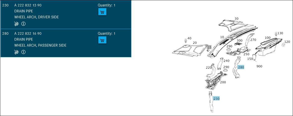

S560 Drain Part #280
Thanks for the info Vin, my part #280 just fell out. It was dragging, I stopped and saved it. Do you think it is necessary? I'm thinking of leaving it out. Any real need for this thing? Seems like an afterthought the way it is installed. Rgds, Tim

Hey Tim, did you ever get a response to your question? My part #280 fell out today after driving thru a puddle. It was dragging on the ground so I pulled it out. It is not salvageable so it will need to be replaced. I will make an appointment with MB dealership but I would prefer to wait until the A service is due (two birds one trip). So how long can drive around without the drain pipe?
I drove around for about a week the first time mine fell out. Replaced it, and it fell out again during the next heavy rain. I drove around for a couple of months until a service was due, then I had the dealer fix it under warranty. You won’t have a problem driving without it - in fact I would bet there are a significant number of W222s driving around unaware that theirs is missing.

I still have mine in the trunk with no intention to reinstall it. Seems totally superfluous and horribly designed in regards to just staying in place.
