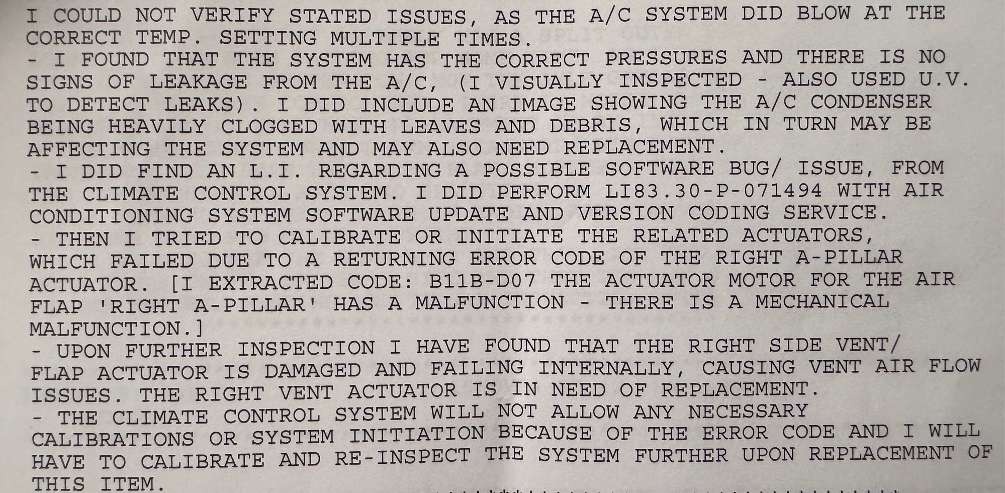

Old Nov 20, 2024 | 10:46 AM
Aa007's Avatar
Joined: May 2022
Posts: 36
S550
Technical feedback
Picked up the car and found more detailed information than I was ever given over the phone, even with all my probing. Should be illuminating to someone who understands all this.
Diagnosis
Diagnosis
Old Nov 20, 2024 | 12:18 PM
VII's Avatar
VII
Joined: May 2011
Posts: 975
Likes: 270
From: Fort Worth TX
2020 S560, 2014 SLK55 (Prev. 2016 S65, 2013 SLK350, 2008 CLS63, 2006 E350, 2006 CLS500, 2005 C230K)
It seems he did perform an update so that would have reset the control unit, no AC even just after you left?
B/c the tech indicates that the AC works when tested.
He is stating he can't run calibration because of that motor but calibration is not needed to test compressor and system for operation, also if you want that flap replaced the way to do it is removal of glove box not the whole dash (see video below).
Old Nov 20, 2024 | 12:42 PM
Aa007's Avatar
Joined: May 2022
Posts: 36
S550
No AC when I left.
Was 60 degrees but obviously not cooling.
Just sat down with a service advisor for 25 mins in the car as I explained the whole history and frustration (since he started with “we need to recharge the system”). He acknowledged it’s trying to cool so it’s obviously not a freon issue, and you have a new compressor.
Got him to agree to a more thorough inspection of what else it could be. Look at sensors, actuators, pressure etc. I’m not looking for a lazy diagnosis. For goodness sakes it was just recharged again last week for the 5th time.
[He even tried to get me to go above to the service manager or general manager at the previous dealership. I’m so annoyed, I told him I need fresh input. Lost confidence with them.]
Old Nov 20, 2024 | 12:44 PM

Old Nov 21, 2024 | 12:30 PM
VII's Avatar
VII
Joined: May 2011
Posts: 975
Likes: 270
From: Fort Worth TX
I have not done this personally but from what I gather you can replace both the actuator and duct section (mechanical part) from there.
You'd have to get your hands dirty or find an indy though, a dealer is not going to help you save on labor.
Looks like a 3 hour job for trained hands.

Old Nov 21, 2024 | 02:59 PM
VII's Avatar
VII
Joined: May 2011
Posts: 975
Likes: 270
From: Fort Worth TX
The video is for removal of the AC potentiometers (the silver push out knobs) so it includes other locations.
​​​​​​The parts relevant to you are removal of center trim and glove box, removal and reinstall should be about 3 hours. Parts that you need are the duct section and the Servo.
Old Nov 21, 2024 | 03:19 PM
Aa007's Avatar
Joined: May 2022
Posts: 36
S550
Ok. So the duct and the servo account for everything on the write-up. Got it.
Does this sound to you like the flap may be stuck in a bad position or it is somehow registering a fault and causing the system to shut something down or enter a failsafe mode? Air not blowing properly out of one vent is one thing, causing the entire system to not operate properly is another. What I’m getting at is if this description changes your opinion of “100% not your problem”.
