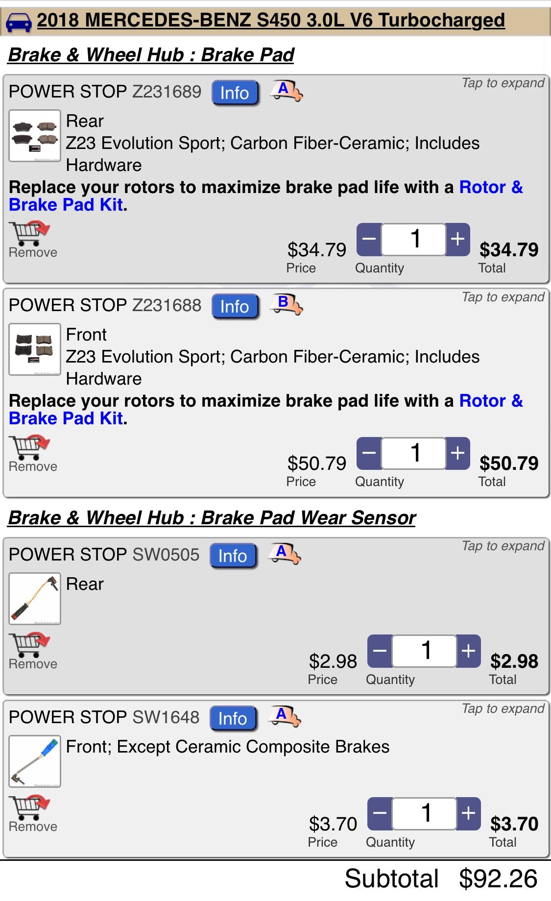

My new to me 2018 S450 4Matic 32k miles with air suspension needs new brakes. I had it checked out by an Indy who said the car is in terrific condition but needs brakes soon as they are down to 4 and at 3 the brake sensors will go off.
The quote to replace the front was $1351 and the rear was $1093. Ummm… 😳 That’s OEM pads of course.
I am looking at RockAuto’s price for Power Stop ceramic pads for front and back and wear sensors and the total is under $100.
Is this a difficult job? I’m having trouble understanding. I am also a little intimidated by the air suspension.
I’m including what I have at RockAuto. Maybe I’m not picking out the correct platinum coated ceramic pads? Also is that front brake wear sensor not going to work?

I just watched one video and it seems pretty simple. Anything I should be aware of with the Airmatic suspension? The wear sensors are so cheap I may as well replace them I think.
Do these seem like the right parts?

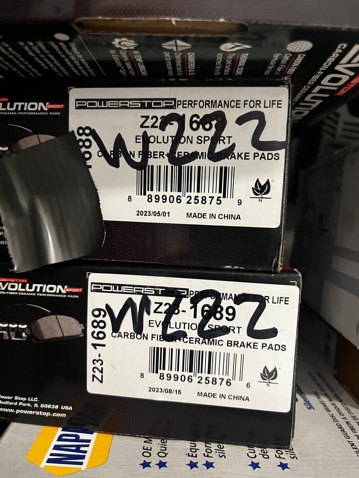

These are the part numbers used.  Forget the air suspension - it’s not involved in what you’ll be working on.  No sweat.
