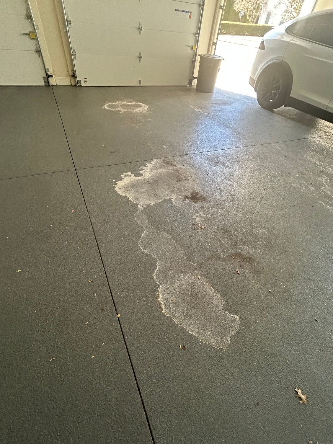

This is a weird question, but does anyone know why there are major puddles on my garage floor after I park my S560? My wide is pretty annoyed as it does not happen with other cars that we have/use. See pictures attached. While these pictures reflect parking after picking up some salt on the roads, the puddle/condensation is much more than any car I have used

maybe when you shut car off afer driving with AC on the evaporator drain still has condensate water dripping off onto floor.
All my cars do it.

Interesting! My S550 used to leave white spots like this below the rear diff, far from the A/C condensate drain. Never any sign of leaks from the car, and never had this with any other car before the S-class ...

Salt going to salt on the floor. Often due to snow slowly melting under the car. You can have that fourth season!
Humid climates will make for a LOT of water continuing to drip from HVAC after turning the car off.

Some mufflers have weep holes in them too.

In a similar fashion, but unlikely, if there is an exhaust leak condensation will form.

Its because of all the covers that are under the car. Water gets above them and it drains out as the car sits there.
