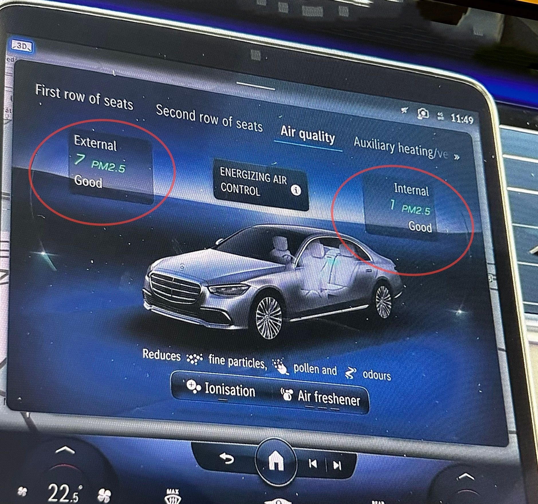

Do you guys have the Air Quality Particulate Matter (PM2.5) sensors found in the Climate menu/Air Quality. . See attached pic.
Mine doesn’t 🥲
Old Oct 14, 2022 | 05:39 AM
martinlarose's Avatar
Posts: 435
Likes: 129
From: nova scotia
2025 e 450
yes i do
Old Oct 14, 2022 | 08:36 AM
Phillyfinest's Avatar
Joined: Mar 2018
Posts: 267
Likes: 56
From: Maryland
2023 S580 (current), 2019 Range Rover HSE V6 (current),2021 S580, 2018 S560 4Matic, 2015 S550 4Matic
Never seen that screen before. Just the Ionozation and Fragrance.
Old Oct 14, 2022 | 08:41 AM
Sonic Boom's Avatar
Joined: Sep 2020
Posts: 738
Likes: 188
2021 S500 (Mojave Silver), MB S400 (wife), BMW 750Li (passed on to kids)
Originally Posted by martinlarose
yes i do
What year is your W223?
Do you also have the auxiliary heating/ventilation?
Old Oct 14, 2022 | 11:58 AM
Posts: 435
Likes: 129
From: nova scotia
2025 e 450
mine is a 2022 and I do have #824 additional parts for Cold Countries and p53 energizing air control and p69 warmth comfort package . not sure if any of these features include what you have asked about
Old Oct 14, 2022 | 12:40 PM
Diesel Benz's Avatar
Joined: Dec 2006
Posts: 6,499
Likes: 335
From: Europe
I have that menu too. Seems it comes with P53 which again seems to be standard for us. I have 824 and P69 too but don't think those would bring the menu. Cold countries usually have clean air anyway.
Old Oct 14, 2022 | 12:43 PM
Sonic Boom's Avatar
Joined: Sep 2020
Posts: 738
Likes: 188
I think P53 didn’t come out until MY22. Mine is MY21 which wasn’t available/offered at the time.

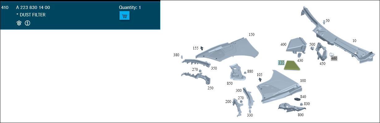

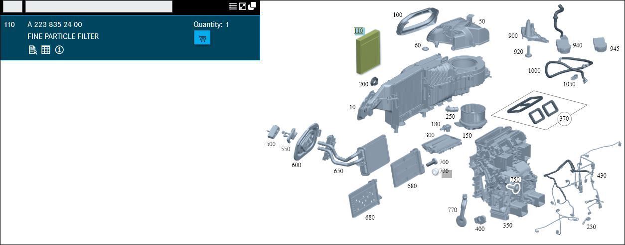

Old Oct 14, 2022 | 12:44 PM
konigstiger's Avatar
Posts: 15,901
Likes: 4,632
From: North Scottsdale, AZ
'71 Pinto
Have yet to research: fine particle filter (110) + dust filter (410).
Old Oct 14, 2022 | 12:47 PM
Sonic Boom's Avatar
Joined: Sep 2020
Posts: 738
Likes: 188
Hi, does that mean it might be possible to retrofit?
(I do have P21 AIR BALANCE Package)

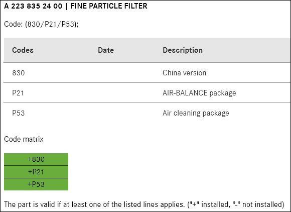

Old Oct 15, 2022 | 02:06 AM
Joined: Dec 2006
Posts: 6,499
Likes: 335
From: Europe
The list just says the better filter is there if one of the three options is valid. No need to go for a "China version".
The most relevant parts in relation to the particulate matter menu and readings would be parts 940 and 945 on the first parts figure posted by konigstiger.

Old Oct 15, 2022 | 10:35 AM
DoctorDash's Avatar
Joined: Dec 2012
Posts: 297
Likes: 89
You know I dont have that in my main screen, however I do have it on the rear screen. I see the fragrance option is there also, I dont have that as it was deleted off my option list I wonder if thats why I dont have that on the main screen in the front. I can see it working in real time on my tablet
Old Oct 15, 2022 | 04:57 PM
Spicy's Avatar
Joined: Jun 2022
Posts: 43
Likes: 16
2022 S580 Executive trim
Mine has it as well. It's in the climate menu.
Old Oct 16, 2022 | 07:08 AM
Sonic Boom's Avatar
Joined: Sep 2020
Posts: 738
Likes: 188
Hi, Do you think I can order the 2 parts (940 & 945) in addition to the Fine Particle Filter and would work/show up on menu?
Old Oct 16, 2022 | 10:20 AM
Joined: Dec 2006
Posts: 6,499
Likes: 335
From: Europe
The relevant control units would need to be coded to make them aware of the sensors. I did not check but the sensors would likely be read by the HVAC control unit and MBUX would likely need coding too to activate the menu for the new parameters. If MBUSA accepts P53 to be added to the vehicle data card, then a Mercedes workshop could easily handle the coding. Don't know what is their policy but if the option was missing only from MY21 cars and is standard since then (in the US), perhaps they would do it.
It would be more than just the sensors and the filter that need to be retrofitted. The menu should not even need the filter but then the before and after readings would be about the same. The sensors at least need piping and wiring, no idea what else is needed.
Old Oct 17, 2022 | 03:54 PM
Bubba1's Avatar
Top Answer: 1
Joined: Mar 2022
Posts: 404
Likes: 386
2022 S580
I have it and have surprisingly often. With the way the environment is these days (Climate change etc), I often used it this summer especially with wildfires. I was surprised as to how much better the air quality inside the car was vis a vis the outdoors. It seems quite accurate as I would turn it on inside my well insulated garage and watch the outside measurement change and compare it to the weather gurus numbers. Truly amazing!
