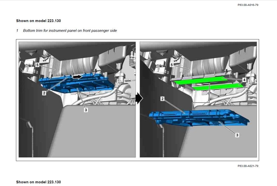

Does anyone have the excerpt from the factory service manual that shows how to replace the inside cabin filter? I know about the filters that are located under the hood at the HVAC air intake by the cowl area, but I cannot find the inside filters. I was able to do my W222, but I can't find anything on how to change the W223.

The main page:
