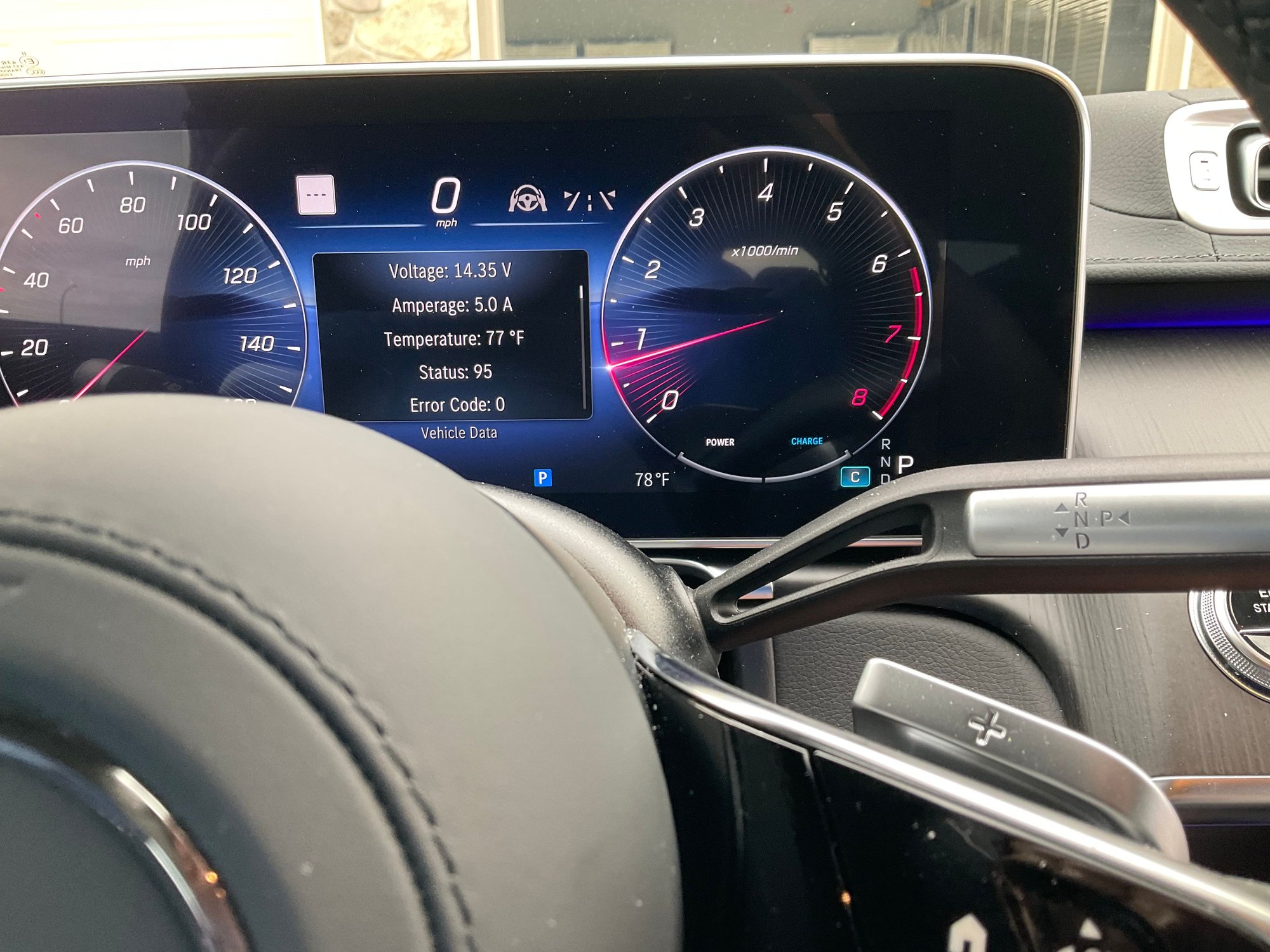

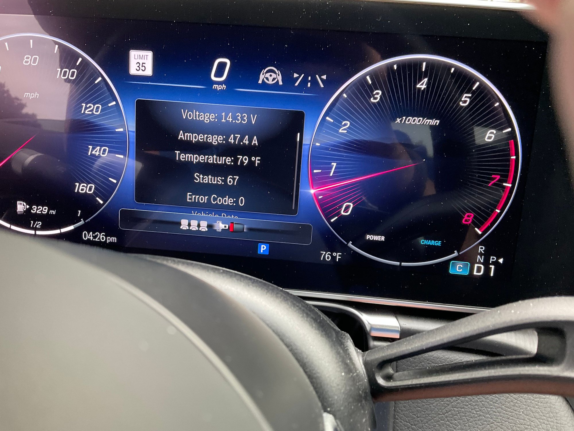

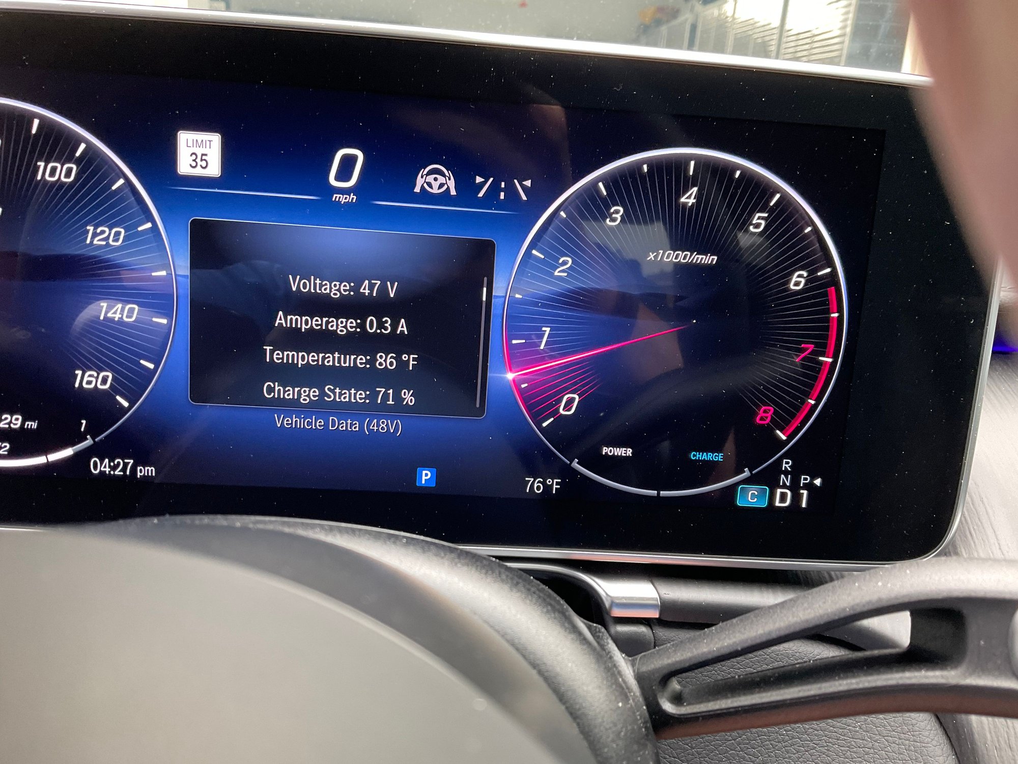

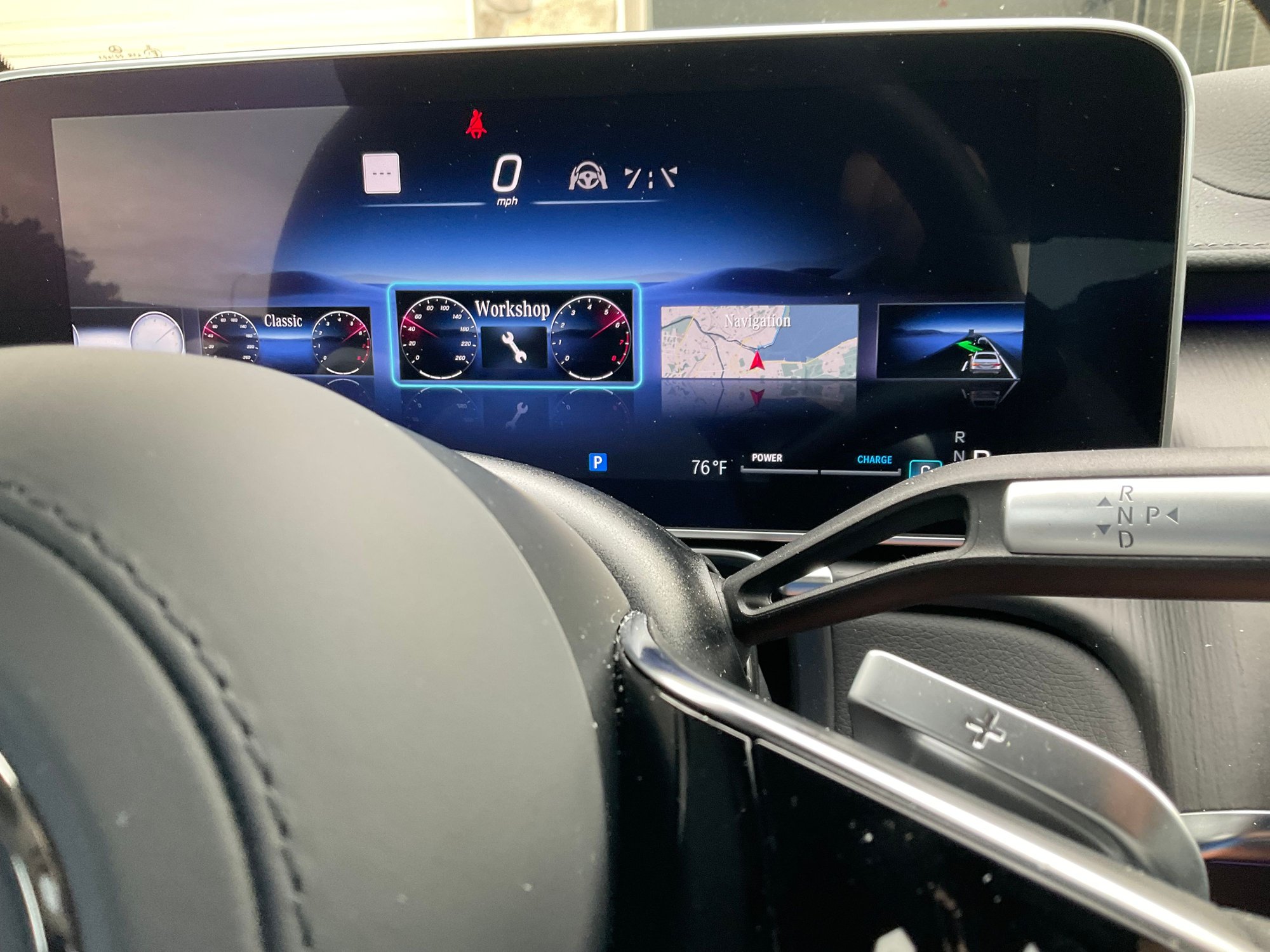

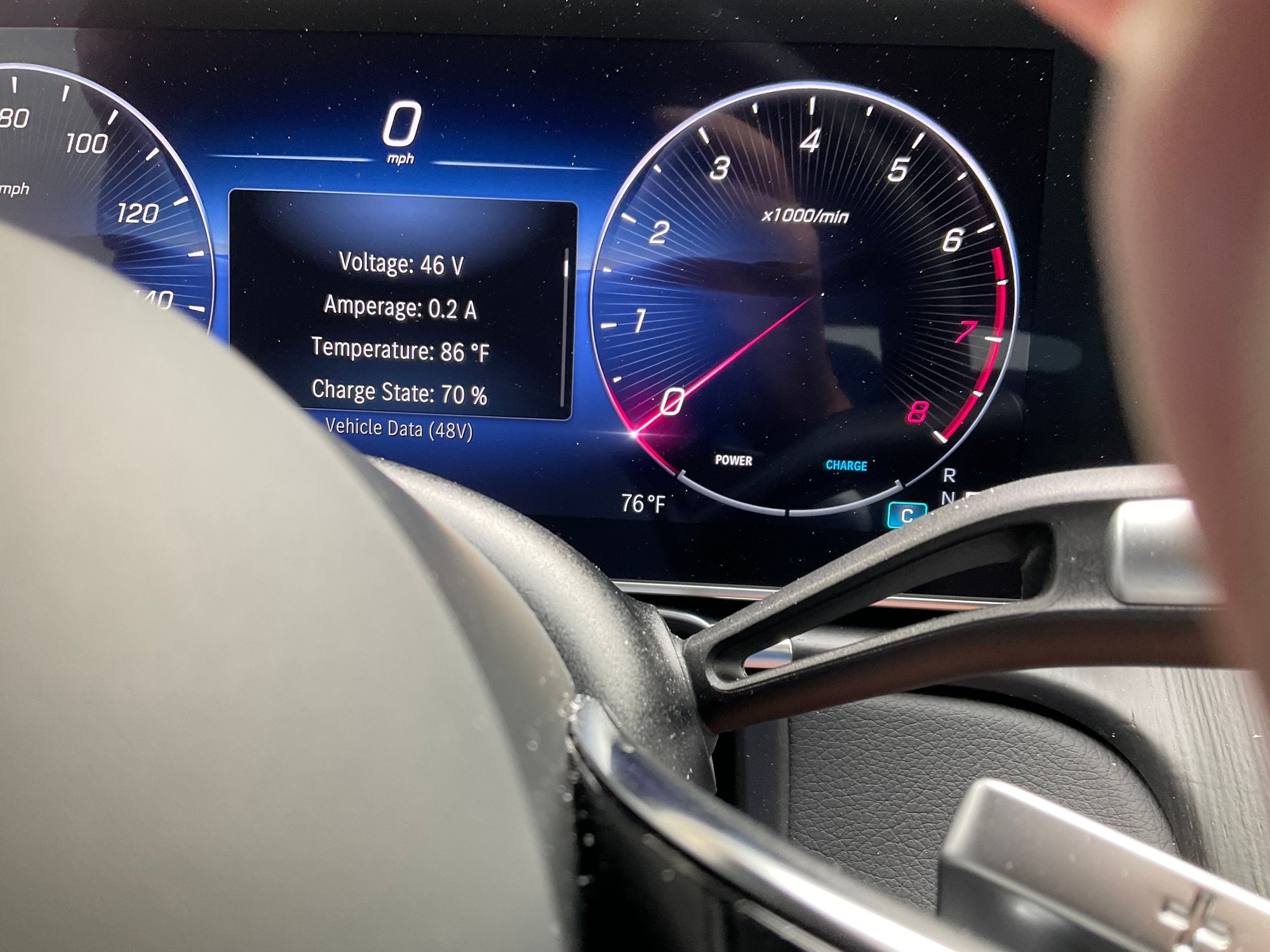

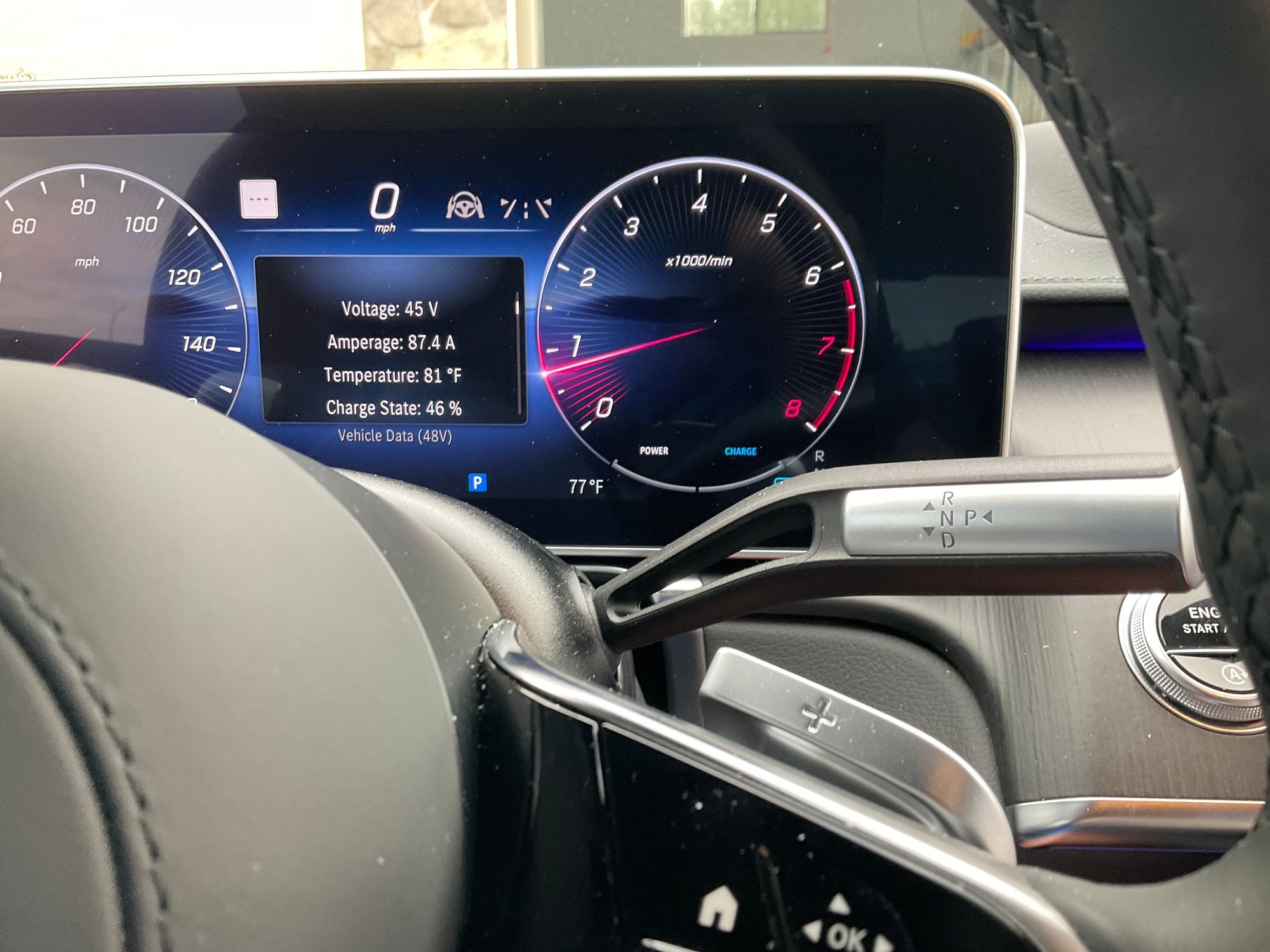

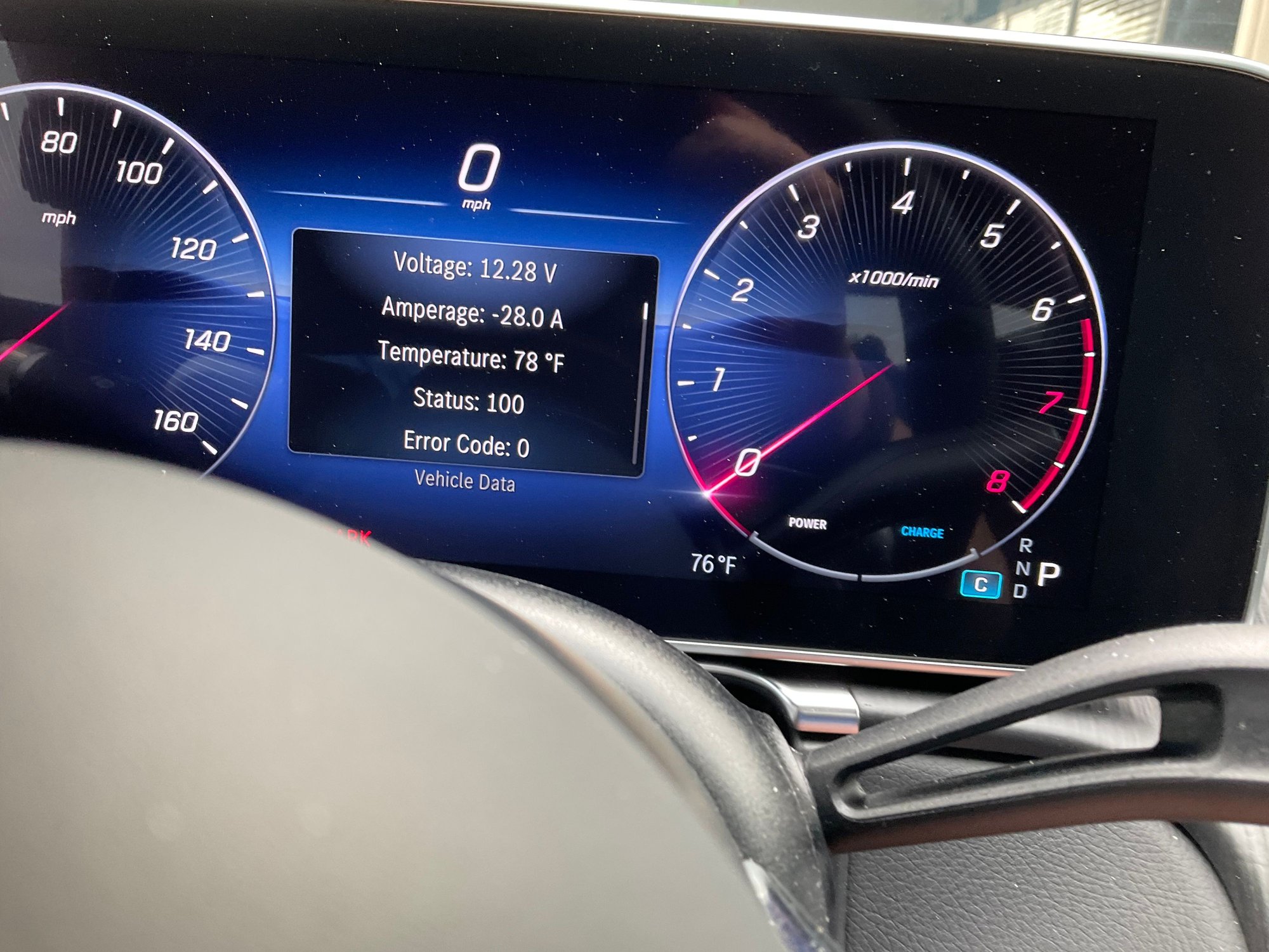

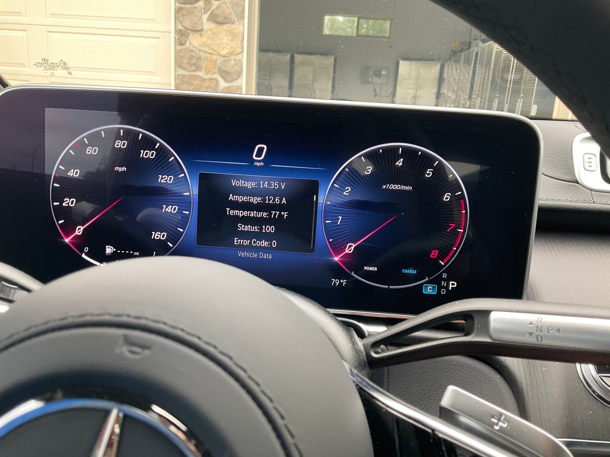

Finally, got the workshop menu. I found that I was hesitating between the Home button and the O K button. A sense of urgency is required. I consider myself deliberate my wife prefers slow.
I’ve attached photos of the 12 volt and 48 volt data screens.
The screens above show the data after a short drive.
At idle after a short drive.
At idle upon start.
Data screens when workshop menu first accessed.
My untrained mind suggests that things don’t look to bad, but what do l know? When I put it in standby after the short drive(approximately 45 minutes in city traffic) it only measured my status as good for 5 weeks.

Originally Posted by retatt
https://cimg4.ibsrv.net/gimg/www.mbworld.org-vbulletin/2000x1504/img_0257_0a3729f1d1963399af3823a6efe02a644184ce76. jpeg
https://cimg5.ibsrv.net/gimg/www.mbw...59d78aea4.jpeg
https://cimg2.ibsrv.net/gimg/www.mbw...6448b2487.jpeg
https://cimg0.ibsrv.net/gimg/www.mbw...b843b21f9.jpeg
https://cimg9.ibsrv.net/gimg/www.mbw...43e6105c6.jpeg
https://cimg8.ibsrv.net/gimg/www.mbw...6ae5286ac.jpeg
https://cimg7.ibsrv.net/gimg/www.mbw...6efe649d6.jpeg
At idle upon start.
https://cimg3.ibsrv.net/gimg/www.mbw...51eddf9cf.jpeg
https://cimg2.ibsrv.net/gimg/www.mbw...3e71ae079.jpeg

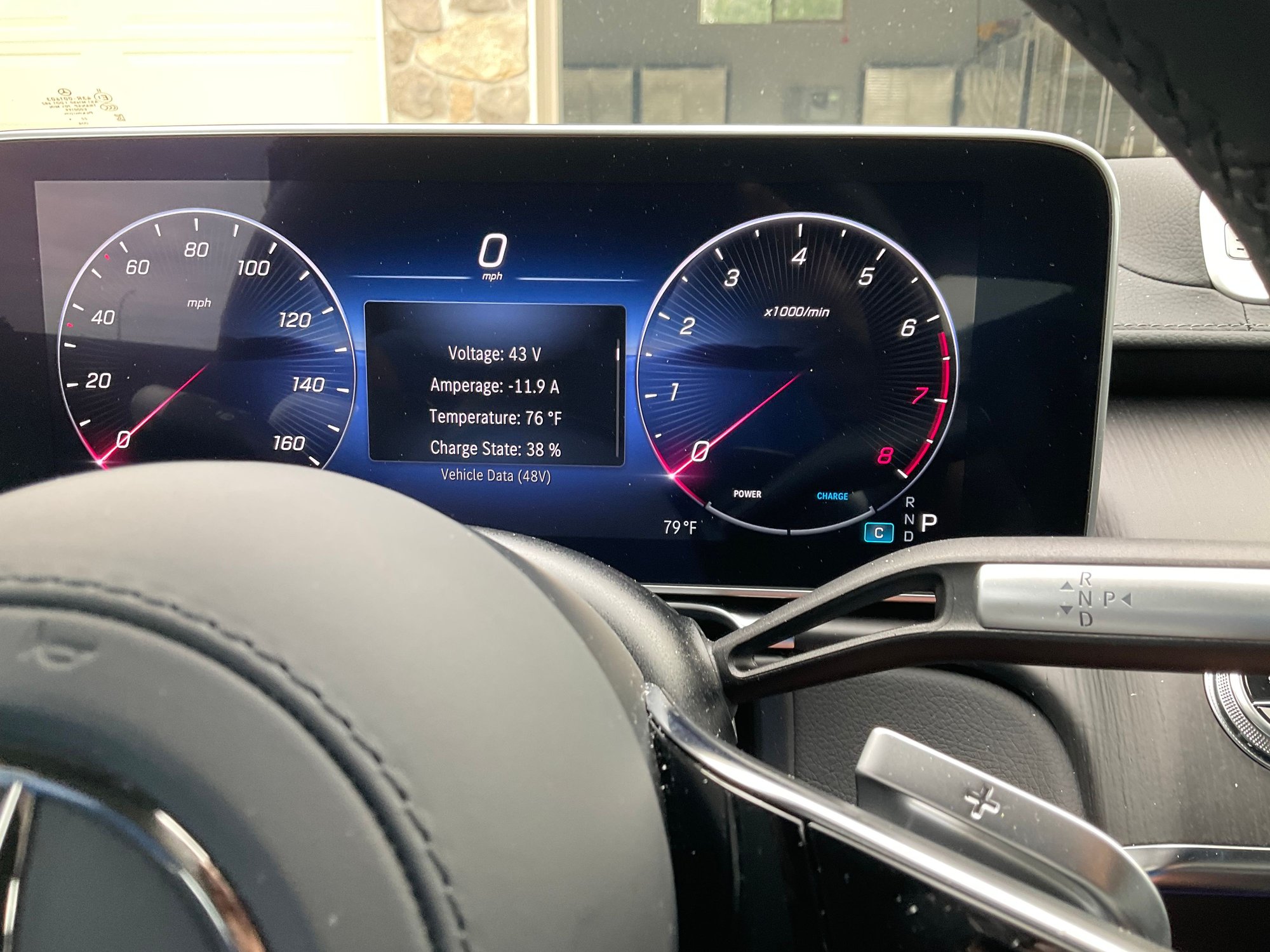

Hmmm 48V battery is at 43V.

Charge state is at 38%
Old May 11, 2025 | 05:46 PM
Thank you both for hanging in there with me. If you view the attachments from the bottom up (I should have arranged them in a more logical sequence) the values you referred to improved after my short drive around town. It seems to me that the values should be closer to full charge and the 48 volt battery should be closer to 48 volts rather than at 46 volts. And, the 12volt voltage seems a little low. Any thoughts?
I’m thinking of checking the values this evening and then again after putting it on a charger overnight.

Or, should I be worried about the values you referred to as they show the state of the 48 volt battery after sitting for a couple of days?

It does seem a little low, did you have a chance to drive the vehicle for 60 minutes non stop and check the charge? If not trickle charging it overnight might help.

Oh yes true, got to check it once fully charged again.
The pictures showed 47V at 71% charge
