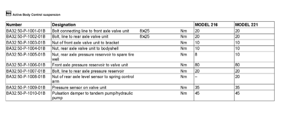

The torque for the pulley bolts is 30Nm, the pump-to-engine bolts are 20Nm. The pulsation dampener is 45Nm.
