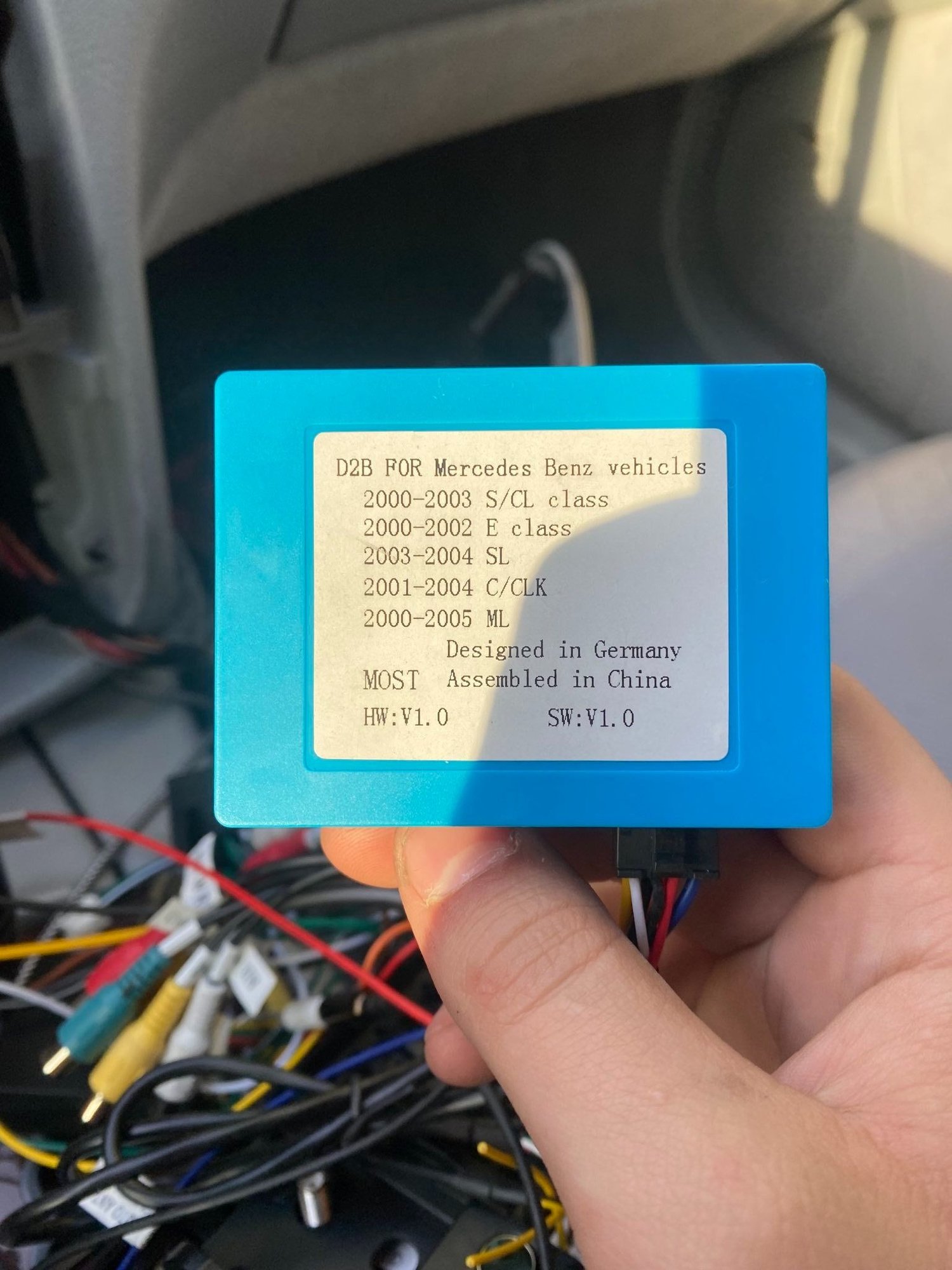

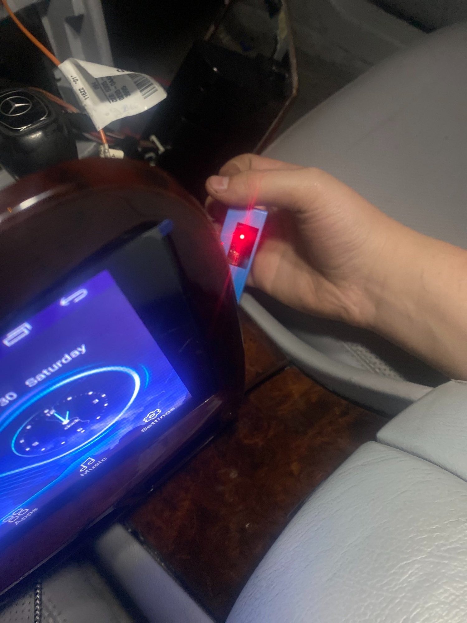

Hi there im new to this forum but not to long ago i purchased a 2002 s55 amg, the car has been great, but i want to update the headunit since i need Bluetooth connection and gps. My old radio was a command 2.5. I purchased a android h/u and a d2b fiber optic decoder. i am able to turn everything on but i have no sound. I have to manually wakeup d2b by removing and inserting the fiber optic cable 5 times to get sound. also for some reason my d2b wakeup pin is 7 and not 10. I've done the cd changer bypass. and even tried to do the tele-aid bypass but that made it worse and i dont get any sound at all. Also i can hear the amp try to kick on in the back and i can see the light turns on and off but nothing else. Has anyone done a d2b H/U upgrade that can guide me to figure out why my d2b wake up to the amp doesn't work.
