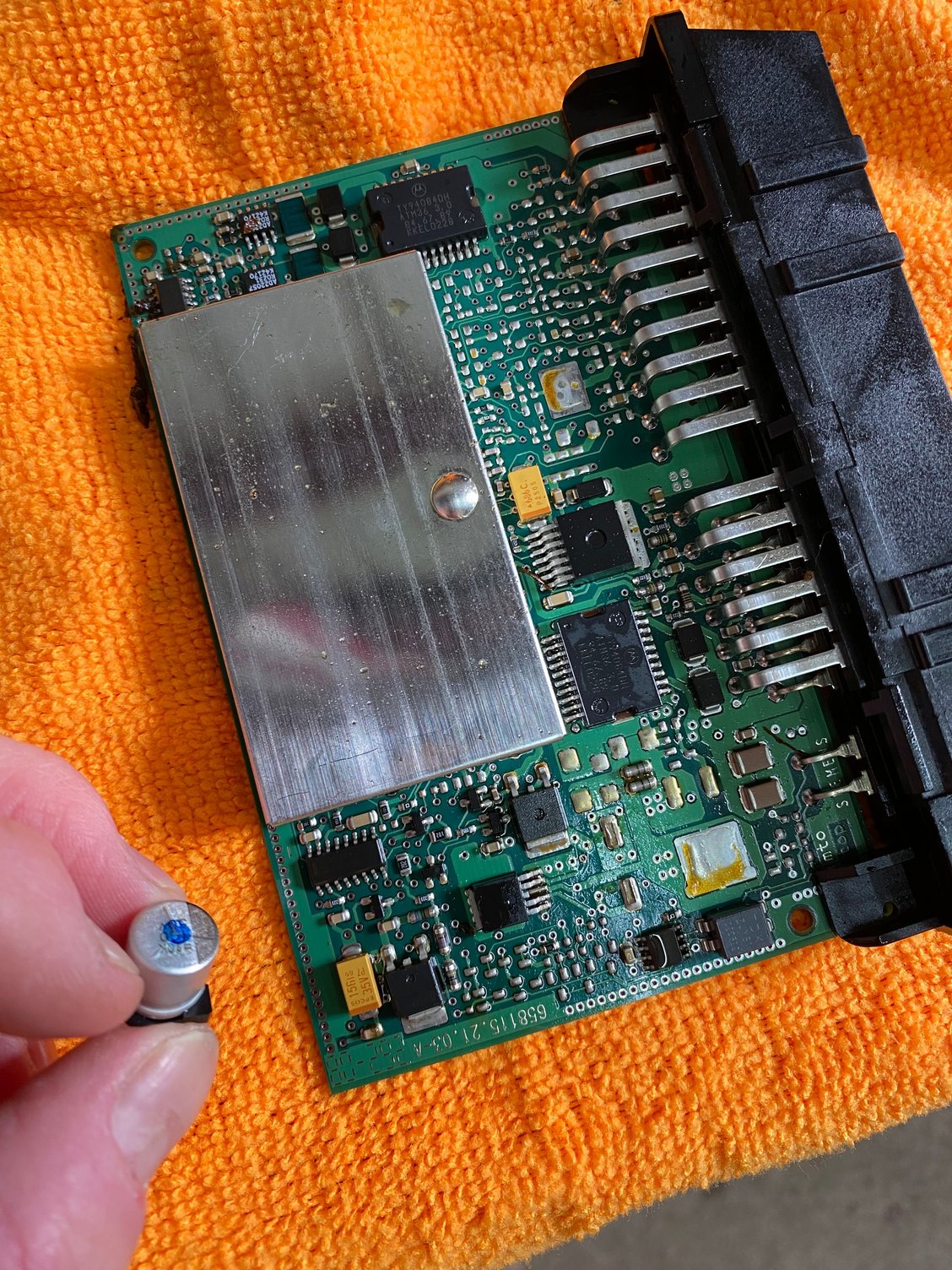

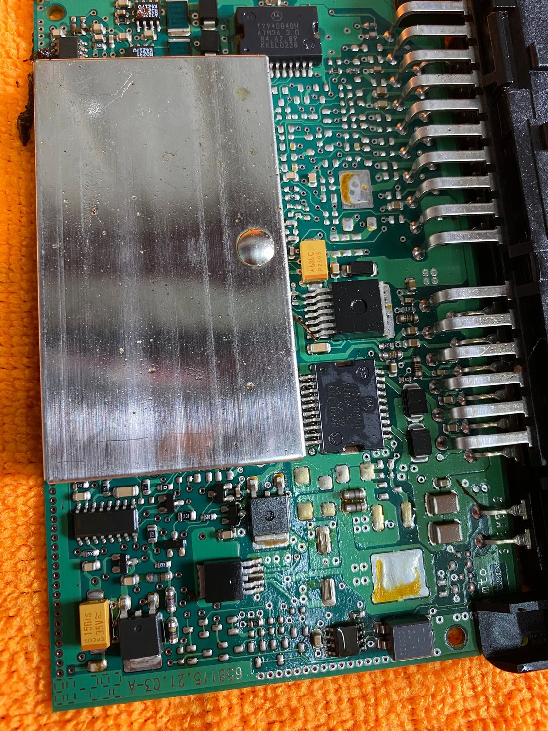

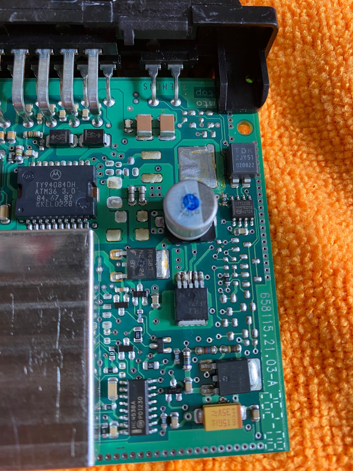

Well MAW, you were spot on. Ebay TCU came and in the same condition as my factory TCU. Covered in oil on the inside and with the same round capacitor broken off and rolling around on the inside.
I Pulled it apart and gave it the same treatment, cleaned it really well with contact cleaner and re-soldered the capacitor. Nothing. Only now it is actually showing me what gear I am in (P R N D-S), however it is stuck in S mode and still locked in 2nd gear. I can not select manual or comfort mode and the paddles do not work.
I even attempted to pull the TCU out of my CLK55 and swap it, but it wouldn't even turn over with that TCU, so no dice there.
I found a guy on FB selling a TCU and i asked him to open it up and inspect. Same thing, covered in oil and he was shocked.
So, what to do now. I have to find one that i know for a fact is clean. Autohub on eBay is the company i bought the last TCU from, and they are offering a refund. They have other on their eBay store listed as an R230 SL55 TCU which only had 40K miles on it, however its $290. I may have to bite the bullet, not sure where else to go.
I have a friend of mine who is an electrical engineer and works with auto manufacture modules all day long. He said he'll come over and run some tests on everything and see if we can narrow it down to anything further, however he seemed quite certain the issue lies with the TCU.
Fun Times!

What most of these tuners were doing, as of a couple of years ago, was buying old factory modules, reflashing them then selling them. That's why I still have my original TCU. So I'd say get it now while you can before the supply dries up.
I wish I had gone that way with my ECU, but I suppose flashing that back to stock won't be problematic. Then I'll just pop in my original TCU and have a nice day.
For this car, "I hate it when I'm right" is what comes to mind. I owned it for 10 years before I tuned it because "best left bone stock" was my instinct. I went against that instinct, because experience is better than theory. But now that I've had the experience, the car really is best left bone stock.

This is the exact route I'l be going. I was under the assumption you needed to send in a core that was certified to be working properly. I did not know they supplied the TCU.
Thanks again

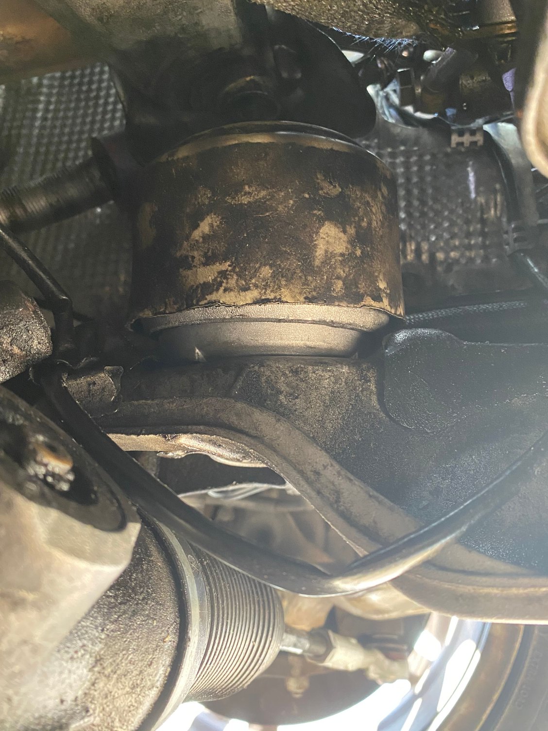

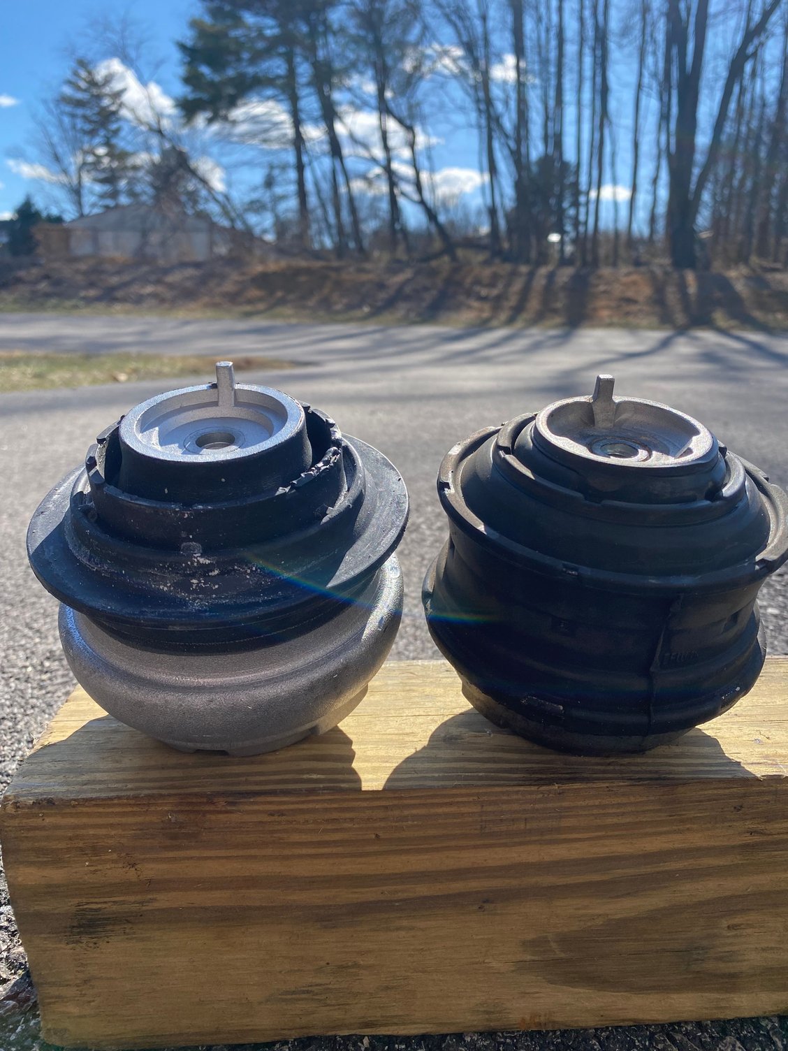

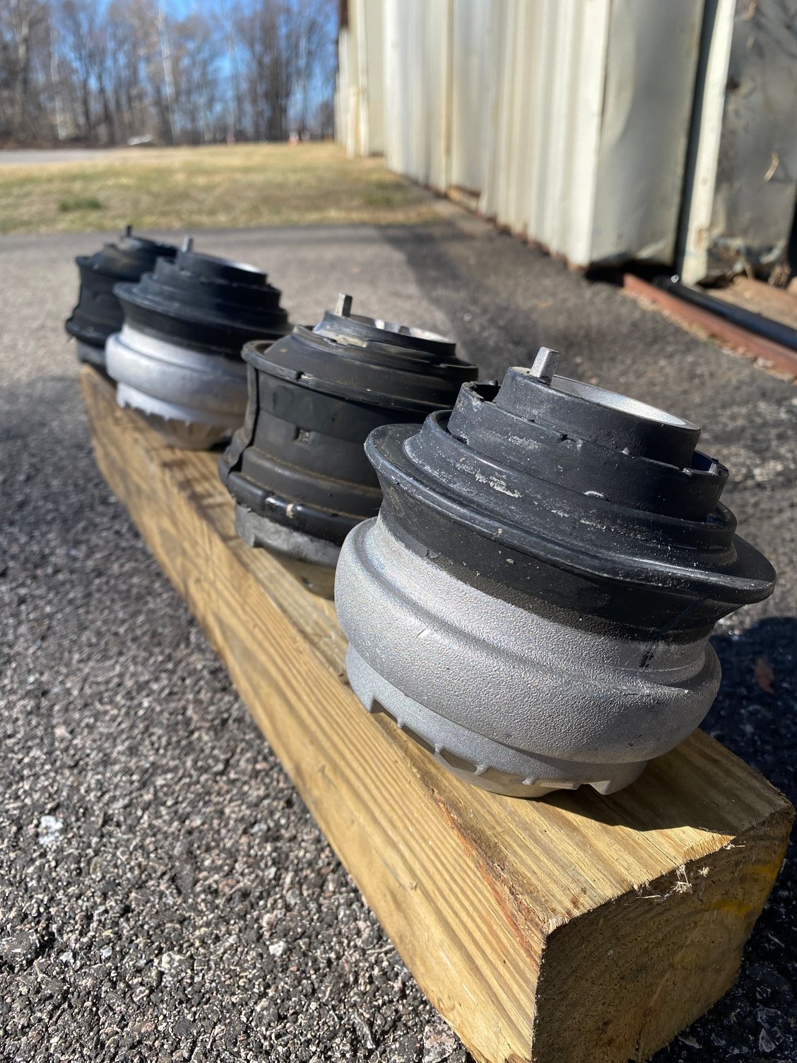

While waiting for the TCU to come in I was able to tackle another large maintenance item today, Motor mounts.
Everything on this car is Easy and Hard. Took me every bit of 8 hours. The old mounts were not torqued down as the top bolts came out with barely any force. The small 16MM wrench you can get off of the Jungle site was certainly a big help, however i would strongly recommend a short 16mm ratcheting wrench, due to only being able to turn the driver side top bolt barely a quarter turn each time. Swinging over to the passenger side top bolt was a real pleasure even tho that wasn't very easy either, but you can get almost a full rotation. ABC pump and lines are in the way on the driver side. Also a borescope is a HUGE help.
Drop the entire Steering rack bracket for this one, and push it back towards the rear of the car as much as possible. It's tight, but you can swing both mounts in. Also, jack the engine up high. I had a board that was too long, only allowing me to jack the engine up flush with the front crossmember. Scrapped it for a short piece and got much more clearance for the mounts. Old mounts were collapsed and I've noticed the engine sitting up a little higher now. Dip stick is not hitting my split cooling tank any longer which is nice.
Next up is to rebuild both valve blocks and figure out what i'm doing regarding the headlights. I won't be able/willing to drive the car at night with the driver side beam flickering on and off.
Really Looking forward to a warm spring day here soon when i can spend a full Saturday/Sunday on a proper detail. The entire underbody and engine compartment is so filthy from that oil line that burst, it needs a deep clean.

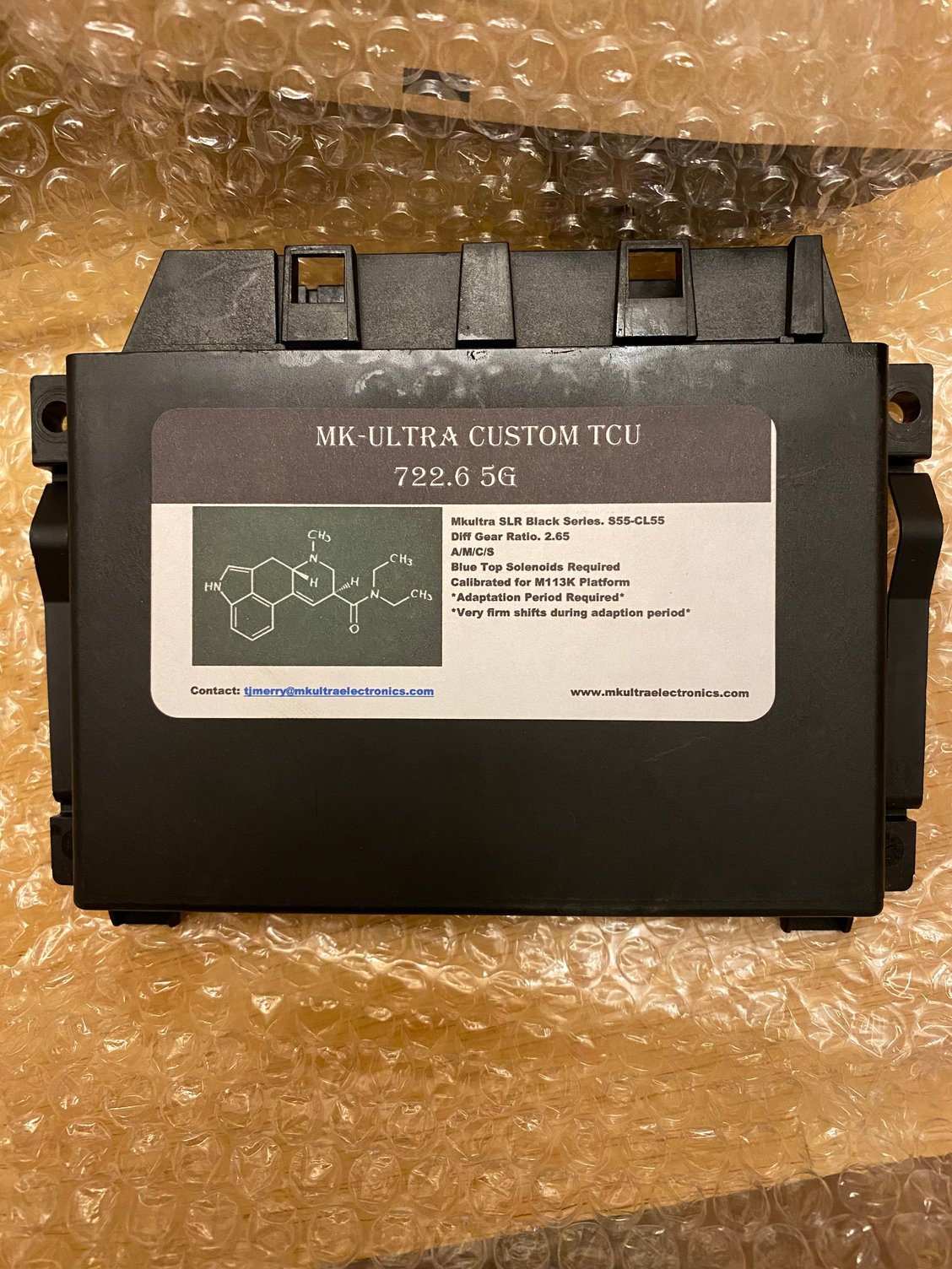

MK-Ultra TCU came in today and I was able to install it. Everything seems back to normal and it's running and driving great once again.
I went through the Adaptation process then took it for a good 20-30 mile drive up the highway to stretch its legs and get some fresh V-Power Shell Fuel.
Shifts feel much faster then before. Got into it a little bit but nothing crazy, as i think the TCU is still in its learning phase.
One major benefit I've noticed which was outlined in the Overview of the tune was the faster downshifts related to throttle response. Light input in the Go pedal and she's dropping a gear much sooner then before, which i like. I believe i was driving in the A "Agility" mode.
All other selections seem to operate as they should. I'll have to mess around with Full Manual mode which holds the gear once i drive it a little more.
Overall very happy with the Tune, Thanks for the recommendation!
She's filthy, but Damn it sure feels good to be back in the driver seat enjoying this car once again. I'm still getting vibration in the wheel and the overall feel of the car that i'm going to have to narrow down. Could be tires, could be the driveshaft rubber donuts, could be the carrier bearing, not sure just yet. However the motor mounts made a big difference.
Lastly, It still doesn't feel like its running 100%. I think i might have a Vac leak coming from somewhere as theres just a slight hesitation both at idle and quarter throttle. It's not bad but certainly noticeable.
- Joe

Good stuff Joe.
One thing you might notice but not recognize is now you can make double downshifts (4 to 2) with two clicks on the steering wheel. Stock would impose a delay which most TCU tunes do not. I enjoy that.
Also, do the pedal hold reset while in ACC mode (key turned, dash lit up, engine not running), to help the TCU marry up with the ECU. That'll get you your 100%.
If you had a vacuum leak you'd have a CEL. If you're running boost, run 1 step colder plugs to get your 100%. On a tune these things will absolutely lean out at high RPM (less than 100% power).
I pretty much only drive in full M mode, since I've owned the car, so I can't comment on what these TCU tunes do when not in M mode.
Enjoy!!

1 step colder plugs were installed, along with wires and coil packs which are all new. I'll have to take some time and narrow it down.
I did notice the 4-2 and 3-1 down-shifts, which automatically happen when i click the stick down 1 time. It will drop it in the lowest, best gear possible without having to hit it twice.
This was their "SLR Black Series" map which i believe they just released. It's been improved in a few different areas apparently.
First impressions are very good however. I think once it learns and matches the TCU it will be a real pleasure to drive. I'll likely be driving this down to Florida again come late April, and i'm sure that will do it some good.

Beautiful! Glad it worked out, and so far I'm incredibly impressed/pleased with their TCU Tune after driving the car a bit more. My absolute favorite aspect of the tune is the quicker downshifts related to throttle response. It really changes the whole dynamic of the car and makes it feel much less sluggish to get its *** up and moving. Not to mention the feel of a slightly more modern transmission.
Will you be tackling the job yourself or having it sent to a shop? As i said not a terrible job to DIY, but a lift would certainly make the job a piece of cake. What tune did you decide to go with, or which one comes with? I'm also curious when you pull your TCU if you see any signs of oil. Make sure to change that 13 pin connector while you're at it as a "while your in there" and forget about it type deal.
Let us know how you make out.

Joe, that's great! Glad it's exceeding expectations. Hopefully I'll feel the same! I'll probably stick with the stock TCU I got from them in November and I'm having the valve body swap done at MAG Motors over in Cleveland along with a long list of other tasks I'm sure they'll enjoy beating the hell out of my wallet doing. They're a Benz only shop with an owner who boasts the highest certification that MB awards, and both he and his lead mechanic are S Class owners (mechanic an S55) so things tend to get done right.
