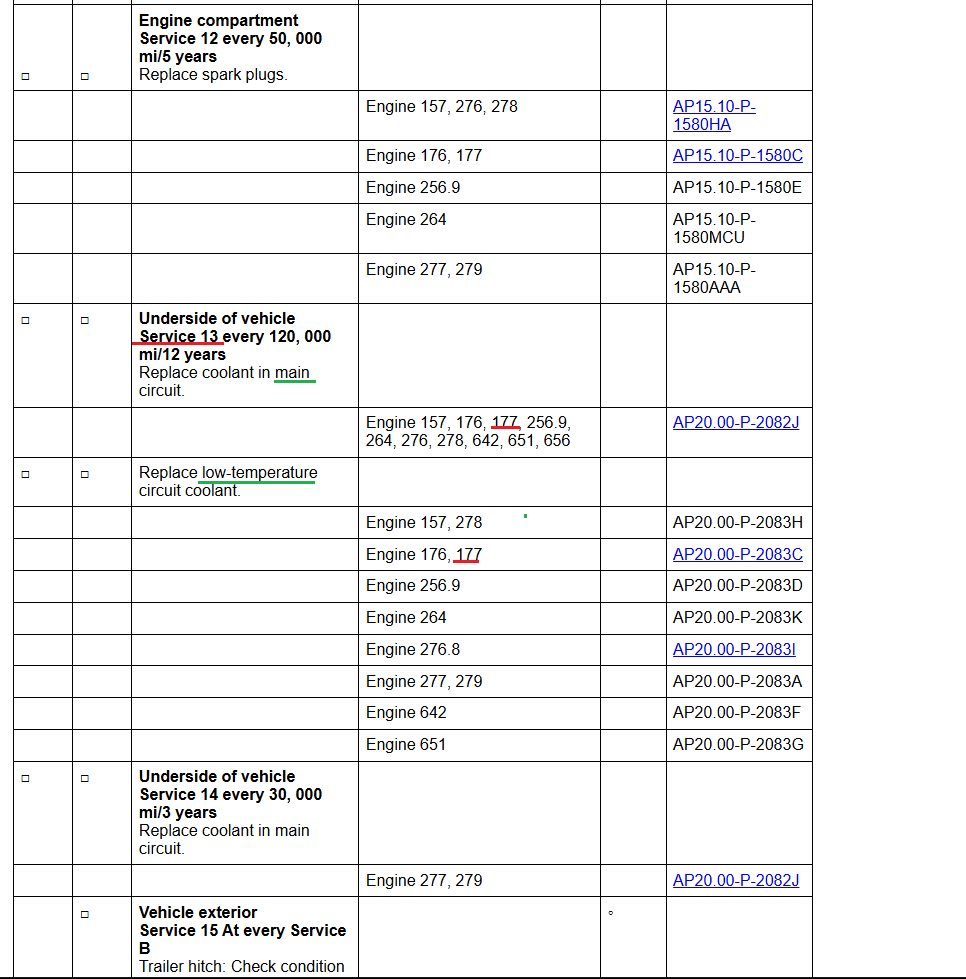

Told the service adviser to let me know if there are one or 2 coolant circuits and advise if they are changing the coolant in one or both prior to work beginning. He didn't. In the interim I did a little research and found out there are 2 coolant circuits. The normal circuit is for the engine. The low temp circuit is for the turbos, intercooler, and transmission. Same fluid for both but they do NOT mix, 2 completely separate circuits. So I got the call to pick up the car and asked on the phone if the coolant was indeed changed in both circuits. The service advisor didn't know. When I got there is when it got really interesting. Not only did he only change coolant in just one circuit, but he put yellow universal coolant (Trinity DK600P) in the car. I specifically told the service advisor to only use MB or MB approved fluids beforehand. I got mad, really mad. Long story short, they agreed to drain that out and use premix Peak Anti Freeze.

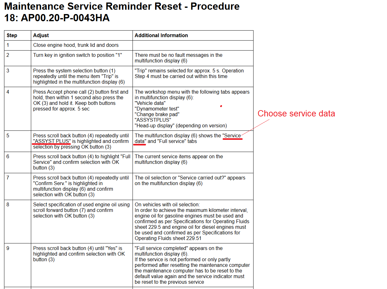

So in researching this, my conclusion is to wait at least 10 years before changing coolant. Why? Because it's designed to last 15 years, and it's more than likely that when something else needs to be changed the coolant will be changed at that same time. I've attached the service procedures for both coolant circuits. I'll DIY this procedure from this point forward.

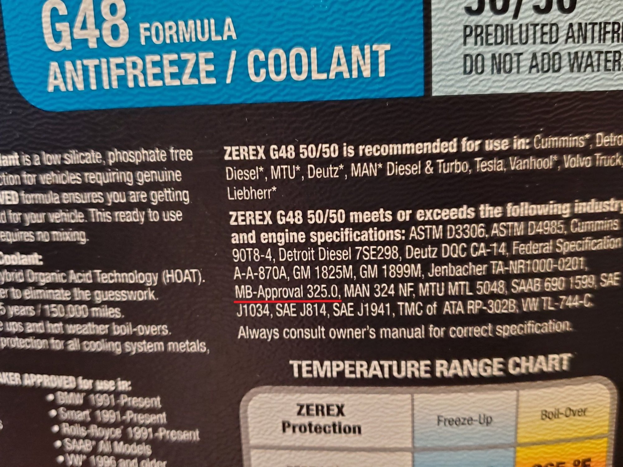

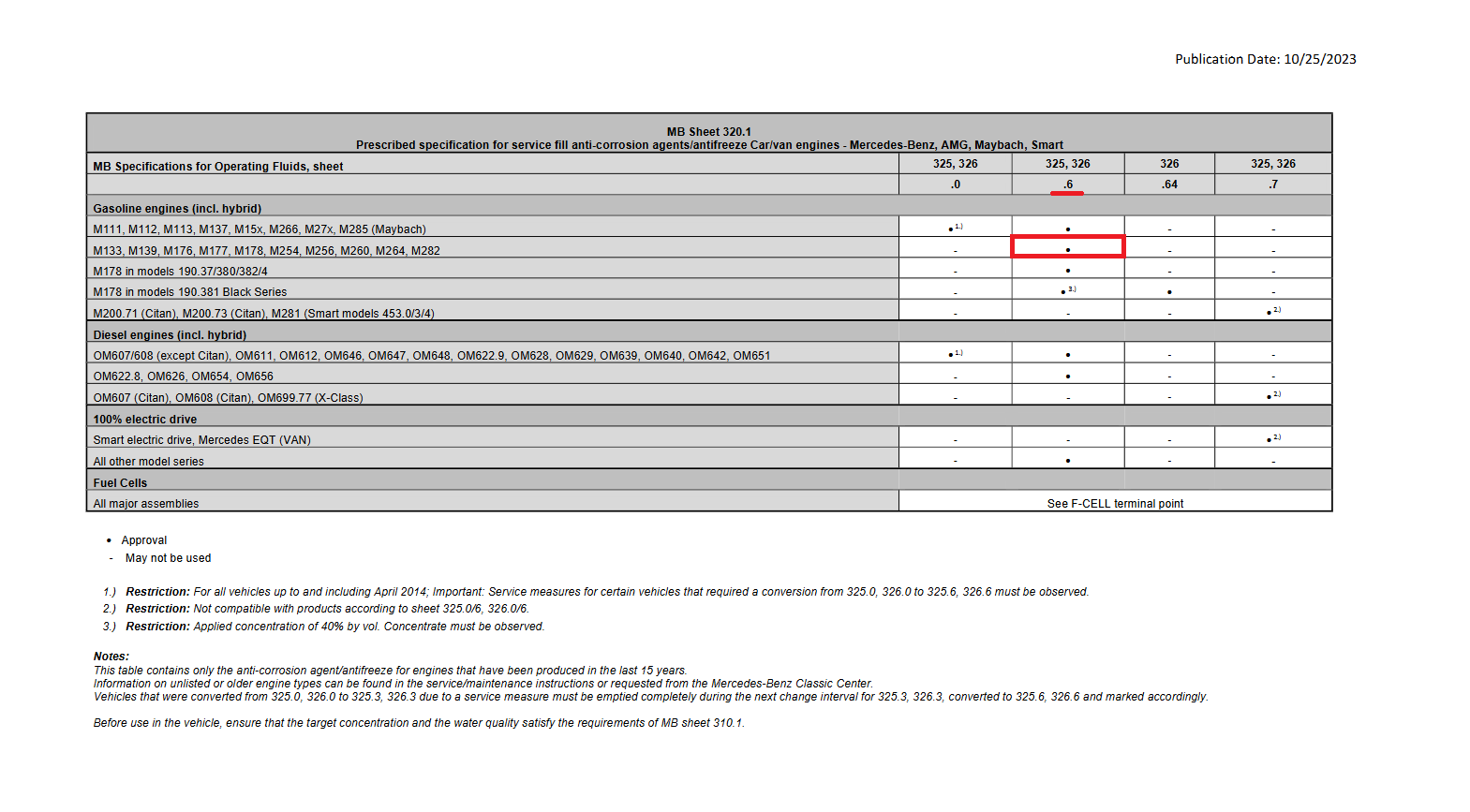

Coolant spec for the M177 is MB 325.6. Zerex G40 meets the spec and is commonly available. I always buy the 50/50 premix since my tap water isnt the best and demineralized water isnt common locally to my knowledge. I searched around for info on Peak and do not see the MB approval on it. I only use fluids that meet the MB spec and have is printed on the label.

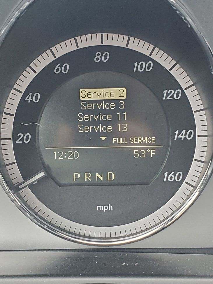

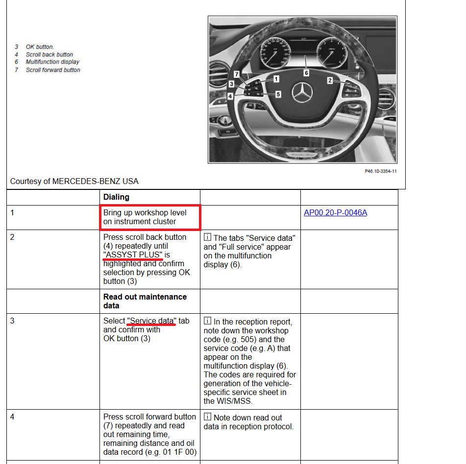

No harm in replacing the coolant ahead of schedule but theres really no need to. The recommended maintenance schedule should be in the Maintenance Manual that came with the Operators Manual in the glove box. Also the car will tell you what services it needs by going into the ASSYST Plus menus then read out the service code numbers. Coolant is service 13.

My W204 uses the 325.0 blue coolant. I buy the Zerex G48 50/50 and it has the MB spec right on the bottle:

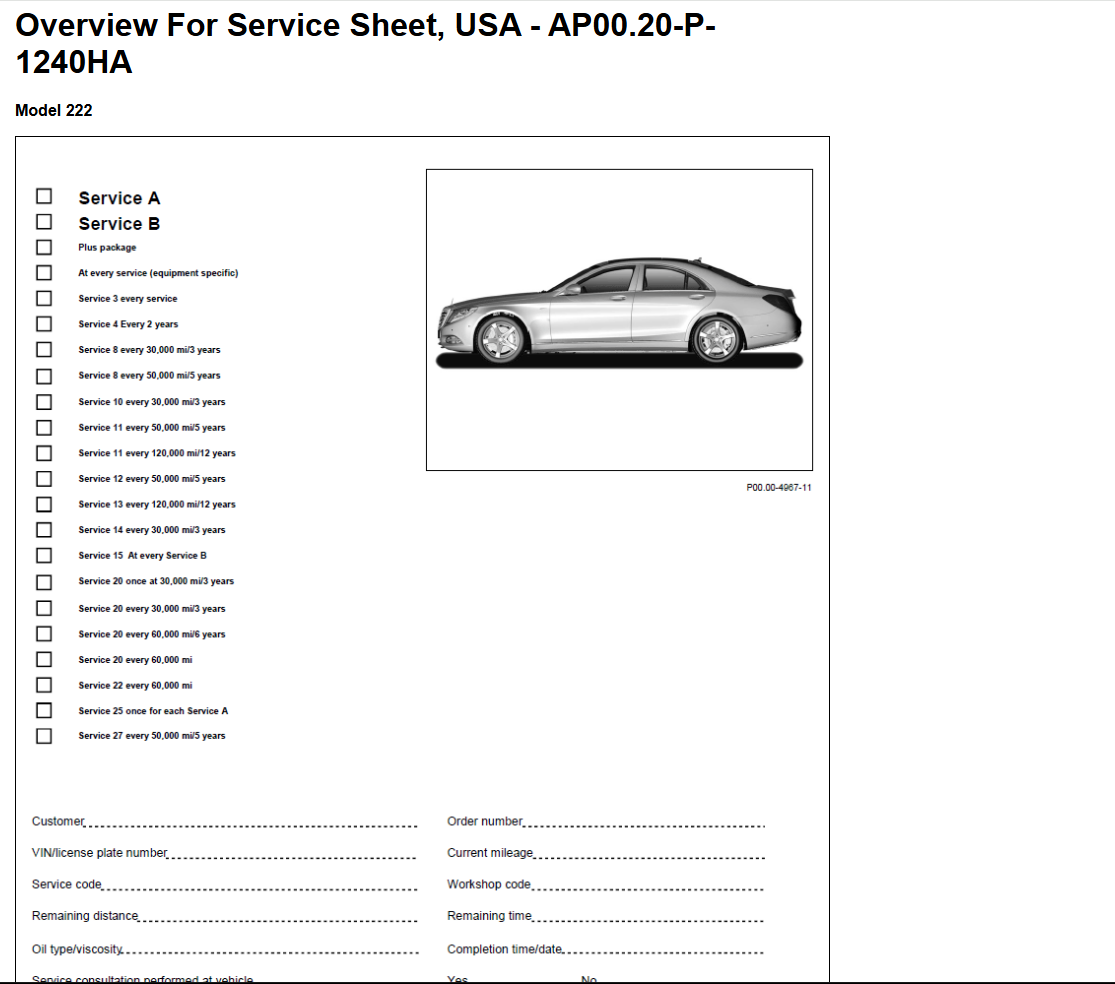

I was skimming thru info for the W222 and i'm seeing the recommended coolant replacement every 120,000 miles/12yrs. Could be the wrong one though since i just chose the USA spec.
My W204 came with a Maintenance Manual I go off of for servicing. Just to double check I will go into the ASSYST Plus menu when the dash shows service is due and I will match up the Service numbers and its always correct.
One of my last services said Service 2, Service 3, Service 11 and Service 13. Those services are service B, oil change, replace fuel filter and replace coolant. At the time my car just hit 150,000 miles and those services matched what the maintenance manual said.
Heres a link to the Service sheet i'm looking at: https://lemon-manuals.la/Mercedes%20...0.20-P-1240HA/
