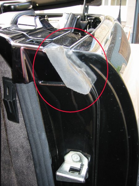

Can someone tell me what part number for this item. I canīt find it in my EPC and the dealer canīt neither. I need to order to do some replacement.

I asked about that item a couple of months ago and my parts guy did find it. However, it was very expensive (around 350.00 - 450.00 each if I remember correctly) as it has to be ordered with something else.
He also said that it would require quite a bit of work to change it out.
That little guy is where all of my wind noise is coming from on both sides. If you ever figure anything out PLEASE let us know. I wondered if there was a work around, but never came up with anything.

Can you ask your "parts guy" about the number. It would mean a lot to me. The replacement I put on the video

Okay here is the info:
129-690-41-30 $428.00 List $385.00 with my commercial discount
129-690-42-30 $428.00 List $385.00 with my commercial discount
