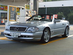

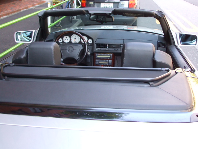

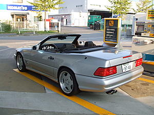

Welcome. Let me give you a brief rundown of my personal experiences. Keep in mind that everyone's experiences differ because of the prior conditions and driving/maintenance habits. My first MB was a 500SEC '87. Owned for 5 years and clocked around 70,000km. Absolutely no problems, was a great car. Next was a '91 AMG SL500, had some serious flaws cause the car had questionable history which I wasn't told and fooled (my ignorance and learning curve). Still, after fixing the problems w/ modest cost, the car performed well and I was able to sell it off w/ hardly any loss after several years of ownership. Currently, I own two MBs. One is a '94 AMG E60 (W124) since 1996. Absolutely one of a kind, keeper's car. Mind you, I am the type that do not drive hard and I do spend what's necessary to maintain the car is excellent running condition. Over the 12 years, the total cost is probably quite substantial, but they were all necessary wear/ tear and none were unexpected nuisances. The other car is your interested SL600 V12. Mine is a 1997 exclusive R129 and purchased it in 1999 w/ 7000km. It has around 80,000km clocked and the car has been an absolute pleasure to drive. The only major maintenance I had so far was an engine out job to replace a cheap rubber part (few bucks for the item), cost a bundle for engine out job. Other maintenances were routine wear/tear and nothing terribly wrong as you may have read in others' experiences. As you see, I have driven both SL500s and SL600s. Many claim that SL500 is better or enough HP, etc., which I do agree because that's how I felt back then. Prior to my purchase of SL600, I wasn't too keen on V12 for the same reasons that's going thru your brain. However, once you drive V12, there's no turning back. Different car indeed. Smooth, quiet as an electric car, flies like a jetplane, luxurious interior, and more than enough HP & torque for normal use, unless you are into bragging about numbers to impress others. Most likely, other negative reviews of V12 you hear are due to poor conditions/maintenances and driving habits. Another point to remember is that over the span of R129s 10 years model, the earlier models seemed to have had hearsay problems. The latter, late models had these electrical and other problems resolved and thus being "perfected" to be extremely reliable. So, the point is to acquire a late model V12 (SL600). That's my advice based on my personal experiences. Good luck in your search. w/ smiles Jimmy
Attached Thumbnails SL600 or SL500-dscf0306.jpg   SL600 or SL500-dscf0359.jpg   SL600 or SL500-dscf0356.jpg
