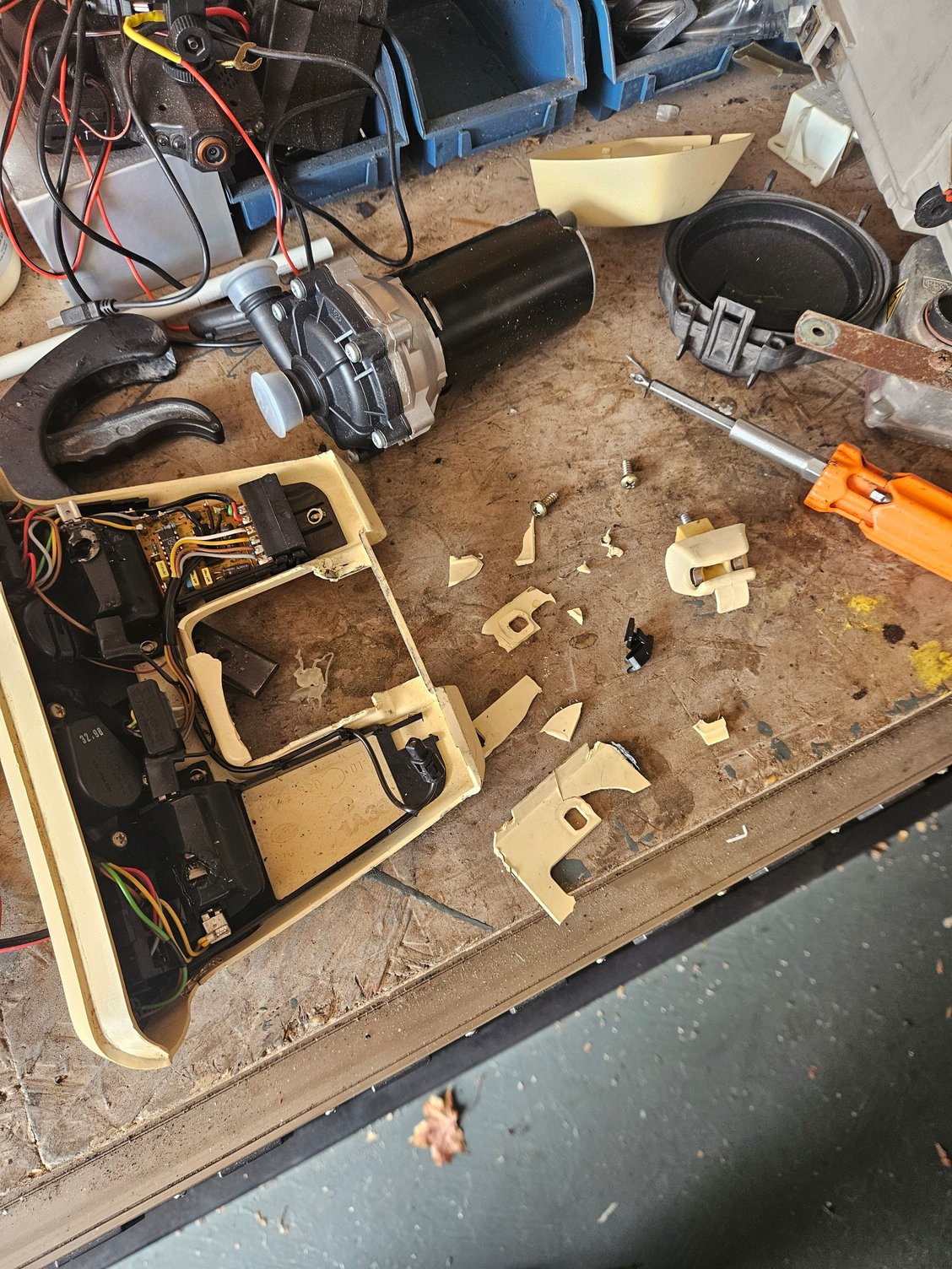

Got a lot of stuff done today. Replaced both the end caps for the sun visor rod (I've completely removed the driver's visor, it seems mostly useless), replaced all four front sway bar bushes, replaced both fog lights, installed missing splash guards, installed the tow hook cover (with the ugly but necessary ziptie insurance), installed the 10mm spacers on the rear, got a wind deflector, replaced the tonneau cover corner trim pieces, removed the silly DRL module that kept all the lights on all the time...we're getting somewhere!
Unfortunately while trying the troubleshoot the interior light switch last week, the overhead console piece disintegrated. I spent four hours plastic welding it more or less back together. It holds, but not very pretty. I really need to find the driver's mirror glass and inside trim triangle.
