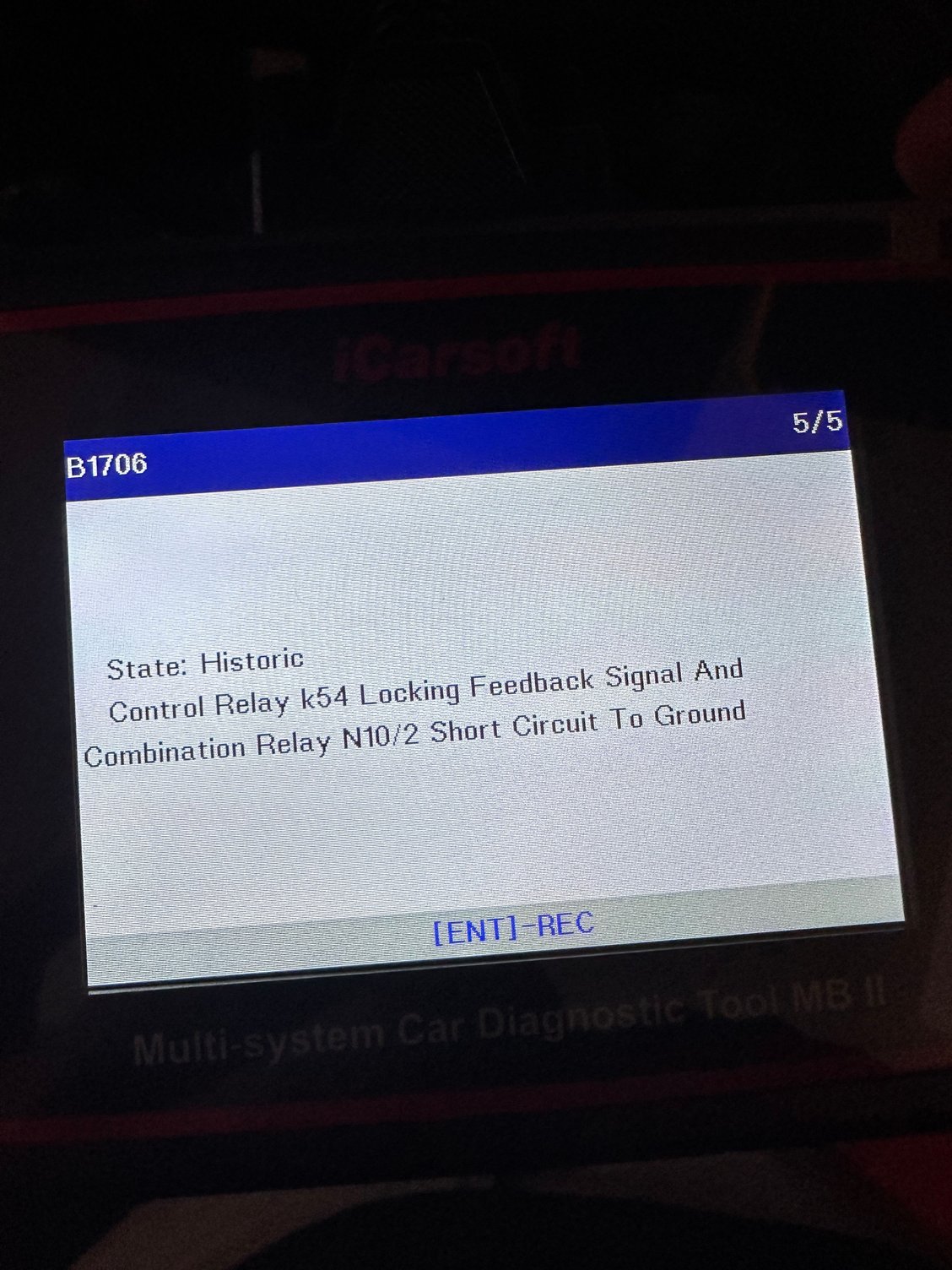

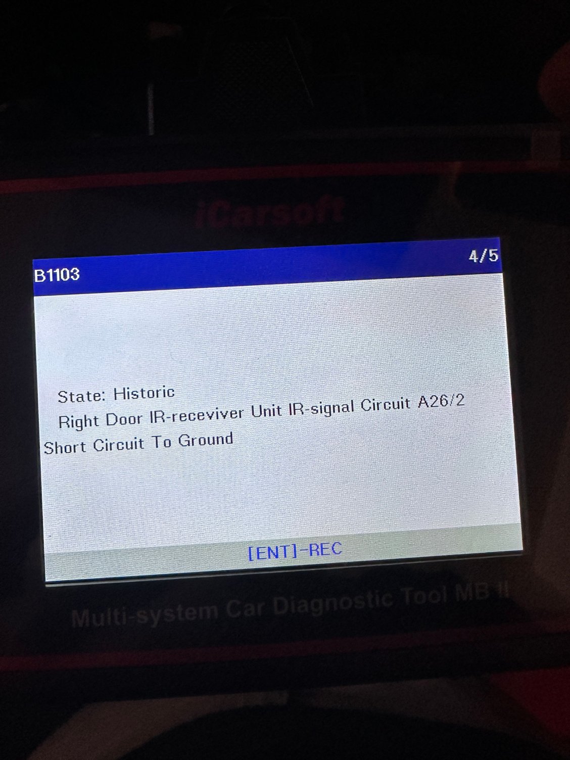

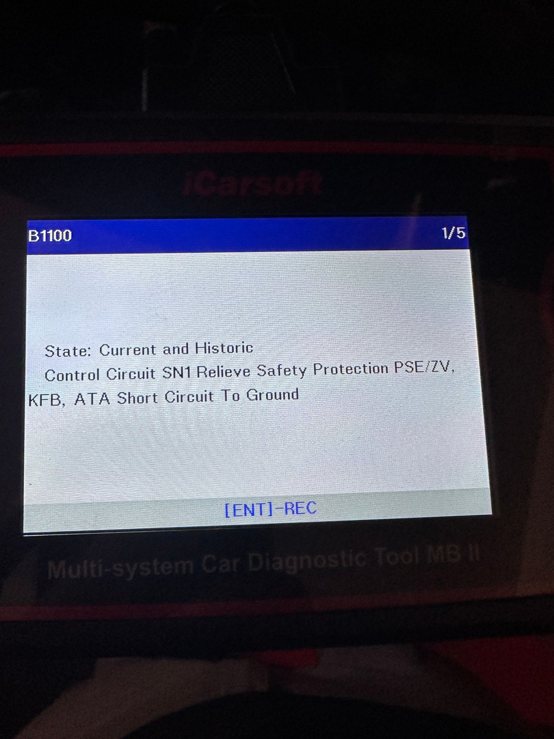

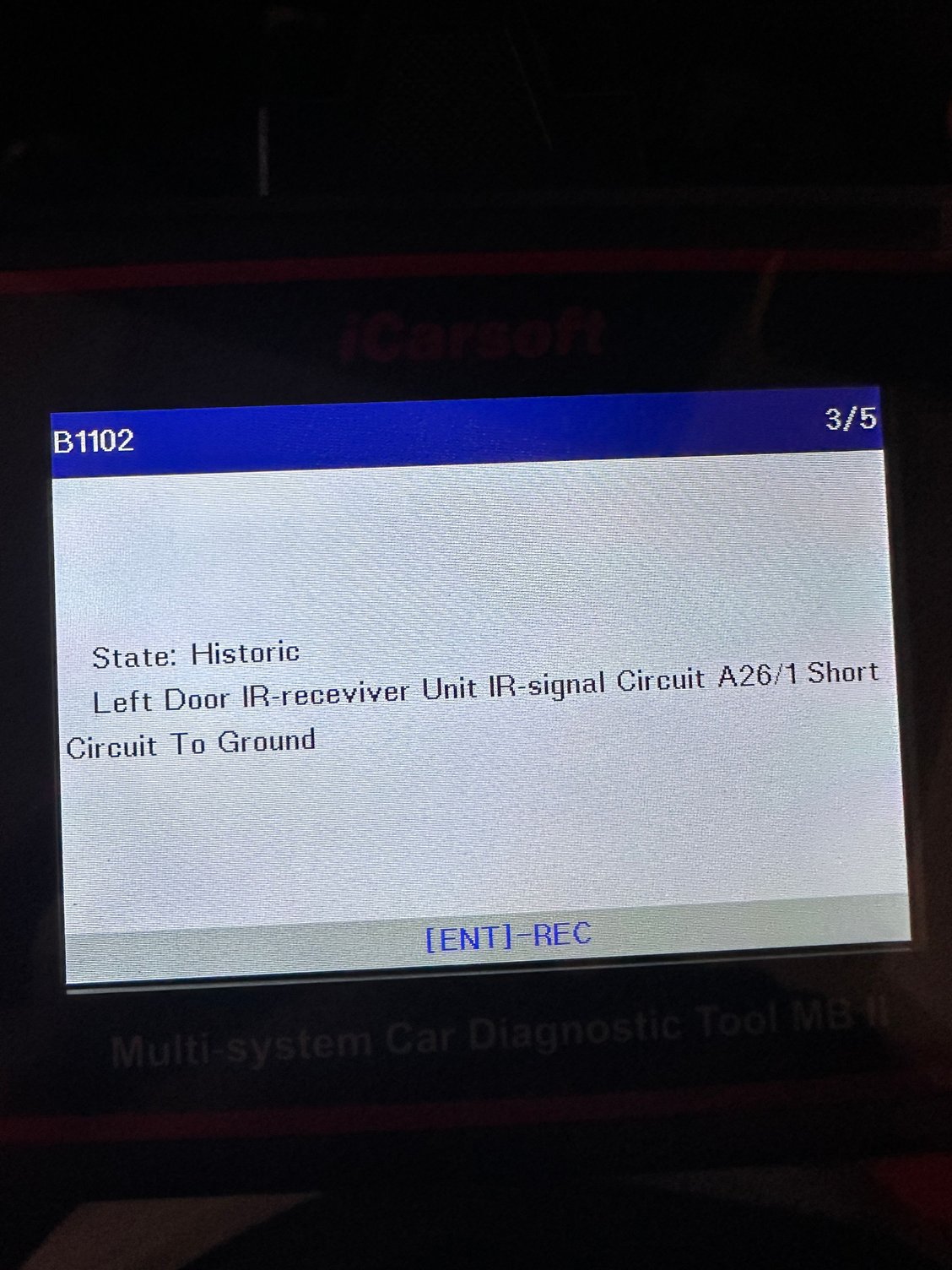

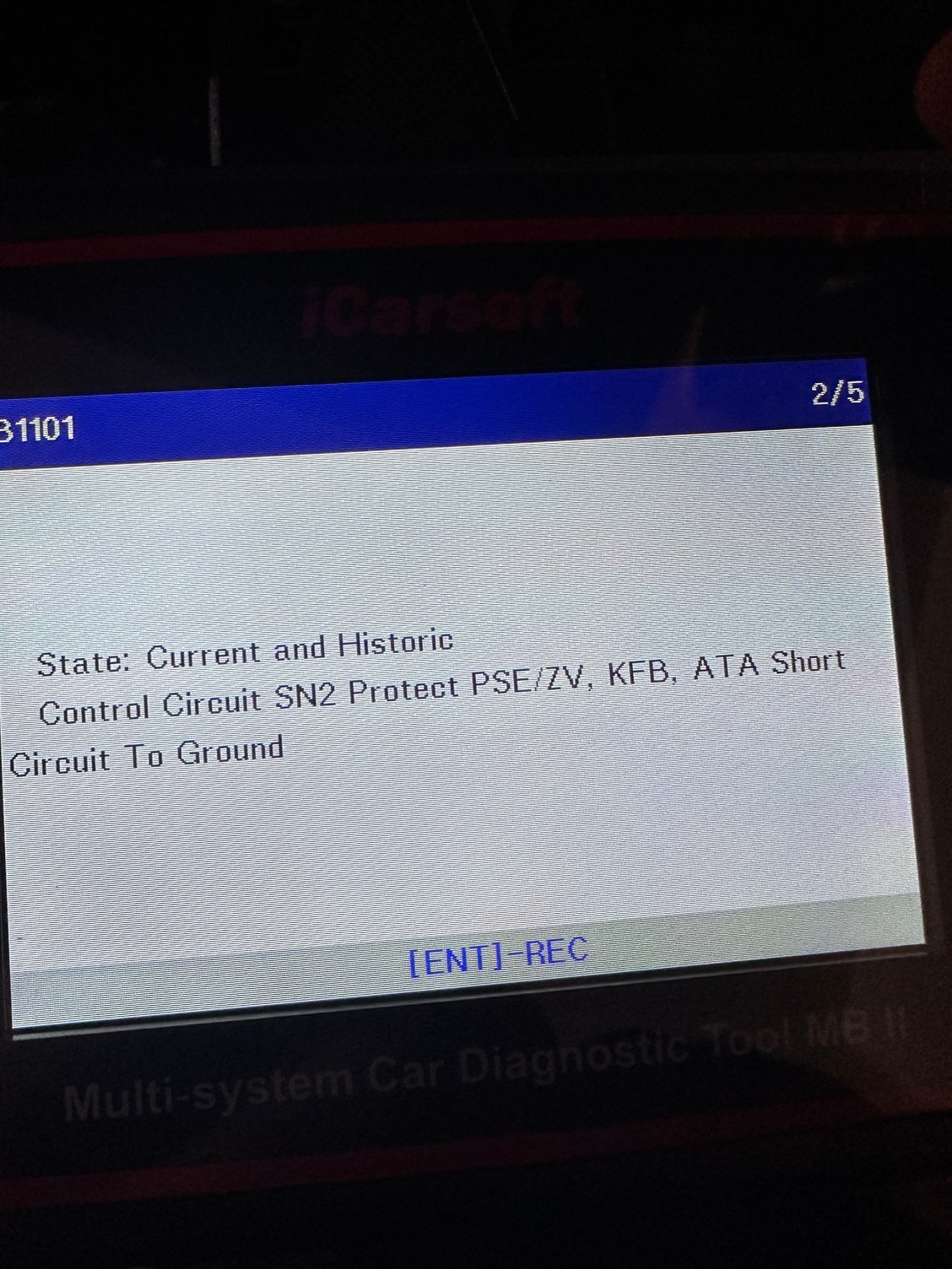

pump comes on a couple of times a minute for only a second or two when car is on, I disconnected fuse#5 in the trunk so it doesn’t blow
i opened up driver door panel to make sure the line wasn’t disconnected and it is definitely connected
trunk opens when I push the button on center console inside car
when I push unlock button from inside car I see the lock moving slightly on the drivers side. No movement on passenger side
pulled some codes with 38pin connector see attached
