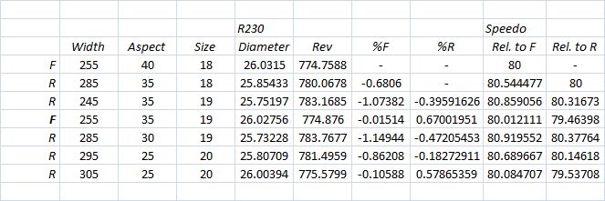

I have heard the programing differs as well.
What is your rear offset? ET30? I am trying to figure out what rear dimensions I want to build.
Here is the specs I have done for my setup (I may have to do a 20in rear if they don't make my wheel):
