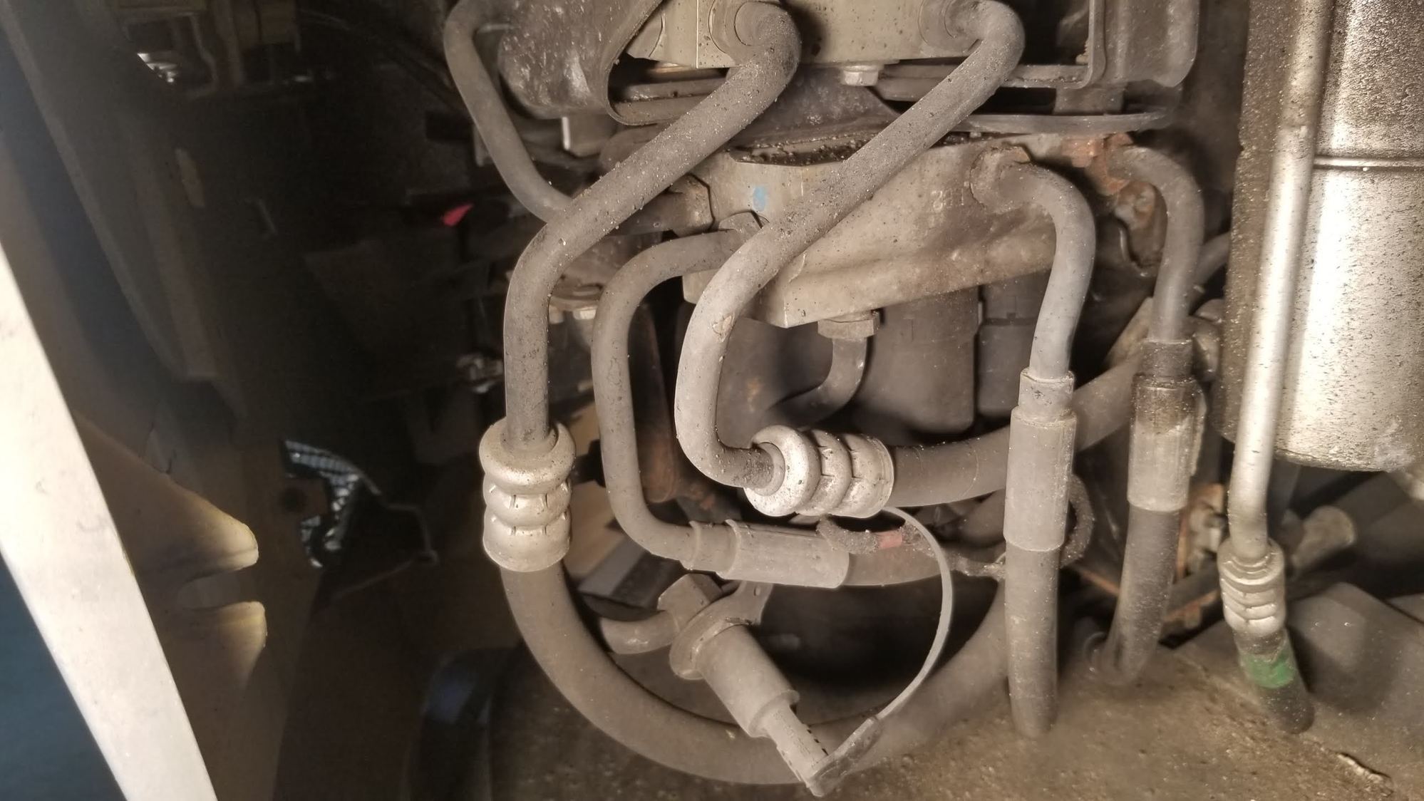

Resurrecting this thread. @danmm7
This is what I'm looking at right now (below). My right side is sagging, though it looks like FB1 is a little weepy. I'll address that next.
For now, what are the thoughts on the steps to remove the valve block? This is what I'm thinking:
  1. using my air compressor, blow the dirt away
  2. Remove pressure via the bleeder
  3. Remove the hoses to the block, looks like 5 hoses are connected
    1. T, P, SP, FB1, FB2
    2. Pipe markings: FB1 = left strut, FB2 = right strut, P = pressure line from pump, SP = pressure line to pressure accumulator, T = return line to ABC oil reservoir (reservoir).
    3. Image at http://www.hehlhans.de/sl55amg1/bild...il/puls0-a.jpg appears to show upper connections need to be removed as well
  4. I'm not sure which bolts need to be removed, or where the electrical connection is yet
Any advice?

Now I see why you removed the bumper, not a ton of room to work in there. I couldn't get the service bleeder to open, but it's been up on blocks for a couple of weeks it should be depressurized. Also didn't have a lot of luck removing the hoses, so I've sprayed with liquid wrench.
How difficult was it to remove the block?

I've removed FB2 and P as identified in these photos (not mine)
I've removed the upper left hose, I assume a return line?
The problem I have now is, the upper left hose does not stop leaking hydraulic fluid, so I've reattached it.
I'm struggling with FB1 and T. SP is starting to move a little. I'm just not sure what to do about the return line running. I wonder if I need to get that service nipple released.
Any advice from the board?

Isn’t SP just the hard line that runs from the valve block to the accumulator? I don’t remember having any trouble with it....but it shouldn’t even be necessary to remove to get the valve block
out of the car, right? Did you remove the accumulator mounting bolts?
look at where the hard lines are running:

My main issues right now are that it's difficult to remove the lines. I have a 17mm box wrench in there and without removing those upper lines it's difficult to get to the other hose connections. Additionally, they apparently haven't been moved in 15 years and 62k miles, so they're on there pretty good.
I found that overnight, fluid continued to leak, so I snugged up the lines that I had previously removed.

You need to be using a flare nut wrench.
I wanted a high quality one to avoid rounding off the nuts and bought a used one made by SK on eBay, part number 8815.
I also bought a snap-on 17mm crows foot flare used off eBay, part number FRHM17.
It was easier to get access to some of the nuts with the crows foot, which is why I recommend getting both.
I only replaced the accumulator, and did not remove the entire valve block or all hoses...but I did take off SP without any issues.

Did you ever remove the front bumper? It makes things at least 10x easier.
Removing the bumper is not hard and totally worth the time.
Just in case, use masking tape and label all the hoses/pipes, so you do not get confused later.
Wash everything with brake cleaner, (buy a few bottles) before removing connections. Dirt/dust is your biggest enemy.
Make sure car is lifted in the air.
Mark the electrical connections properly. Take pictures often so you can recall later where things go.
It's a messy job (but not hard) and fluid will leak from different places. Just be ready with the right rugs, towels, etc.
I did not release pressure from the lines. The car was parked for 24 hrs before i started the job and this was sufficient. It not run into any ABC fluid under pressure.
