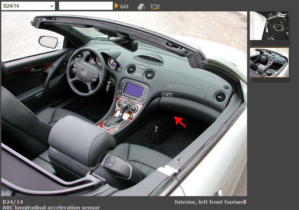

Mercedes' Starfinder application will show you a picture of the sensor so that you can determine its precise location. It can be had as a small download here. You will also get a complete set of wiring diagrams with the download.

Thanks for the info about starfinder that’s helped a lot,looks like it’s in the footwell and not under the seat So at least that’s thing I don’t have to take out 👍

Perhaps this picture will help, maybe on the same side for RHD and LHD?, if you need the WIS instructions, just ask.

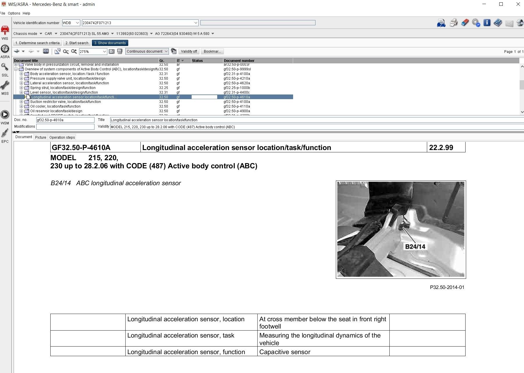

Hi DavidCA if you could send WIS instructions that would be great. I took the car apart today in the area shown above found a sensor got it out, stupidly ordered a new one through Mercedes main dealer only to find when I plugged obdii in it turned out to be the wrong sensor it was B24/12 not B24/14 (special order so no refund!) after pulling back the carpet on both sides of the car l still can’t find it 😩. Mine is right hand drive so I thought things might be reversed but no. so any help would be great.
Old Jul 2, 2020 | 06:28 AM
DavidCA's Avatar
Joined: Feb 2007
Posts: 118
Likes: 22
From: Aberdeen, Scotland
SL500 2009
Here is the location according to WIS
