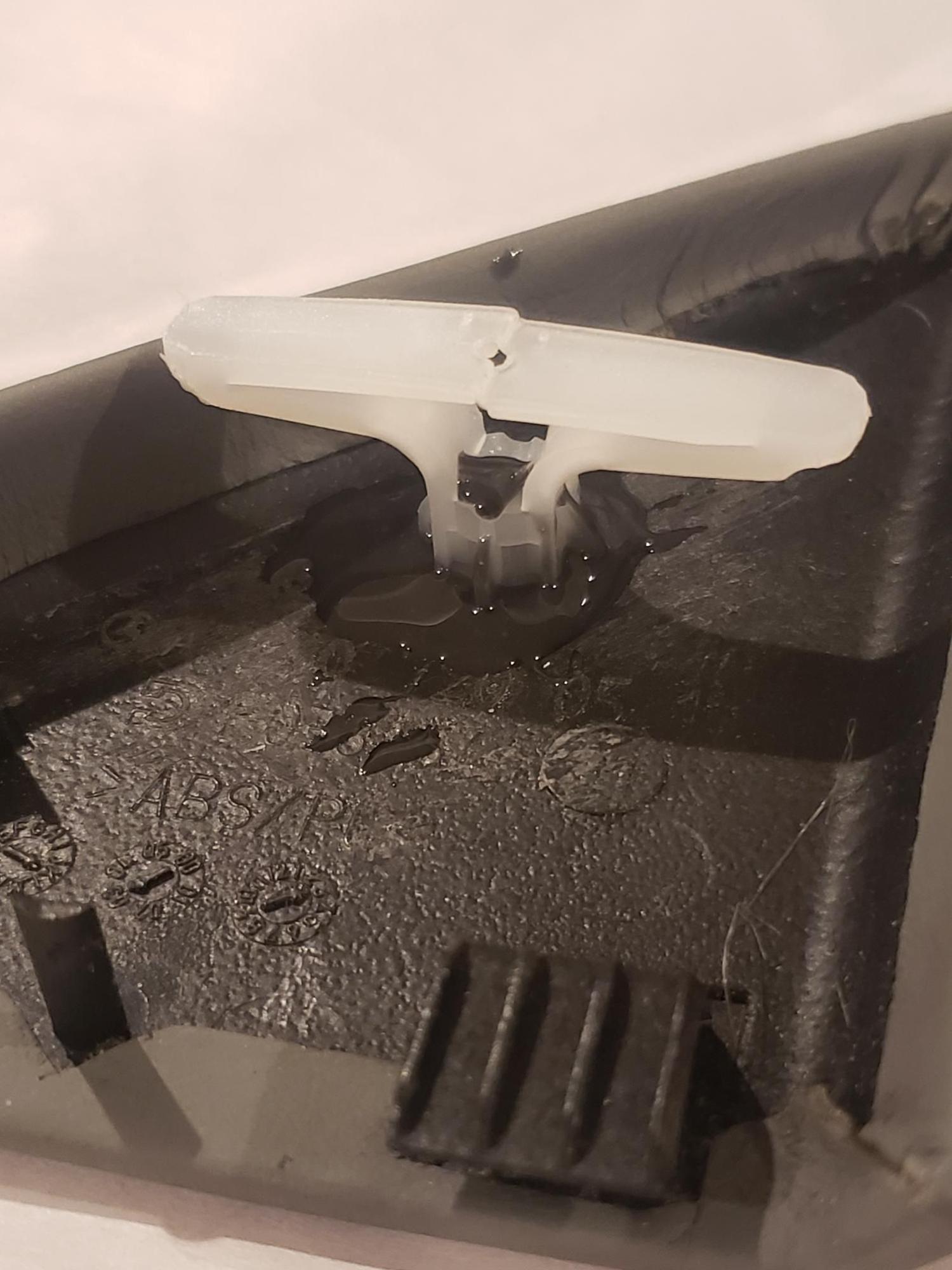

Purchased an 2004 SL600 a few months back and have been taking care of a several of these annoying design flaws.

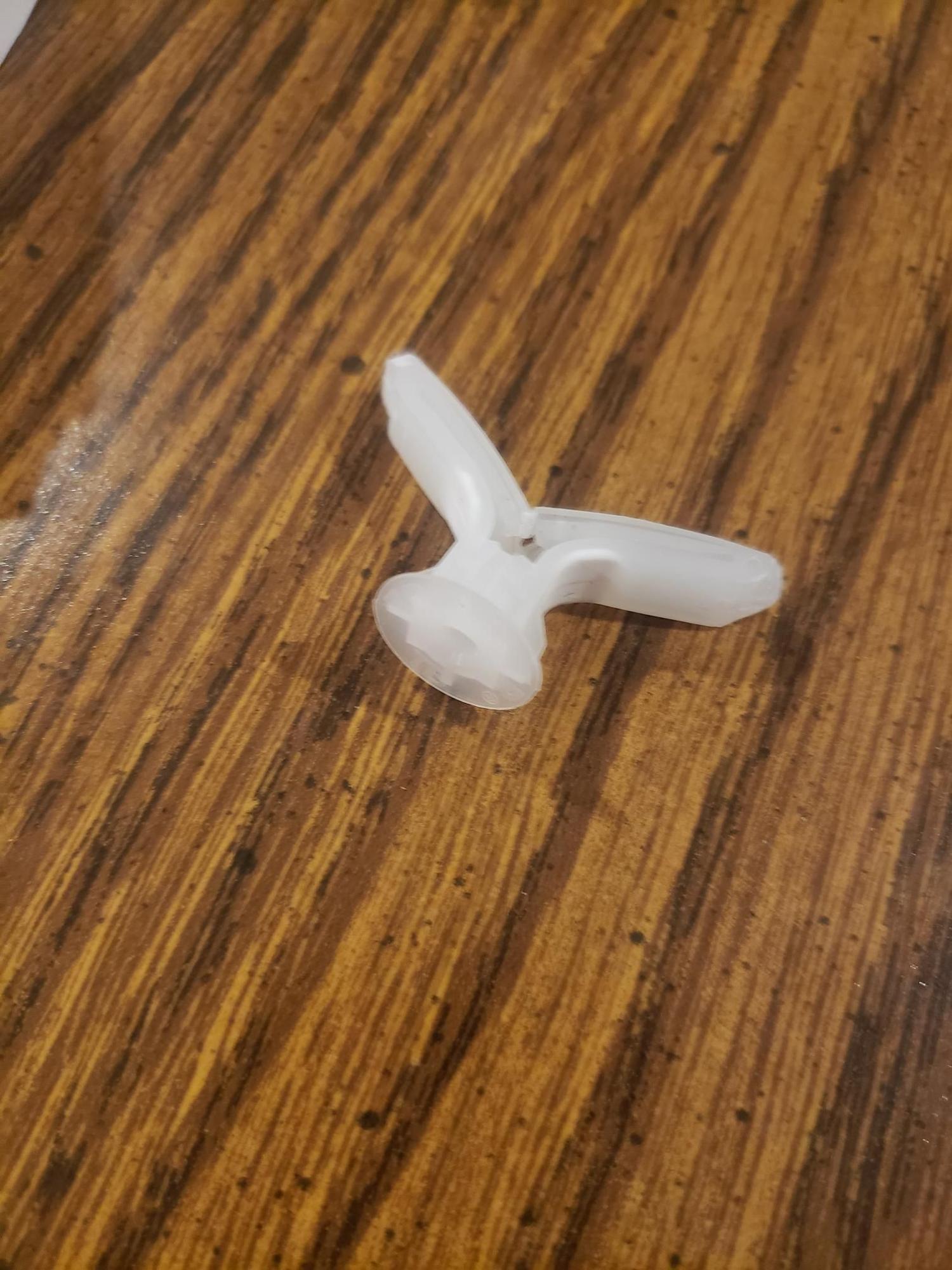

I too am a victim of this triangle trim problem, and came up with a different solution, employing a "Toggler", which is a simple wall anchor you can find on-line by doing a google search. This worked really well, and still allows the trim piece to be easily removed. You need to remove the white bushing before reinstalling the trim.
-D
The
The "Toggler". Using a sharp utility knife, I trimmed it about 1.5mm shorter to facilitate insertion. Also, cut away these little bumps on the wings, so that when it's time to remove the trim, the toggler slides out nicely.

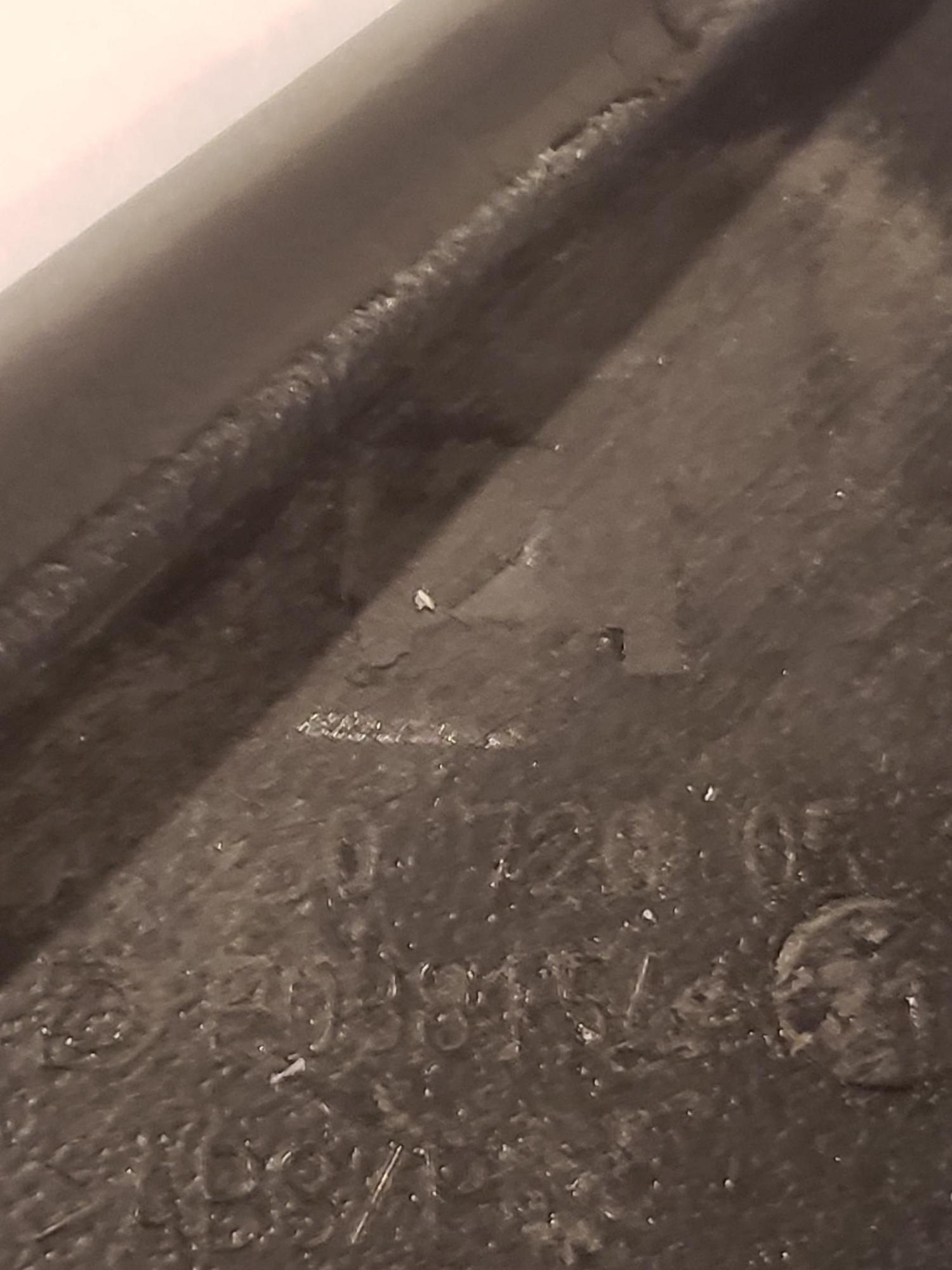

Before attaching, I trimmed away the original clip, and sanded flush with #100 sandpaper.  Make note of the horz and vert position for the next step.
Using our favorite JB Weld, I affixed the toggler right in the same spot of the original clip. Once hardened, spread the wings together for insertion into the rectangular hole in the door.

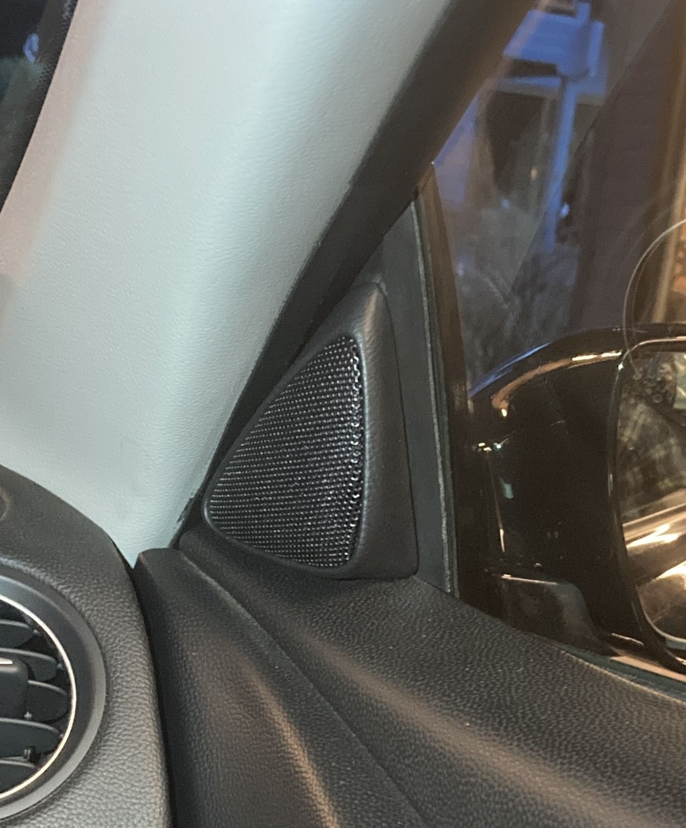

While still maintaining my NTG-1 I tackled two issues. My leg obscures the treble from the door speaker sound, that isn't too crystal clear to begin with. Plus the tweeter pod isn't likely to come off like the OEM trim piece, as it's tailor made and secured with a strand of butyl. The sound did improve. Not spectacularly, but it's a win-win. And the fumbling was fun.
