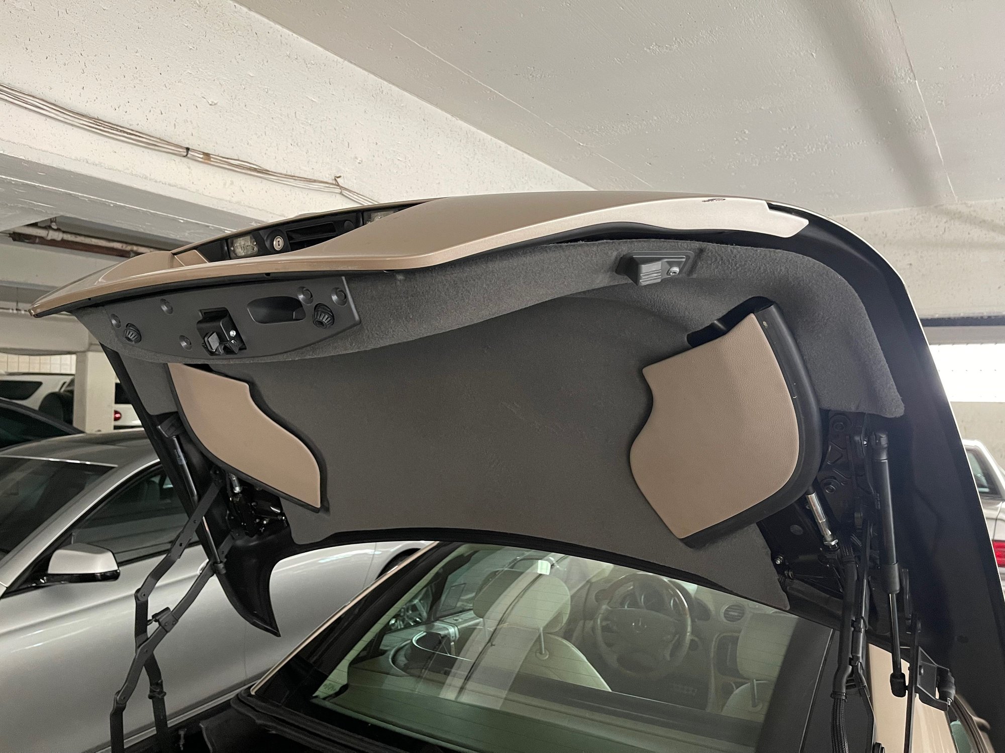

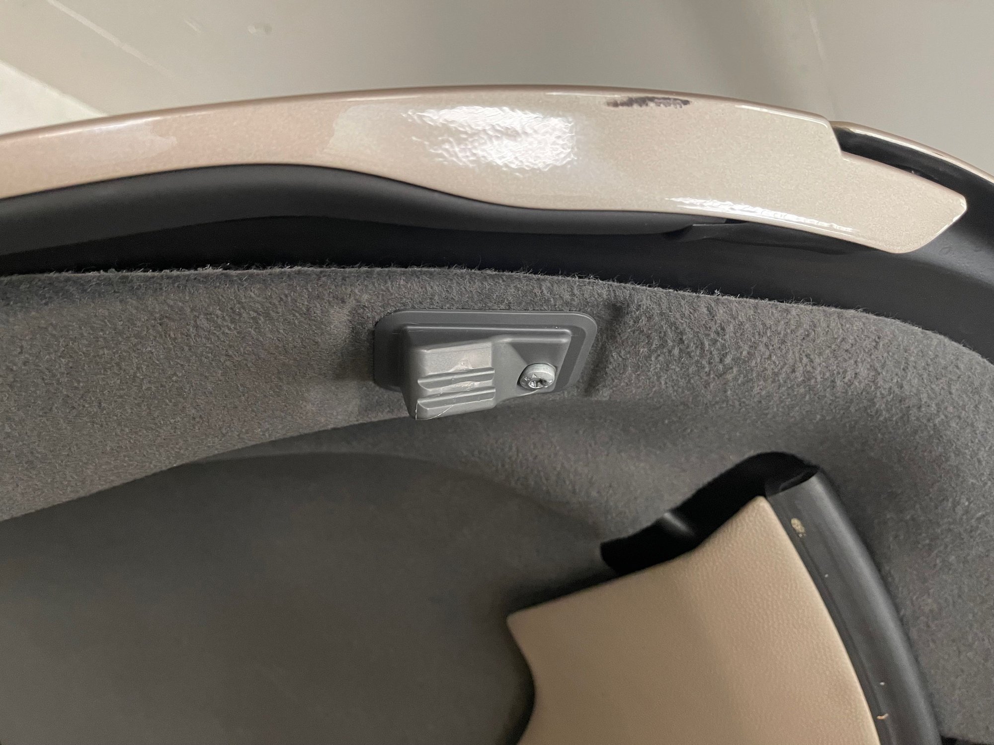

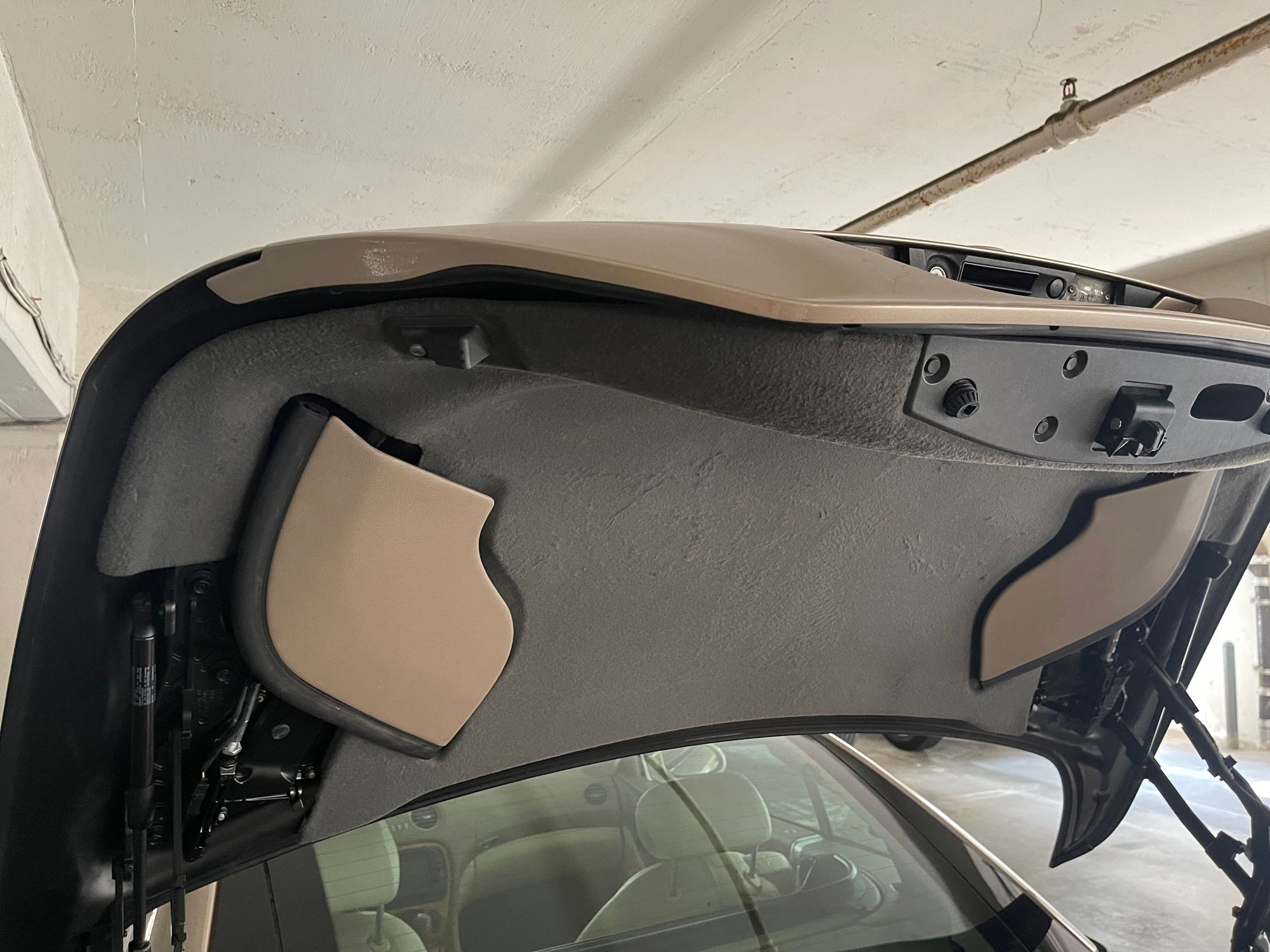

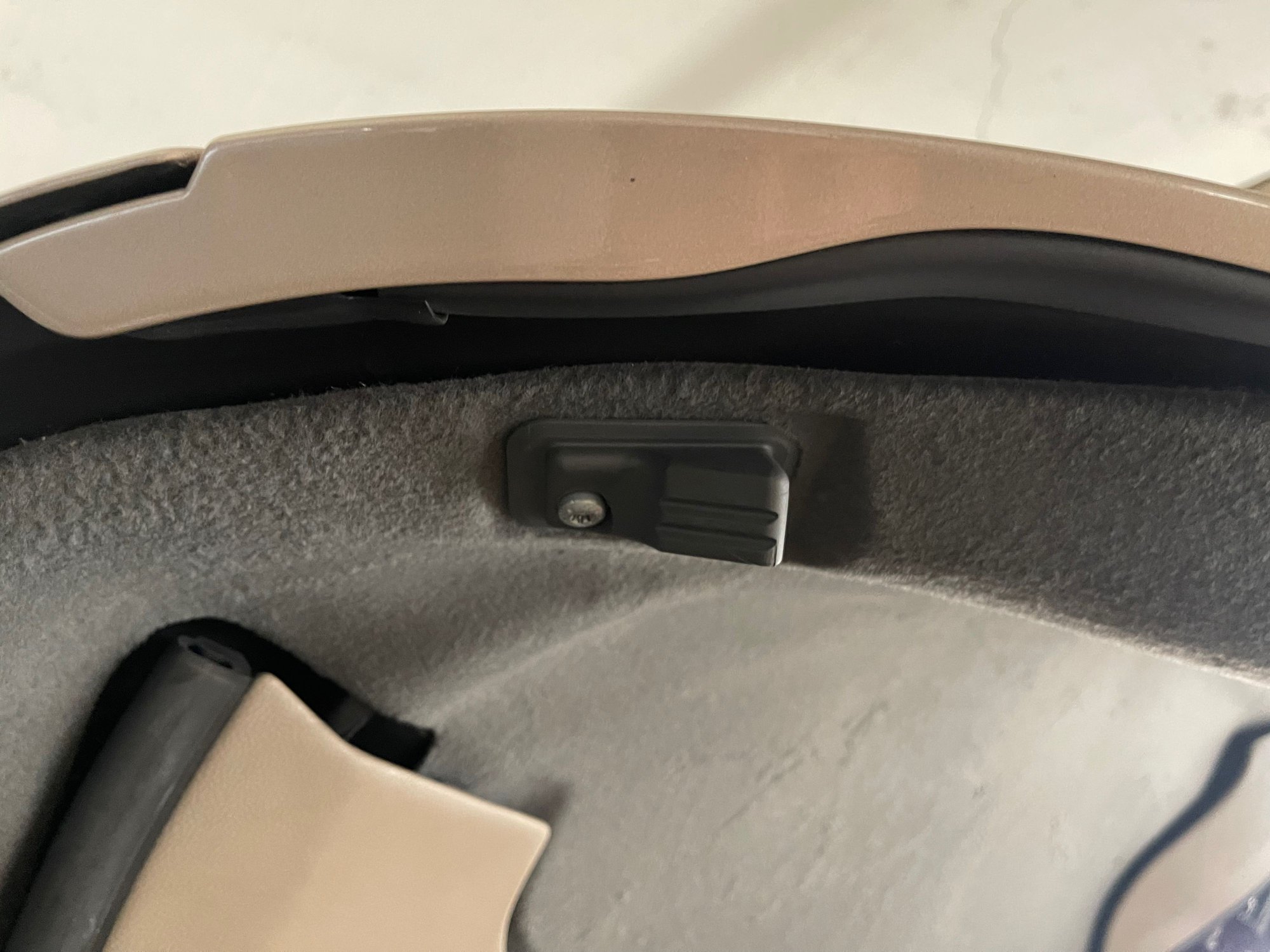

Hello everyone,
Very proud new owner of an '03 SL500, been going through sorting a couple of the little issues it had and started with the soft close trunk. The old latch was leaking so I bought a brand new one from Mercedes Benz, and all went well with the installation except for a little confusion with the trunk strikers.
It looks like someone had already had a go at replacing it before and reinstalled one striker in the wrong orientation - so putting it back together I had to guess. I could tell from the part numbers which side each was meant for, but not which way around, and I'm concerned it may be causing issues with my trunk's closing fitment.
I've searched online extensively for photos of other 230s to find the correct orientation, but they all seem to have different types of strikers so are no help. If someone could tell me whether this is correct or if they need to be flipped that would be a massive help!
My big concern is that the new latch worked for about a week but the PSE has cut out again. The last latch was obviously broken at the puck, and the leak was audible, but now I can't figure out what could be tripping it. My only theory is that it might be the strikers stopping the soft close from shutting properly.
Thank you

I believe that is correct, at least that is how I install them. Once you have them on the proper sides, there is really only one way that makes sense. They are adjustable, so you might have an issue there. Is the soft close the only PSE function not working?

Something looks odd with your strike plates as they are missing the angle adjustments? (I took a photo of mine, you can see the line up adjustment marks)
With that said maybe you do not have that level of adjustment on your model, if you look at the strike plates they are labelled L and R respectively, so check you have them correctly but leave them loose to allow for adjustment. You can use some masking tape or similar to see what part of the plate is touching when you close it as it will leave an imprint, then adjust accordingly.

I have seen your version of the strike plate everywhere, which is why I was having an issue determining the orientation of mine. Mine offer no adjustment and have no identification as to whether they are L or R (only by model number).
