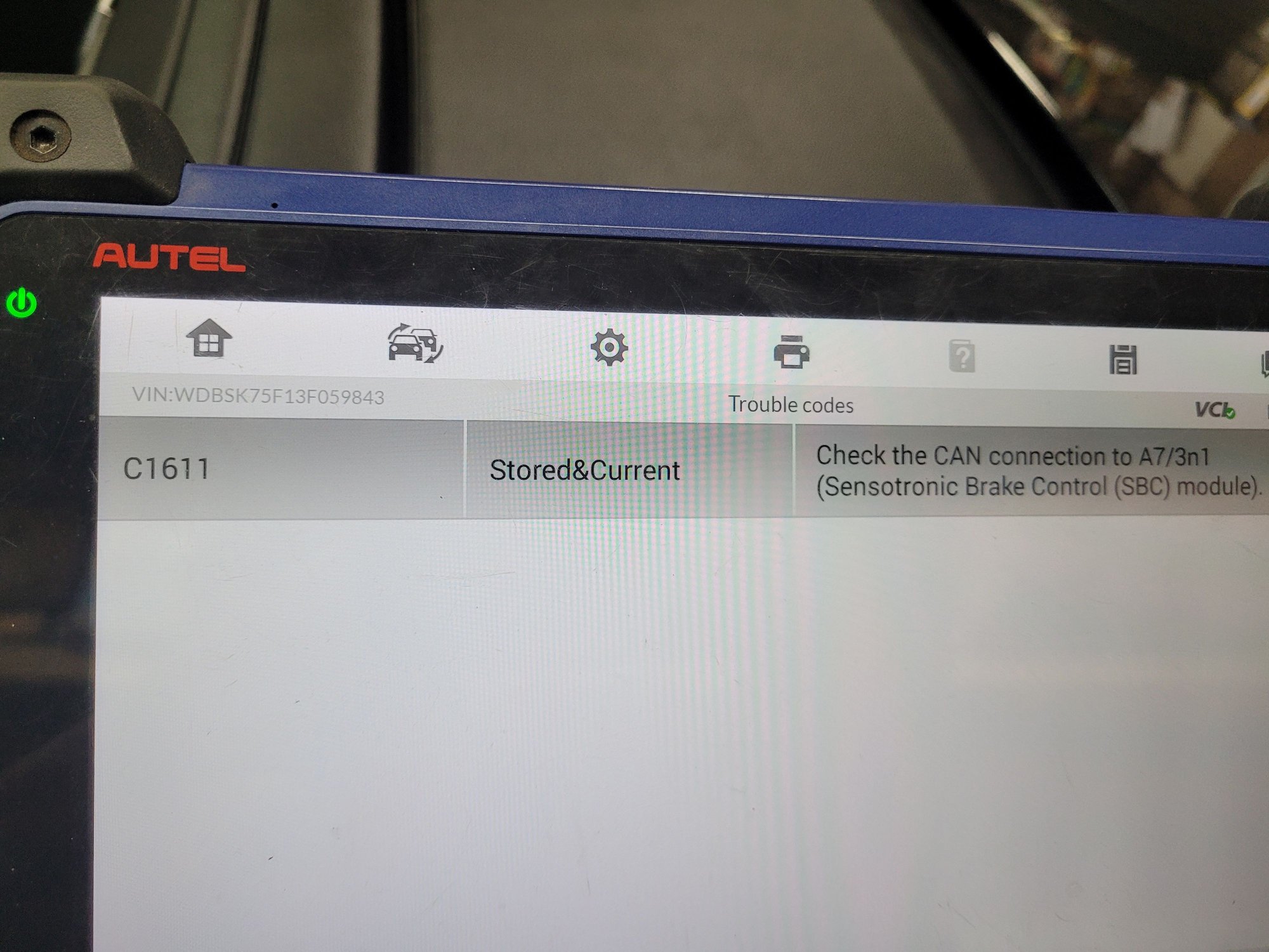

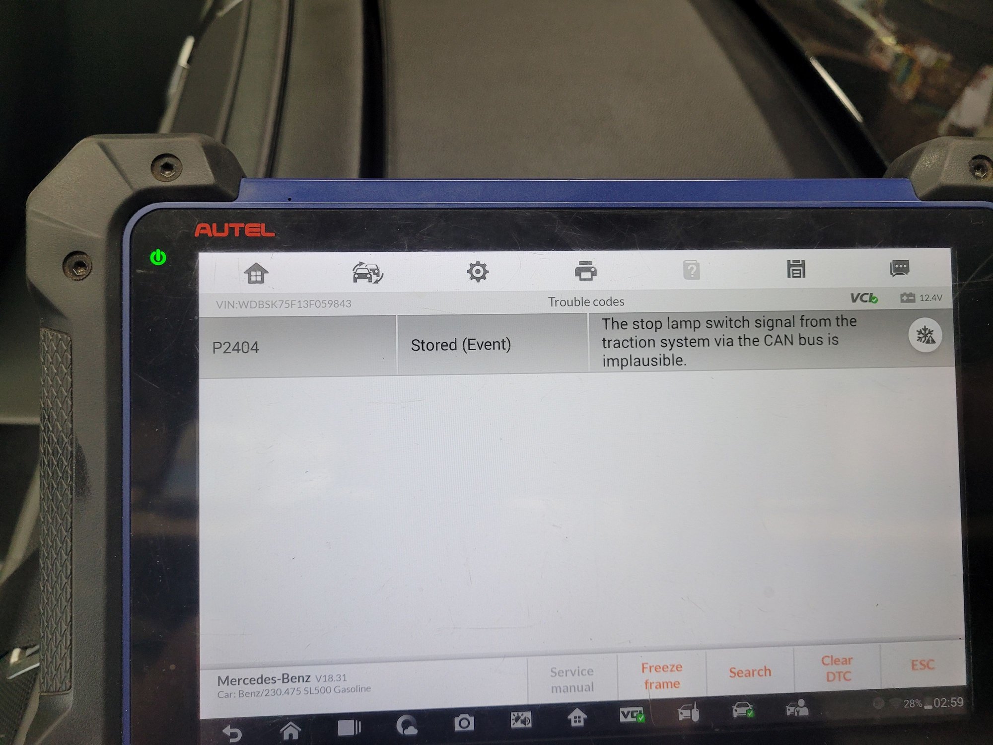

All those random faults point in the direction of faulty corroded connections in the CAN BUS loop.
Check your connectors , especially the one under the carpet, passenger side for corrosion.
