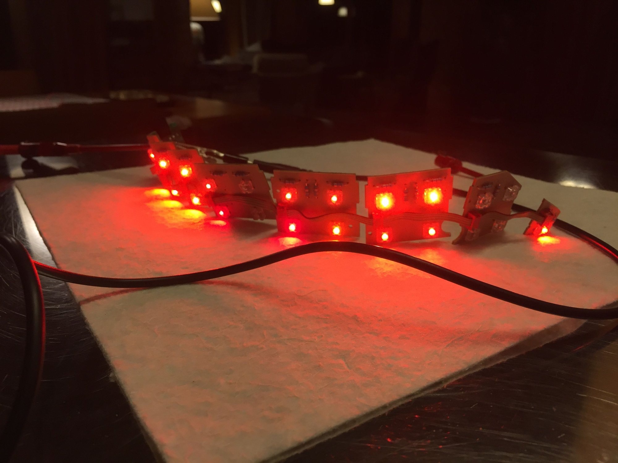

Your brake lights are leds that also serve as tail lights. Both left and right failing on the same day seems to be a bit of a coincidence, but I suspect you got water in the lamp housings (alternatively, perhaps a short on one side (after water ingress) triggers an electronic signal that cuts out both sides).
If you have water or moist in there, I would dismount the housing, dry thoroughly, clean connectors and reassemble, making VERY sure the thick gasket is seated perfectly. Broken leds can be individually replaced. Note that testing the strip of leds should be done at 2,5V not 12V.

I can't answer all your questions. If I remember correctly the strip with leds has one connector to the assembly, the assembly has one connector to the loom in the car. So that is where you to would want to check for shorts and/or corrosion. If you managed to see if all leds were flickering simultaneously then I would suspect the led strip itself to be okay. A simple scanning tool should tell you more about he reason the car switched to substitute lamps. The substitute lamp is you fog lamp. I don't know how the car manages to emulate tail lights and brake lights with it, probable by varying intensity (you'd see that in your mirror, standing close to a wall).

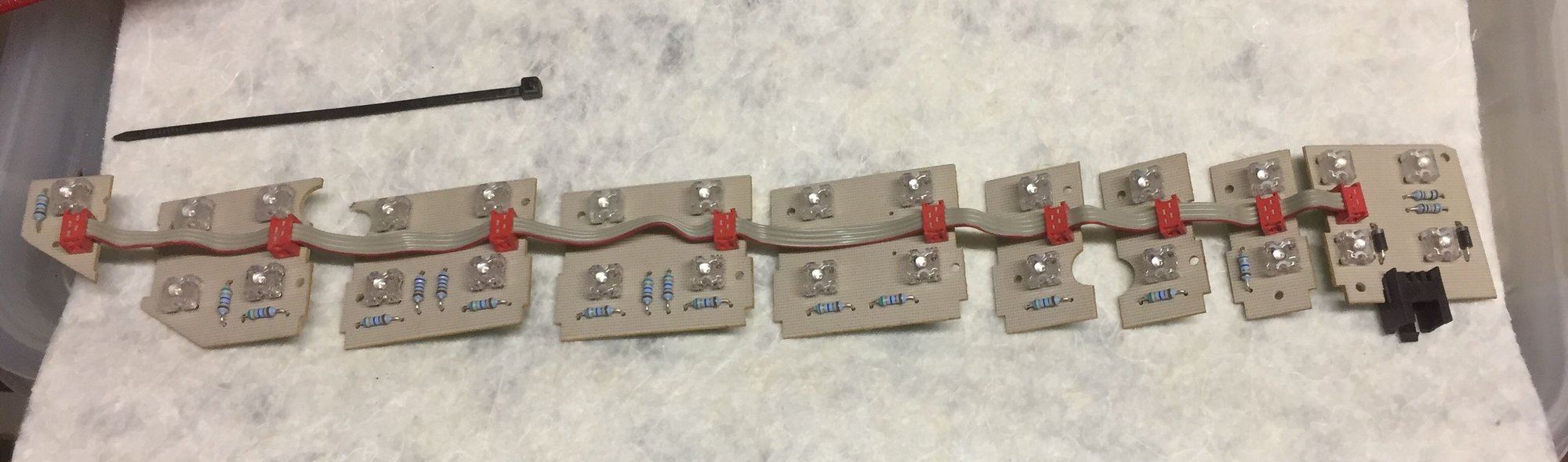

Got led strip out and this is what it looks like think 8ts knackered ?

Yes, it looks bad. But the single electronic components should be reasonably easy to replace. AFAIK MB and other sellers only sell full lamp units. Perhaps you can try your luck with buying a damaged unit.

Electrically they would work, but physically they are handed, so no they will not fit.
Just done one of mine. Really easy to repair if you can solder.

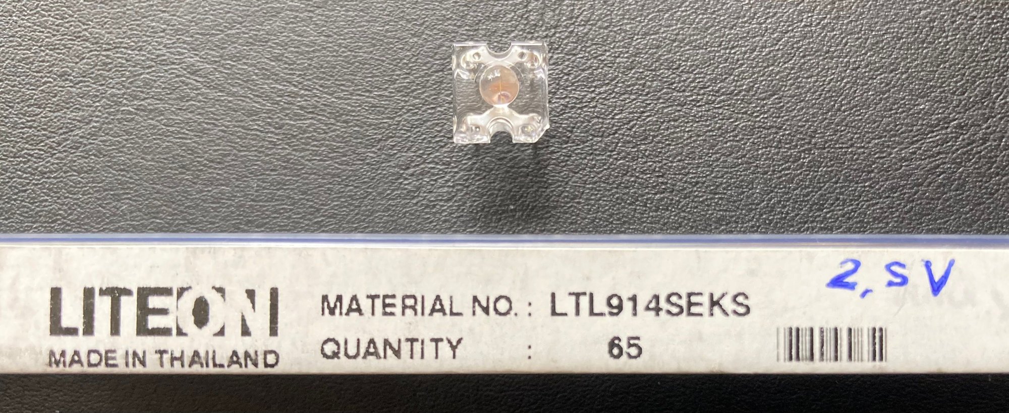

I gave you product details in #2. I can send you leds against cost price since I ordered a batch when I needed a few.
