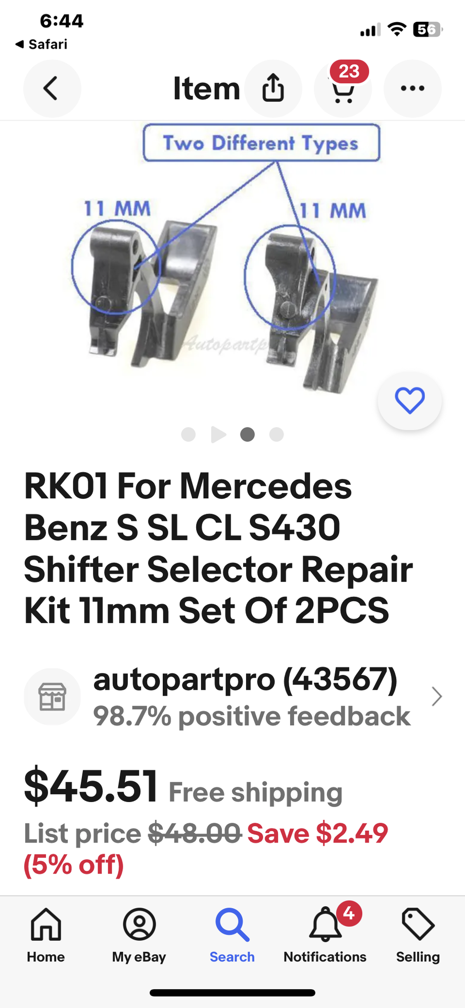

There seems to be 2 different types of aluminum products. How do you know which one is for your car thanks Gene
Gene, you don’t. When you open it, that’s when you know. This is what most of the SL guys have had luck with including myself.
I got both when I replaced mine, they came with 2 for the same price.
Do you remember who sold you both? Thanks Gene

I believe I purchased something like this, it was 10 or so years ago. Mine were aluminum.
