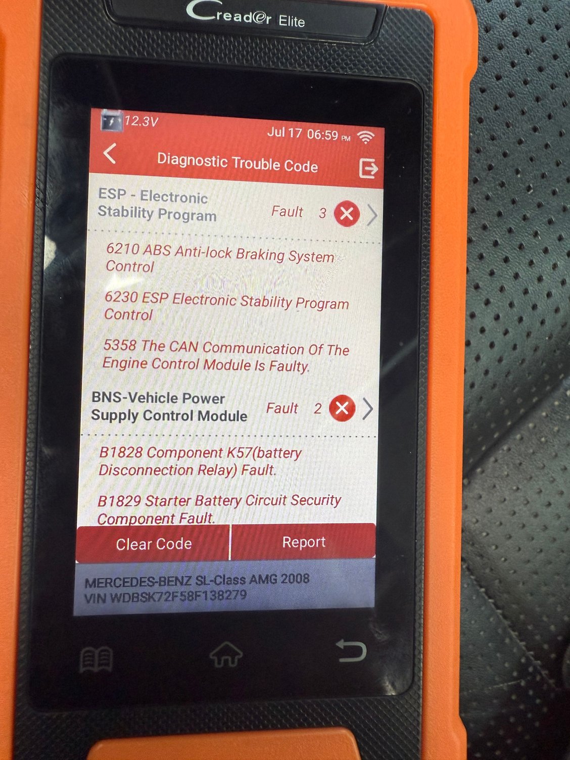

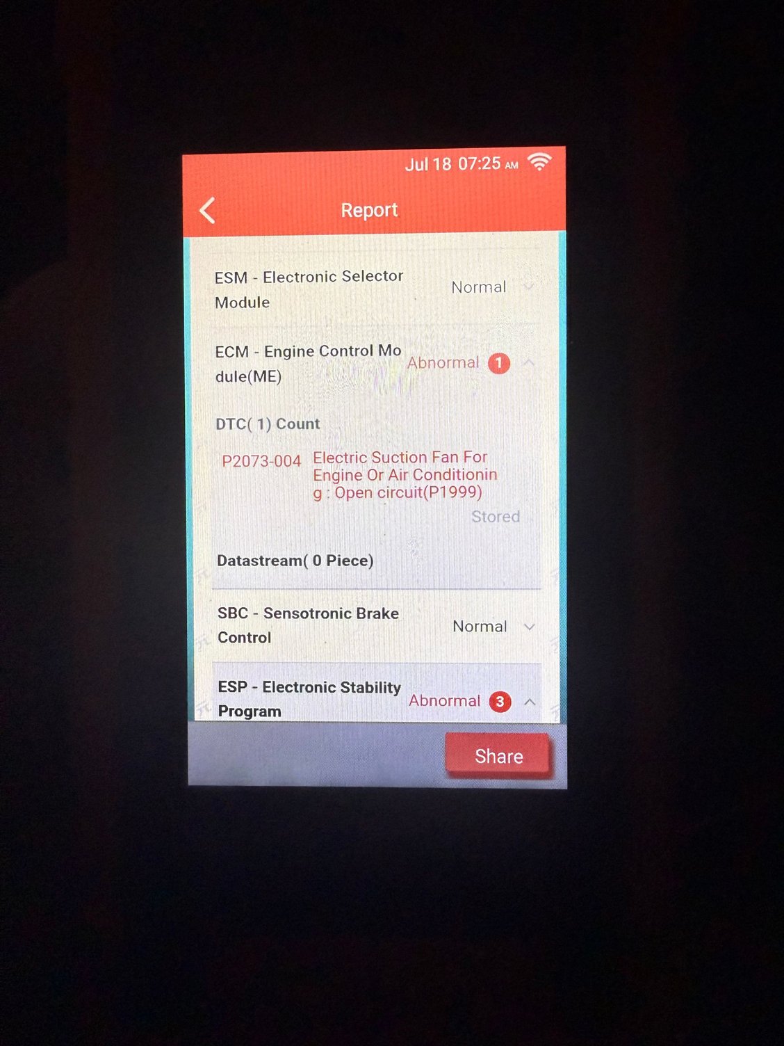

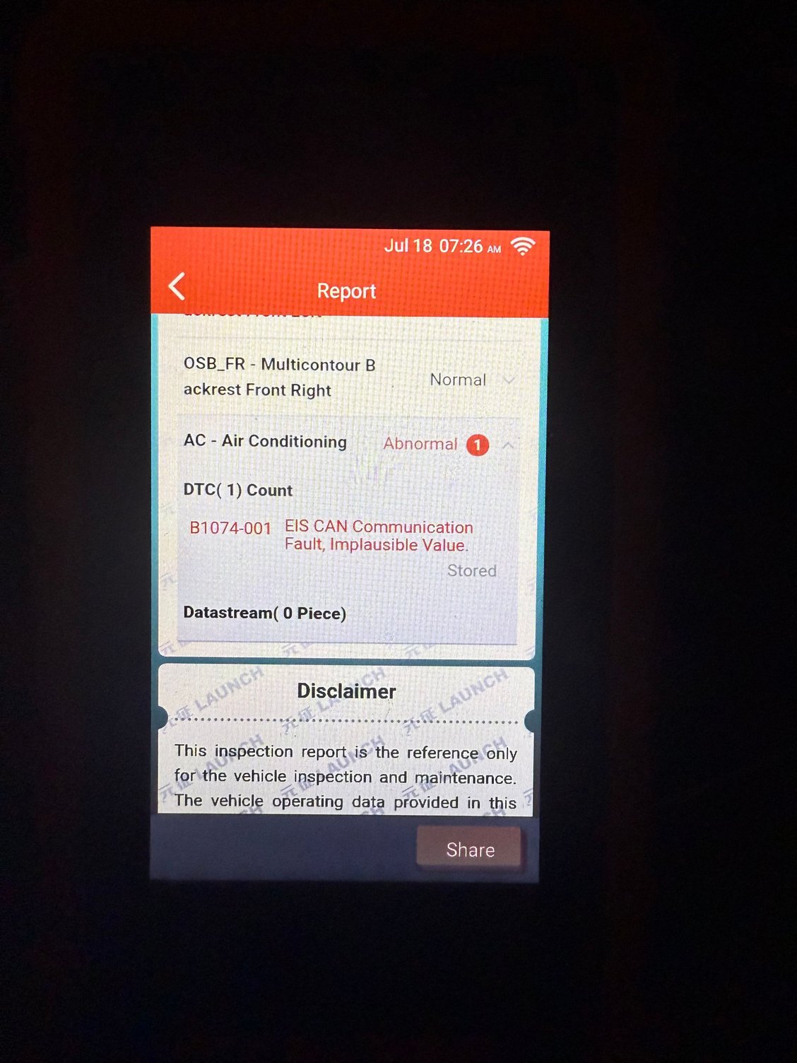

I did find I have a bad diverter actuator motor and I e also received the following codes mentioning the ac control unit is faulty . I had disconnected the cooling fan and believe that was the reason for the suction fan control code

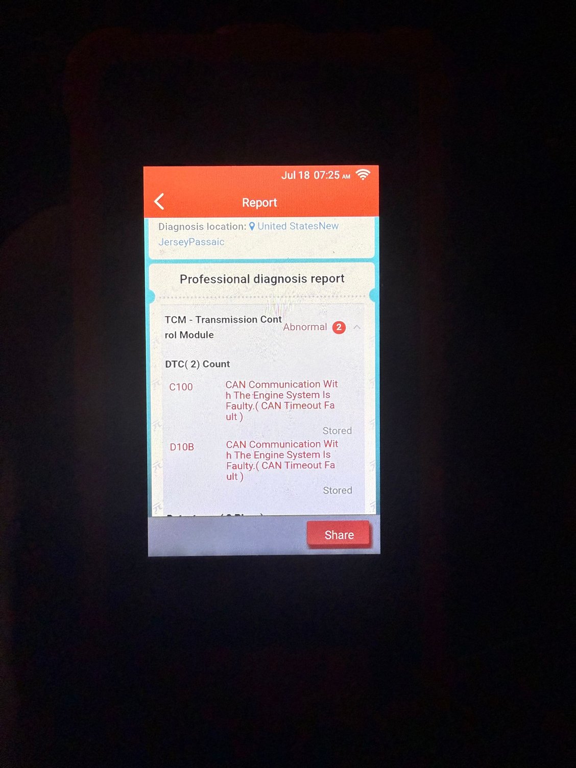

All those faults are stored, not current.
Try clearing them and re-scanning to see what returns.

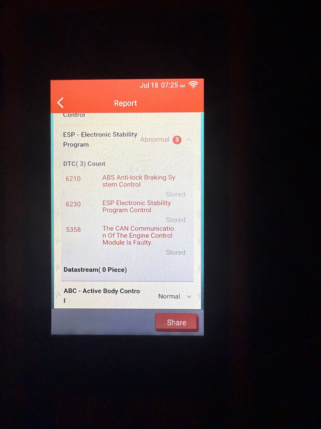

The diverter motor is definitely not ok it shows the steps being -1000 and the AC control unit keeps clearing then reappearing coming back faulty . But the following codes pictured are constant

You would really need to get it on STAR SDS diagnostics.
Not only does it give the codes and descriptions it gives guided diagnostics to narrow down the faulty component.
From what little I can see, have you checked out K57 relay (next to the BCM in the trunk)?
If I recall correctly this should be OFF most of the time, just turning on if the rear battery is a little low to enable the car to start.
