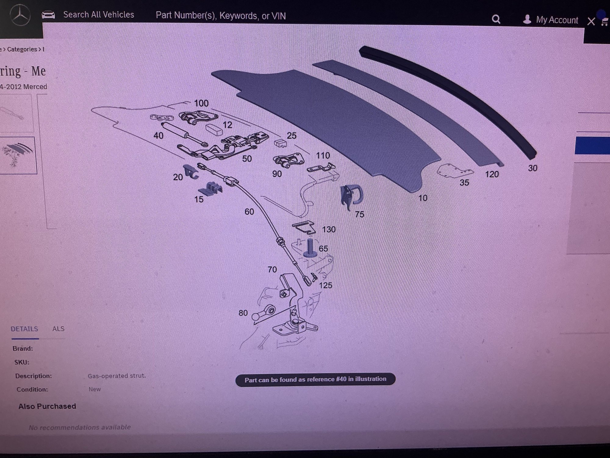

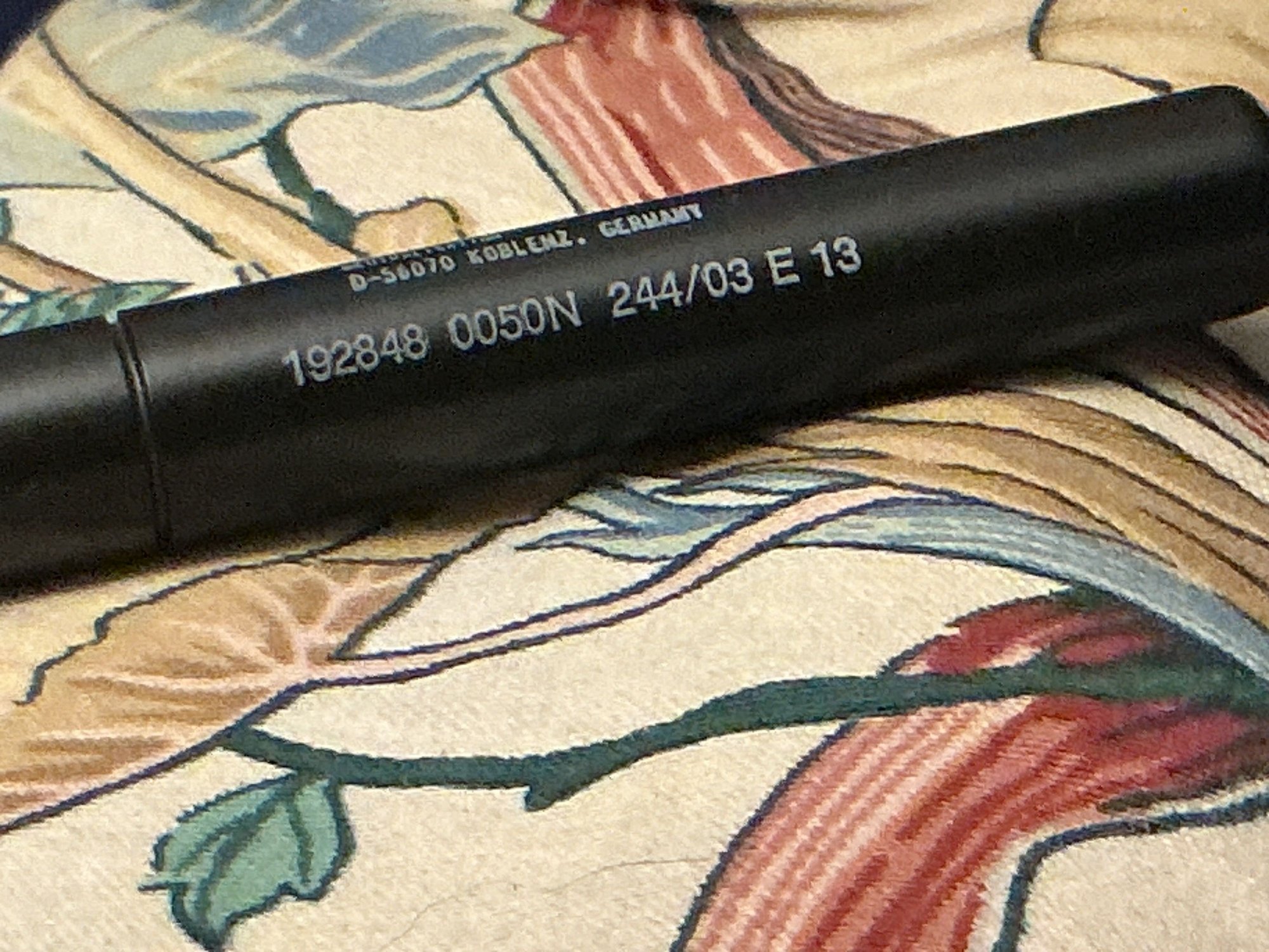

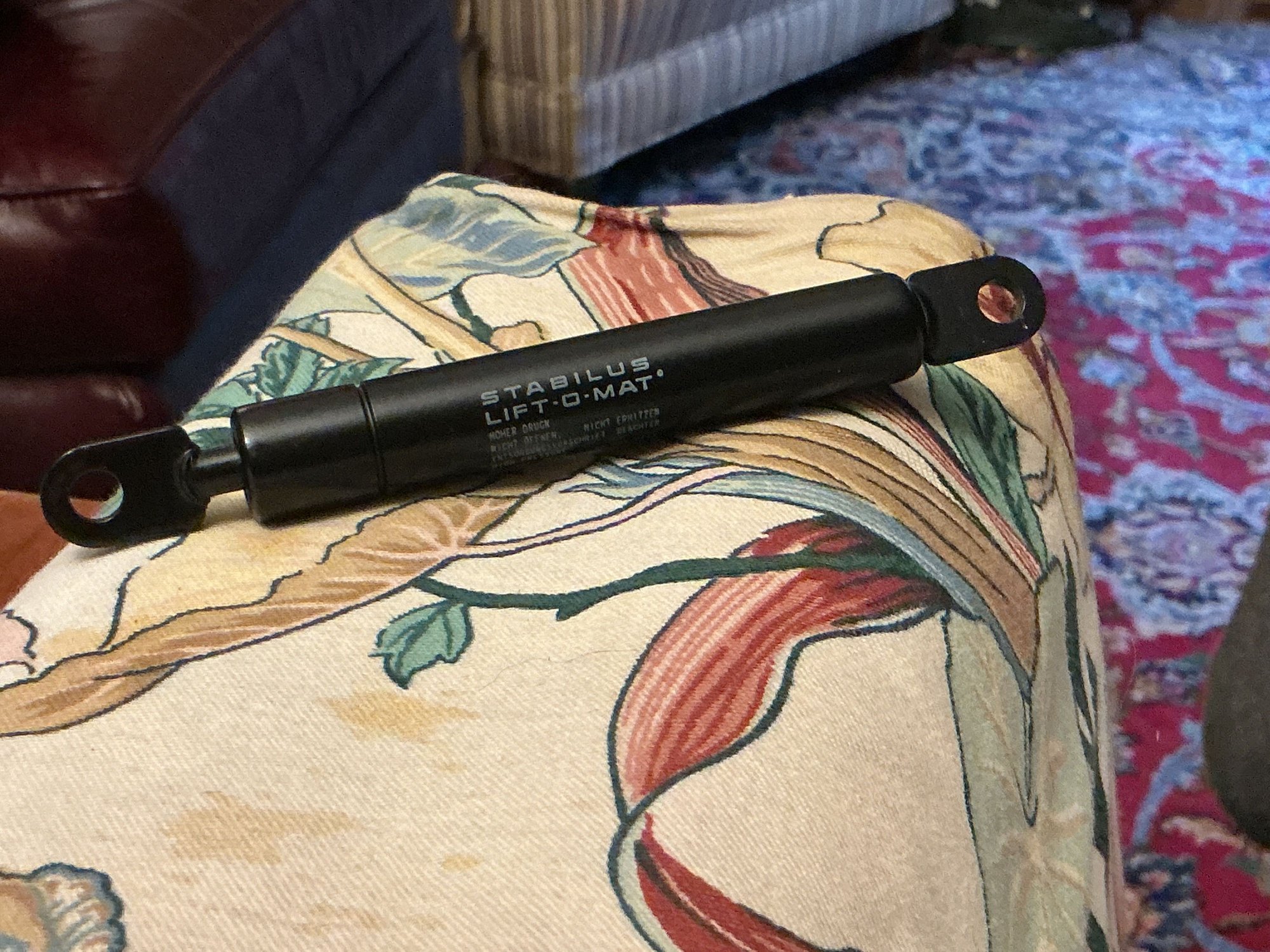

Thanks for those comments Mike. I did find a couple of aftermarket suppliers but I ended up by finding the Mercedes part number. The price is pretty compatible seeing that I have a wholesalers account with my local Mercedes-Benz shop. The number is 230–790–00–79. This is part number 40 in the attached Mercedes-Benz diagram. My price was $60 total as I do not get charged any shipping or sales tax. Doesn’t seem too bad for an official Mercedes-Benz part.
Now I have another question. When I replaced the cable I had the car in the manual raise roof mode. It allowed me good access to the cable mounting parts. But now that everything has been reinstalled with the addition of some rebuilt hydraulic cylinders the system will only work with the electronic control switch. Do you have an idea as to
what would be the best way to get at and replace this gas hydraulic lift?
Part number 40 in this diagram is Mercedes parts number 230–790–00–79

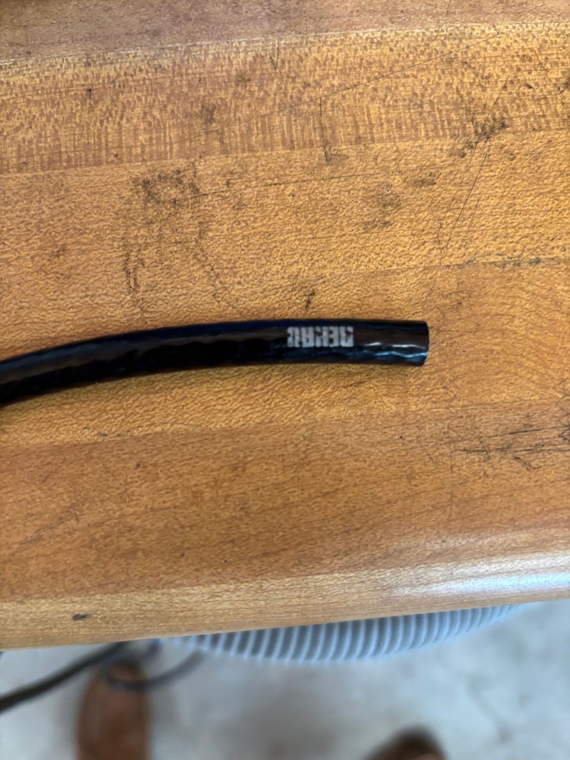

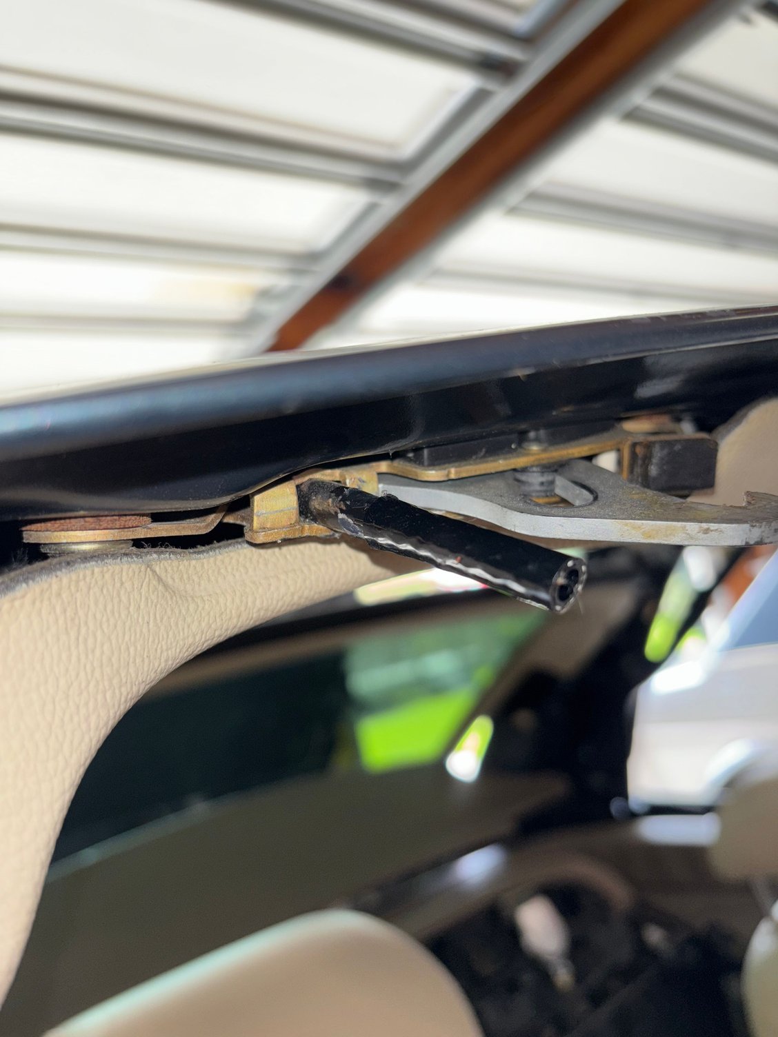

Thanks for joining in. My comment would be that people need to decide if they want to replace the cylinders individually or in groups or if they just want to do the whole thing at one time. I chose the former and I don’t know if I made the right choice. My car is a 2004 so it is 21 years old. Sometimes when you have one cylinder rebuilt the increased pressure at the other cylinders is just too much and then those start leaking. As of right now, I have replaced eight of the 11 cylinders. Part of me says go ahead and replace the other three but as it is working I’m hesitant to do that. I would suggest adding a few ounces of AT-205 seal re-conditioner to your fluid. It has the highest reported reviews for helping old gaskets maintain their seals. I did this with mine. I have used this product successfully in my 1951 Buick Roadmaster for years which has constant problems with the transmission to axle tube seals.
The “cable” only needed replacing because I kept manually opening and closing the roof. That package shelf flap would get hung up and the tension caused that cable to fail. Also, when you manually open and close the roof you often times break the two little pegs that help align the forward aspect of the edge into the a pillar. When the car does this on its own it does a better job of alignment. You cannot just buy those replacement pegs. I had someone 3-D print them for me but they just didn’t hold up. Believe it or not, I replaced them with some thread enhanced black tubing that has some flexibility. This seems to give a little hoses a bit of flexibility while those pegs go into the a pillar. That seems to make a lot of difference to me. If you look back in this thread you can see the pictures of those flexible thread enforced hoses. By the way, in my opinion, those black pegs don’t do much for the alignment process. The alignment process is mainly accomplished with the hooks that lock the roof into the a pillar. But that peg on the right is needed to close the micro switch.
I am including the pictures of that flexible hose and how I have it fitted. It has been suggested that maybe I could get those printed in a more nylon based polymer. But I kind of like the way these work.
