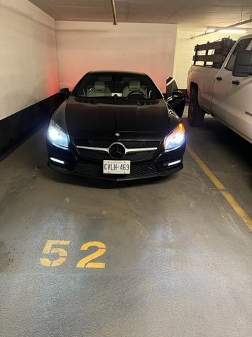

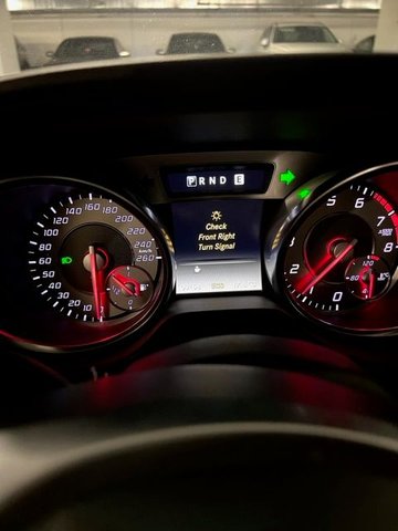

Old Apr 15, 2022 | 10:03 AM
gbmrob's Avatar
Joined: Apr 2022
Posts: 6
2013 sl550
Thank you for the response.
The VIN is WDDJK7DA4DF003065
It's a '13 SL550
I've attached a few photo's for your reference.
Do you think it's #400 or #170 for right headlight?

Originally Posted by gbmrob
.#170 for right headlight?
Those are Bi-Xenon #170 is correct, but I would confirm with your old part # (there appear to be a couple versions). AND make sure that’s actually your issue. In that picture, it appears as if your lens is cloudy. As if there was moisture or water ingress in the headlight. It may have damaged the LED light bar within the headlight itself if this is the case.
Good Luck.
Old Apr 15, 2022 | 08:45 PM
gbmrob's Avatar
Joined: Apr 2022
Posts: 6
2013 sl550
Originally Posted by crconsulting
Those are Bi-Xenon #170 is correct but I would confirm your old part # (there are a couple versions) AND make sure that’s actually your issue. In that picture, it appears as if the lens is cloudy. As if there was moisture or water ingress. It may have damaged the LED light bar within the headlight itself.
Good Luck.
I ended up chatting with a few online mercedes benz part companies and they recommended this:
https://partsavatar.ca/2014-2015-min...gaAuqMEALw_wcB
you are correct about the moisture. The problem started when I visited a car wash. Initially the whole head light (the xenon blue lights) were not turning on due to moisture in the actual lens. After moisture disappeared (about a day) the lens turned on (as you can see in the photo #3) but not the right turn signal (orange lens that sits on top). It's been like that for almost a week.
Would there be another part as well I should look into?

You are correct, Bi-Xenon #170 is ordered ( https://partsavatar.ca/2014-2015-min...gaAuqMEALw_wcB )
The initial problem occurred after visiting a car wash. Built up moisture as you mentioned inside the lens (blue xenon light was not turning on), but after a day of moisture disappearing it turned on again (as you can see from photo number 3). However, the right turn signal hasn't turned on (which has been a week). Would there be another part I should order?
Old Apr 15, 2022 | 08:53 PM
crconsulting's Avatar
Joined: Feb 2021
Posts: 1,419
Likes: 739
From: Nor-Cal
2020 GLC300 -2014 Sl550 - 1997 SL600
Unfortunately, that doesn’t bode well for your headlight assembly. The LED light bar within the headlight is integrated and a non replaceable. 🙁
You would have to replace the whole assembly. ( #10)
