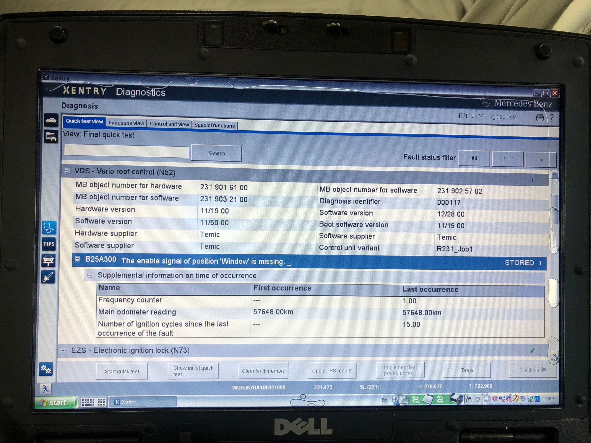

Scanning with XENTRY will reveal any stored codes for the latch. Typically it will show a hardware part number and software revision number. The micro switches in these cars will store a code. Even the speakers show up in XENTRY!
As I mentioned earlier, strange things happen to cars in the cold 🥶
Below is a an example window switch code that was stored in a car.
