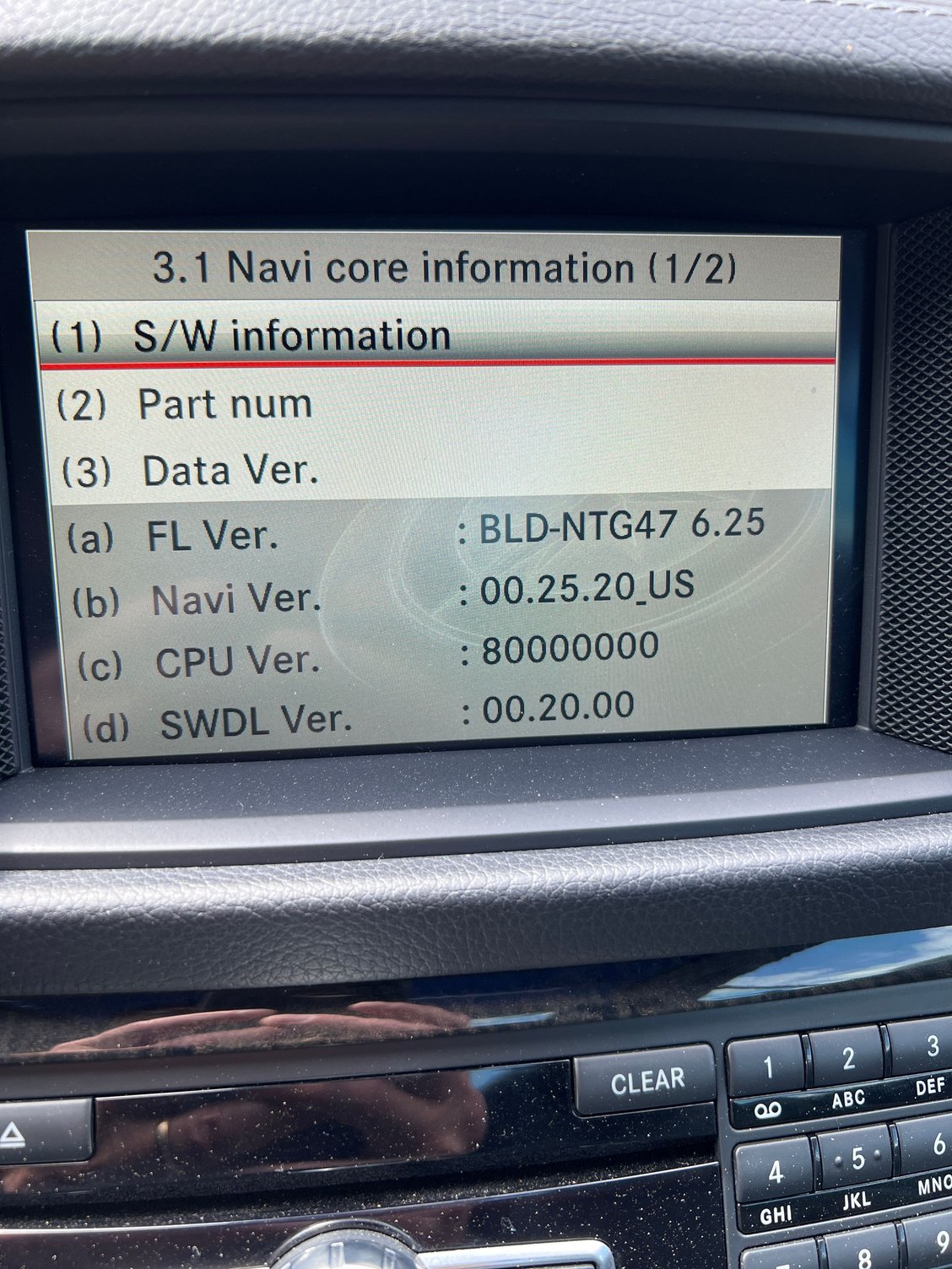

Menu 3.1 will show what version NTG you have. I have NTG4.7.

I drove my SUV today, but when I get home from work later I will check the SL to see which version I have. I watched the install video and it seemed straight forward at the start, but looked to get a little harder towards the middle/end. It is a little intimidating, because taking things apart on a car that costs as much as ours is nerve racking. I am willing to give it a try in order to get car play though...

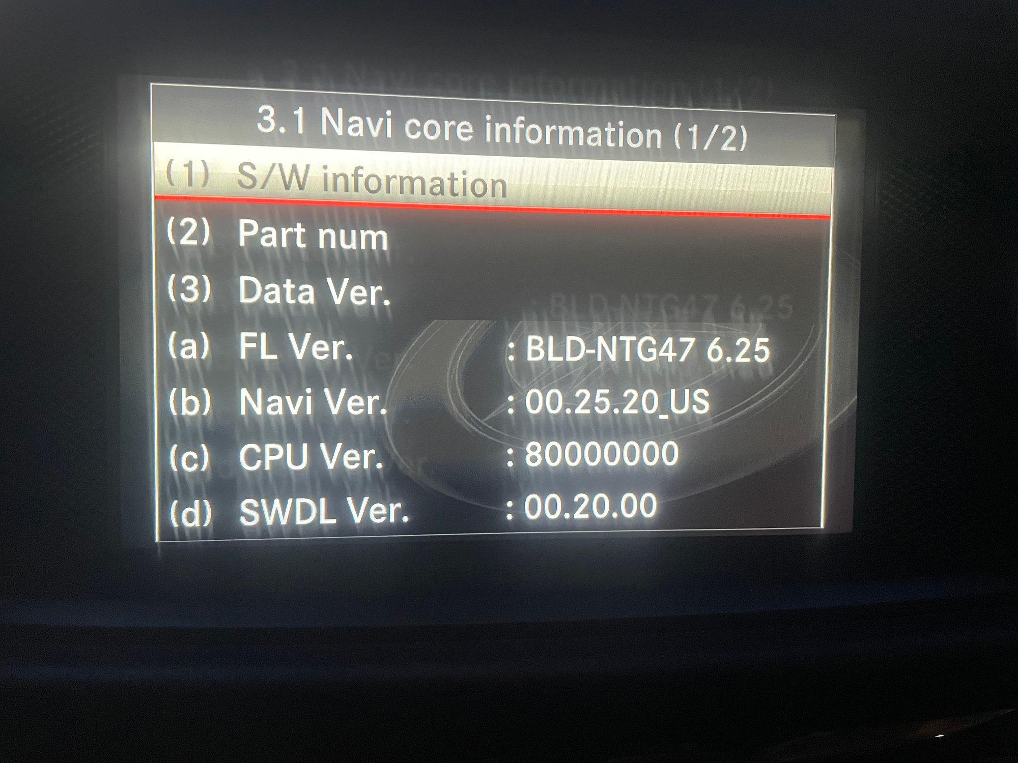

Mine

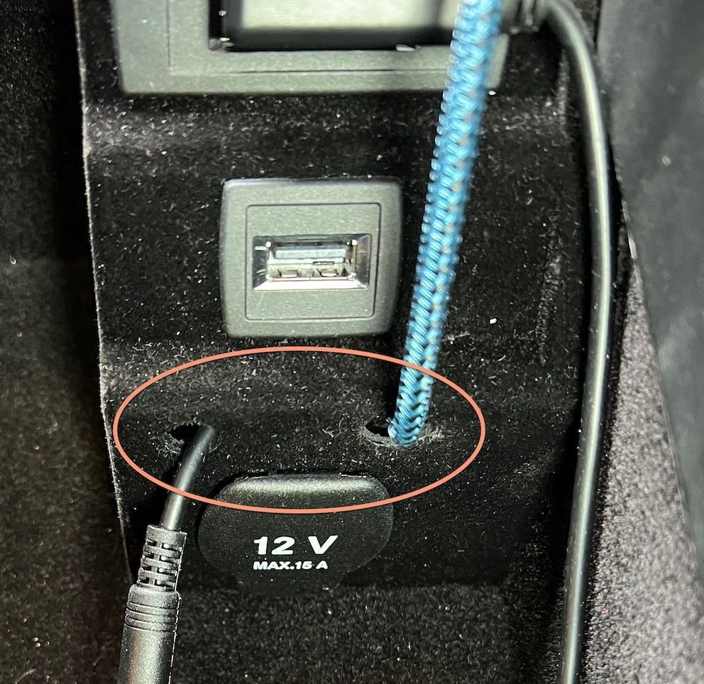

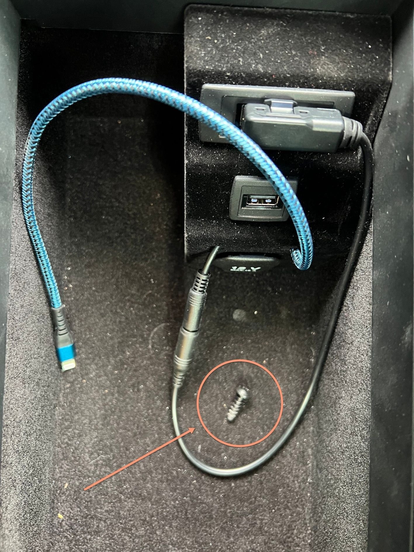

OK, here are a few pics post installation. (Believe it or not, I did try to shrink the pictures before posting them.)
Finished result. CarPlay screen.
Decoder and cable passthru. The decoder module is Velcroed to the inside of the glovebox to keep it in place.
Inside the center console showing the Aux cable and the iPhone cable. Having a leftover screw is a little disconcerting, but nothing has fallen apart yet.
A closer picture of where I drilled holes for the cables inside the center console. I did remove the console top and the connection box to drill the holes and route cables from the kit to the console. I used a 6' iPhone cable to have plenty of length.

Thanks for the images. It will probably make more sense when my kit arrives, but what is the aux cable and the phone cable for that you drilled in the center console? You don't have to have the phone hooked up to display the CarPlay do you?? I already have a splitter in the 12v thats in the console for my phone charging and to power my dash cam.

The Aux cable is definitely needed for sound through your speakers and the iPhone cable is an optional connection. The kit uses Bluetooth and/or Wi-Fi, but you can have a wired connection, too. With the iPhone cable, you can charge your phone at the same time.
