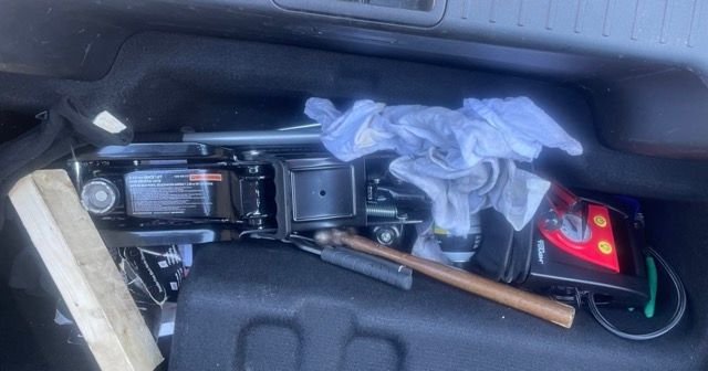

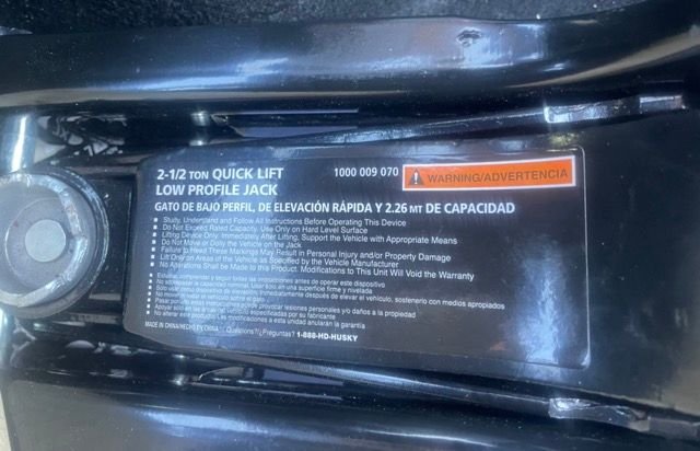

I carry a small flat jack (if the nail, etc. is in the back and I can't get to it by simply turning the steering wheel) a tire repair kit, gloves, fix a flat, lug wrench, razor blades and an electric air pump. All of this fits under the rear hatch below the lower section. I have only had one leak so far, but at least I have a chance to do the repair should a flat happen. I have AAA which gives me 6 free tows per year, as well as my own insurance that also provides free tows. (Sometimes one service takes longer than the lower, so I go with which ever can get to me first)
I am very interested as being as prepared as I can be for this. What kind of flat jack did you buy for the SL? And why would you need it? And where would you lift the car? I would be scared to jack this car up i think. I read that it can screw up the top. And -- Why a lug wrench?

If the nail is in a rear tire and I can't reach it easily by simply turning the steering wheel like on the front tires I will jack the car up to have better access to the problem area. Also if I don't feel like laying on the ground.
Under the rear hatch cover. My items fit without issue.
There are Jack points under the car, I have jacked up the car multiple times. To look around, to check for leaks and rust, to work on my calipers, etc. I have had zero issues jacking up the SL.
If I just don't feel comfortable on the ground, or am having trouble reaching something, or completing the repair, or if the weather is not great, whatever I will take the wheel off to get at the repair more easily. I am old and sometimes things hurt for no reason. Also the ground may be wet, or whatever.

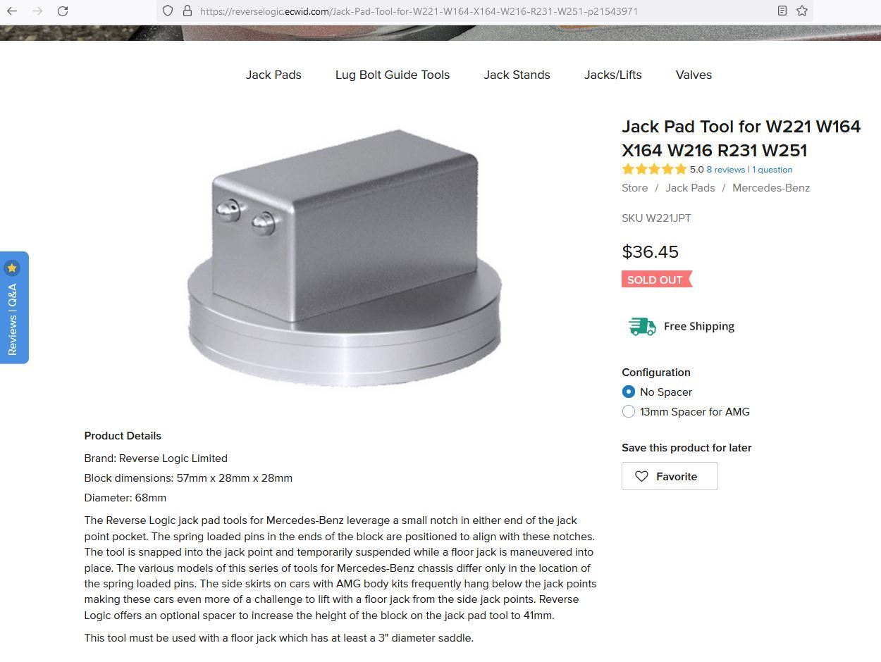

https://picclick.com/Mercedes-Benz-M...890552162.html
Will I need one of these if I get in a bind and I have to jack up a tire out in the boonies?

Jack Pad Location
Here is the location of the right rear jack point on my 2015 SL400. You can see the cutout is rectangular. Not sure if this may be different on other models.
And here is the tool I would buy if I was going to buy one.
The reason I haven't bought this tool is that the round base of the tool (3" as stated in the description) is too big for the saddle of my floor jack. Accordingly, I just use the jack as is. Unless you are going to be jacking up your vehicle on a regular basis, I would say it's OK to go without a jack pad tool. The jack pad underneath the car seems pretty sturdy for infrequent or emergency use. No matter what you decide I would definitely recommend a dry run to test your solution, including making sure you can remove the lug bolts on all your wheels.
