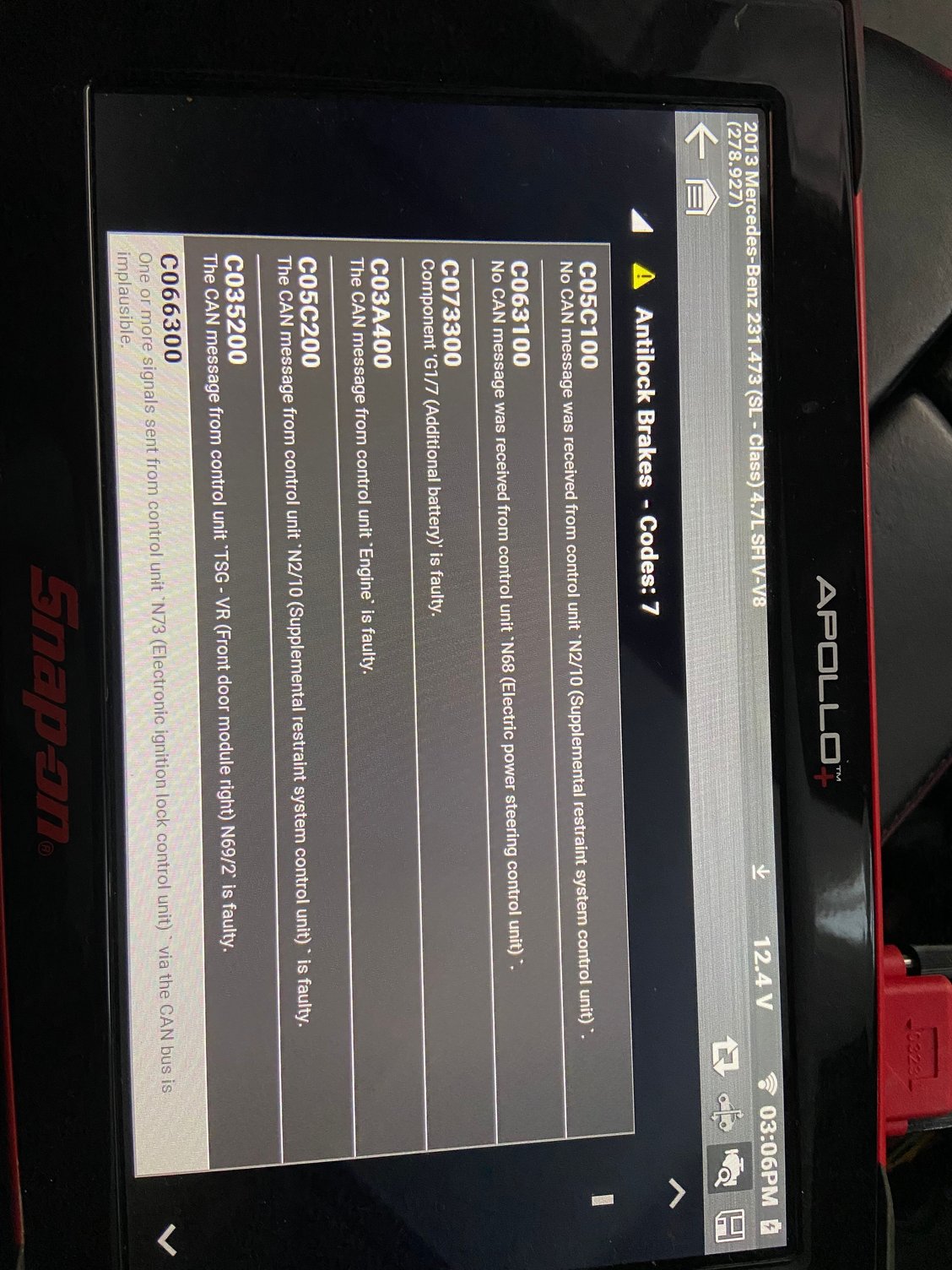

This issue of not shifting out of PARK is driving me nowhere, fast. So here’s the background I replaced the ABS/ESP Plus module, with the correct VIN coded to the module. Replaced the brake light switch 3x, installed brand new OEM wheel speed sensors all four, verified fuses, relays, brake lights. Still stuck in PARK.
So I purchased a scanner, Snap On Apollo+ (the rep told me it has relearn and adaptations but it doesn’t) but it is a decent scan tool. It communicates with all modules and shows CAN interface, confirms wheel speed sensors are working etc. It does have the ability to activate module functions as well, just can’t do SCN coding. Xentry stuff.
The brake lights are working the Hi Lo signal of the brake (S9/1) are functional.
Yet when I move the shifter to shift out of Park, I get the same message on the instrument cluster “press brake to shift from Park”.

Scan and get codes
Scan and get codes

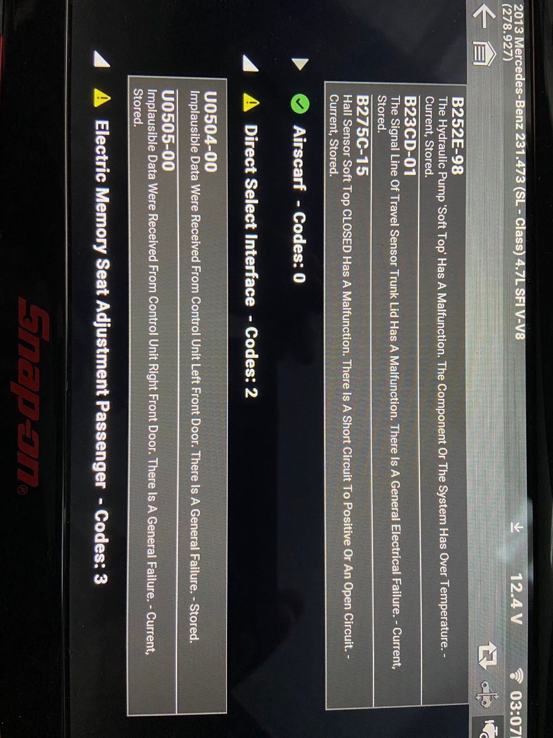

Another fault
Another fault

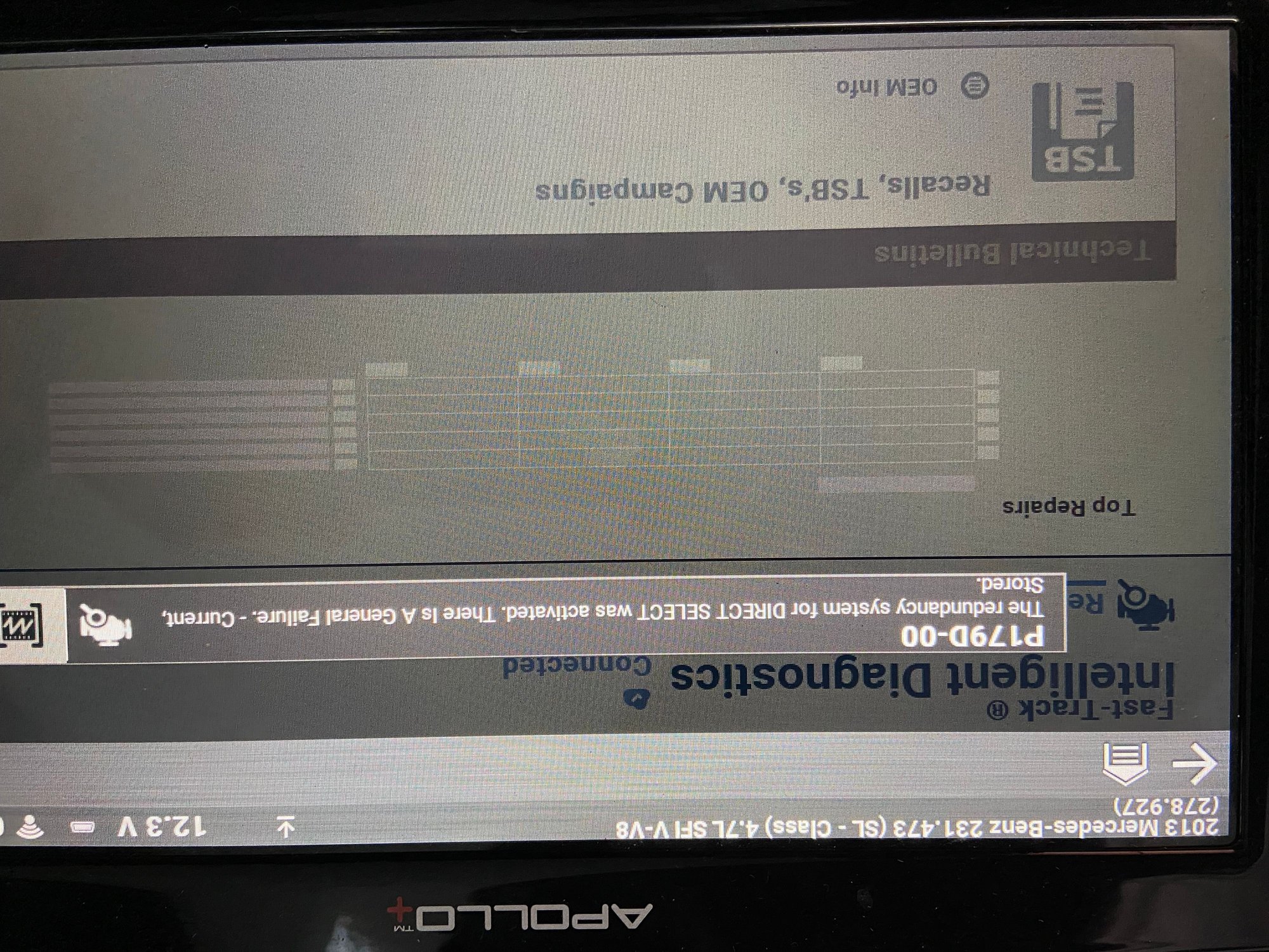

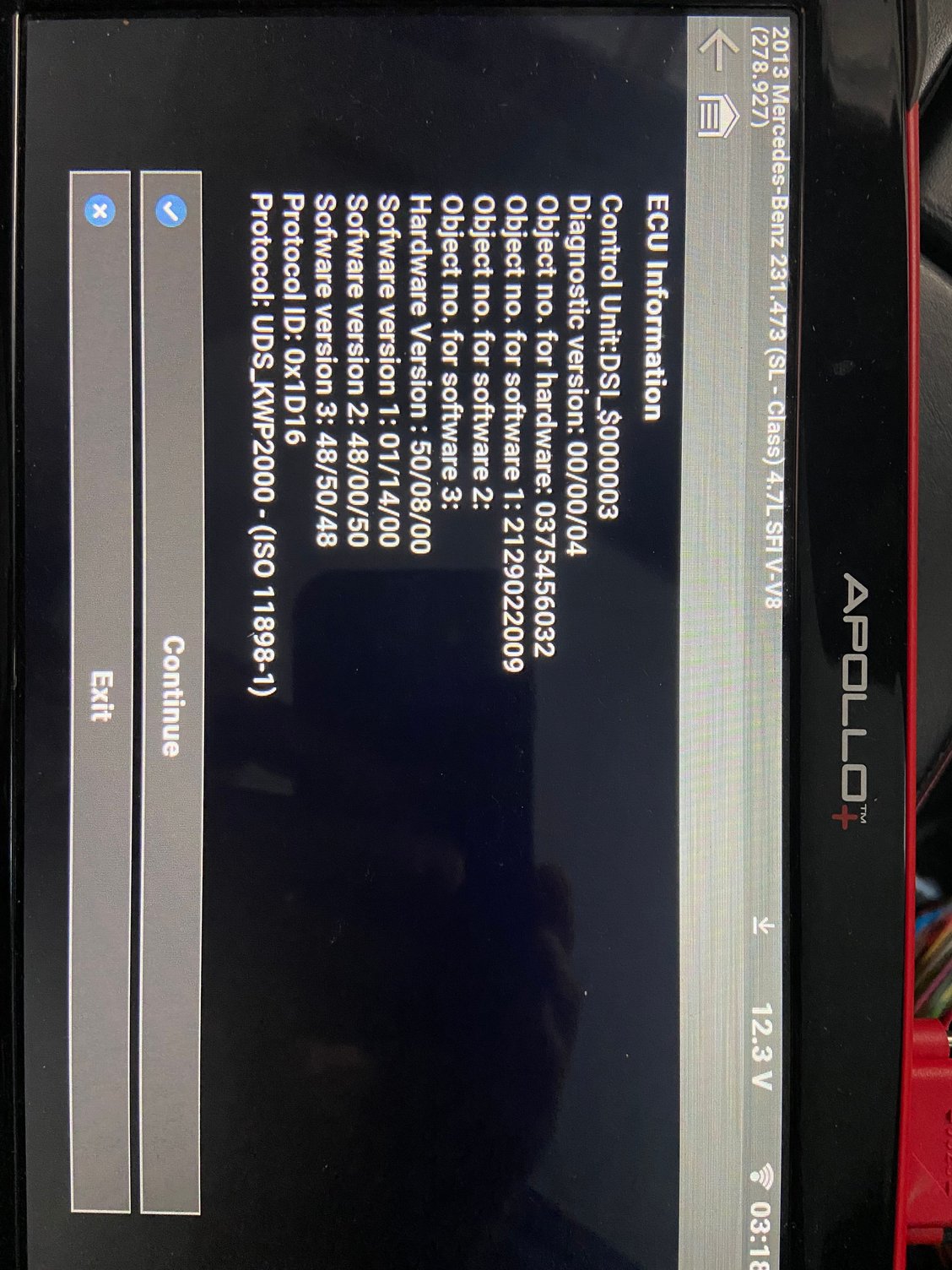

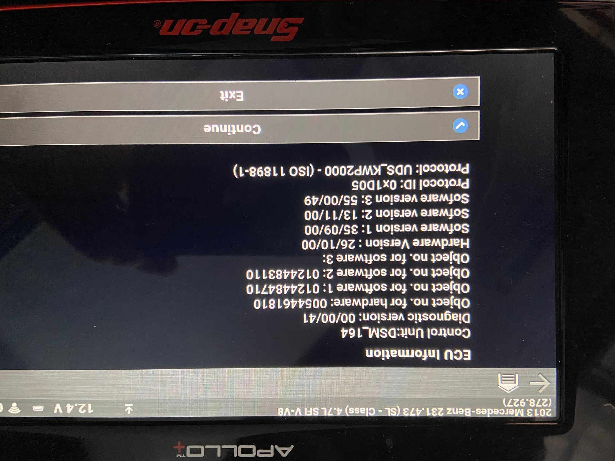

I spoke with HighTech about the problem of not shifting out of park, maybe the DSM is not communicating with the ABS module.
How, if the scan tool is showing me that both the shifter and the brake switch are active and correctly functioning when activated, does the ECU not get the signal from the SAM or chassis CAN to the Drivetrain CAN ?
