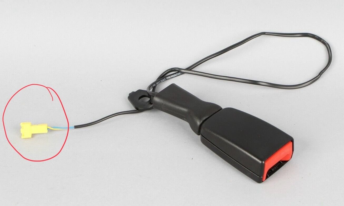

Sounds like your buckle might be an issue. Right way would be to scan it with XENTRY to confirm. I’m away so don’t have a copy of the EPC to get a part number for you, but you could probably look it up on a MB parts site like mboemparts.com
If you’re working blind without XENTRY and going to throw parts at it, I’d start there. It IS connected to the SRS system to your car. (see yellow connector)
Make sure to disconnect the battery if you do it yourself!

Broken wires in the seat belt receiver is common in the W203 and W204 platforms. (Look it up on YouTube. FCP Euro has a video on replacing the buckle receiver.) HOWEVER, you usually get the airbag light to come on and do need a scan tool (XENTRY) to reset it after repairs.
The engine stopping and starting should have nothing to do with the seat belt. So it seems like there may be other root causes. As @crconsulting said, get XENTRY or another appropriate scan tool. You're going to need it.
