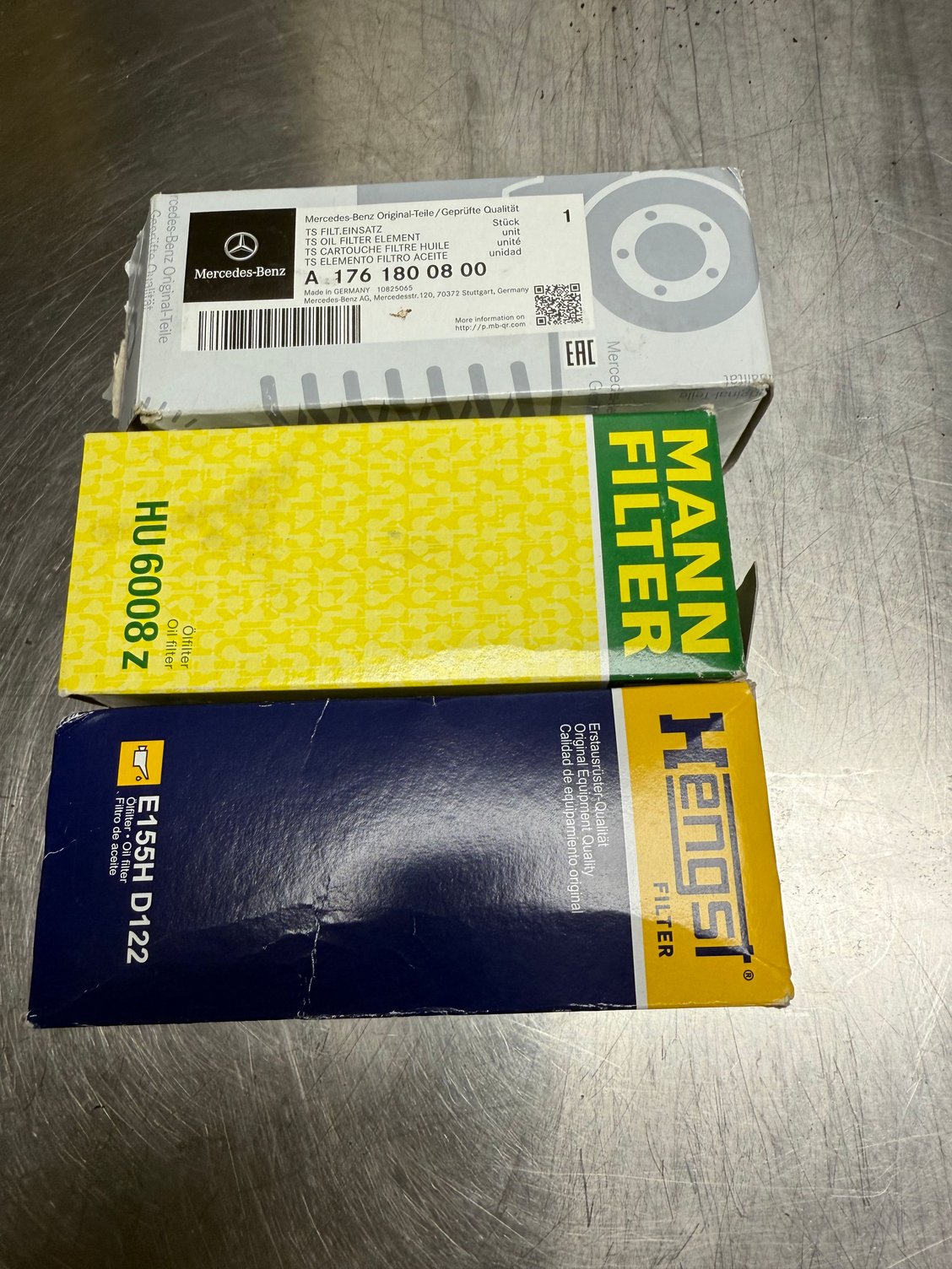

Most folks use Mobil 1 oil but MANN and Hengst are considered OEM for filters.
See below, Factory filter, MANN and Hengst.

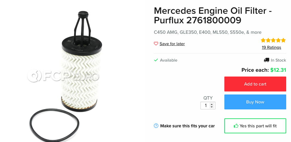

With regard to filters, I only use Purflux, which is the OE for Mercedes filters.
Welcome back…
Purflux is good too.
OP has 2013 M278, don’t believe that filter will fit
