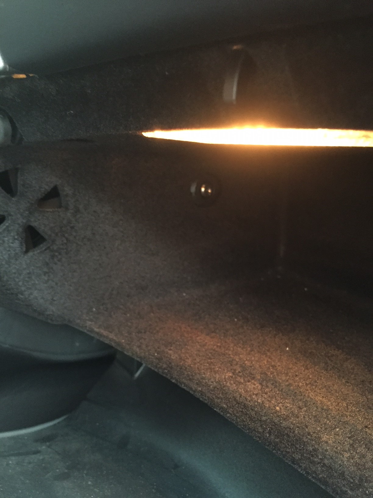

Gus, take a look at the left side panel of your glove compartment. There is an 1/8 phone jack there which you can hook to the headphone jack of your iPhone. Then choose the SVC button on your radio and select AUX.
Ok, this is the one I guess?
I just need a bluetooth recevier that I need to feed with power, then I can stream music from my telephone.
