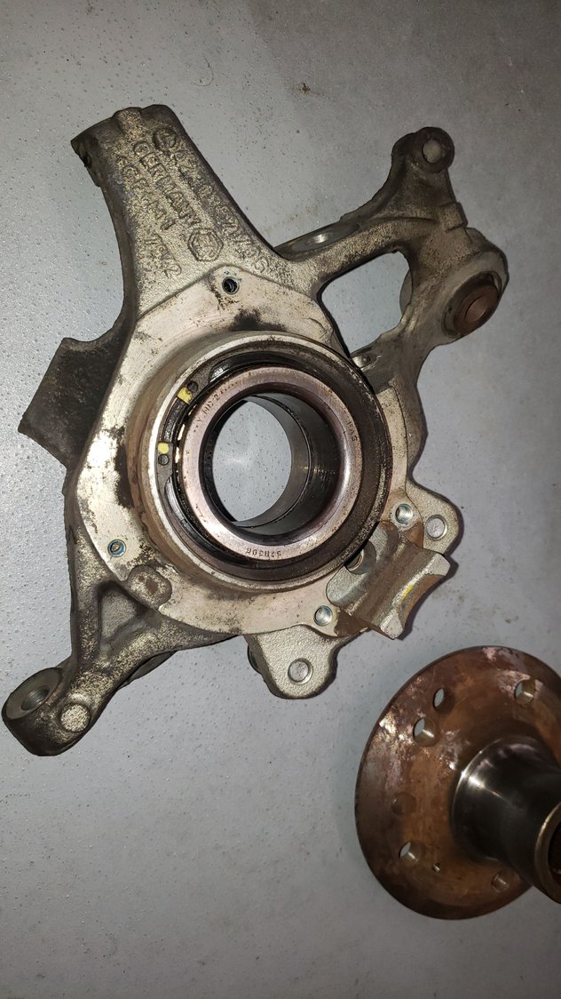

I have been going over my 2007 SL 65 from front to back refreshing a lot. When I got to the rear bearings in the wheel carriers I found out only after they were out that the *** bearings are no longer available. The Wheel carriers (at least on the 2007) had press in bearings as shown in the picture. The schematics show a beveled or slanted bearing that bolts to the wheel carrier so to do this option would require ordering the wheel carriers that accept this type of bearing but this increases the cost from maybe $250 to $300 per bearing to around $3000. The even bigger problem with this is these parts are on a hard back-order from Mercedes so it could be 6 months, 3 years or who knows when they would be available. Another option is to go with "Black" parts but then the price increases several times more than that.

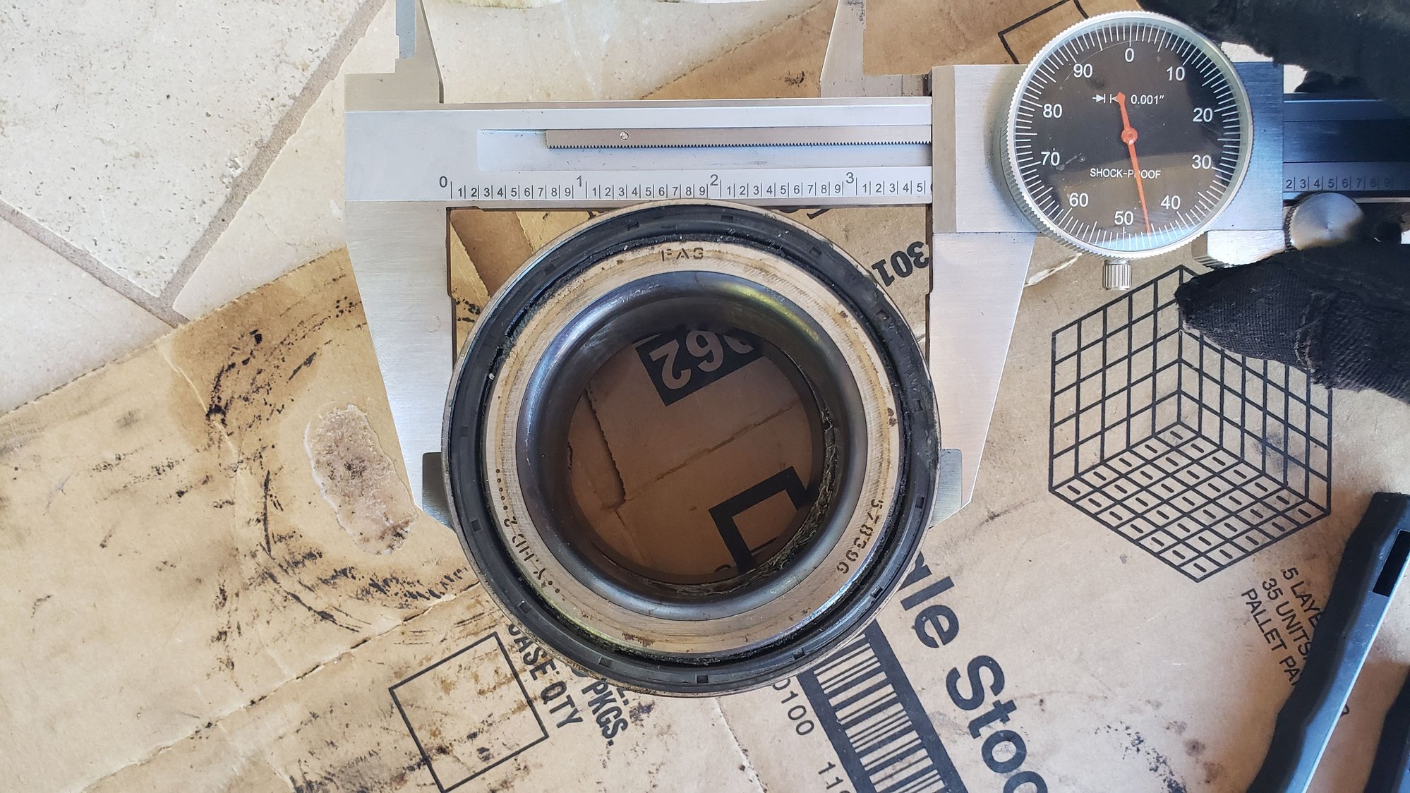

I have found bearing come in standard sizes and you should be able to find an equivalent size bearing. Try looking up the original *** part number to get the correct size. Alternatively take the bearing to driveshaft shop or some industrial gear box rebuilder and they could probably find something.
BALL BEARINGS SIZE CHART - MROSupply.com example bearing size standards.

I think this is the size you need.
Bearing 578396A (***) | Size and Specification | Bearings Online Catalogue (bearingsize.info)

The axle cv boots were falling apart and dealing with significant corrosion & rust issues. Needed to use a torch as a last resort and never considered the bearings would not be available, hence the warning to everyone. Also, another warning the wheel hubs are no longer available. These had a lot of pitting but we glass beaded blasted them and then sent them off for salt bath nitriting so rust will not be an issue going forward.

After some amazing help from people at Pelican and *** we found SKF has a replacement bearing # GRW396 and Timken has one # WB000063. I hope this helps someone in the future.
